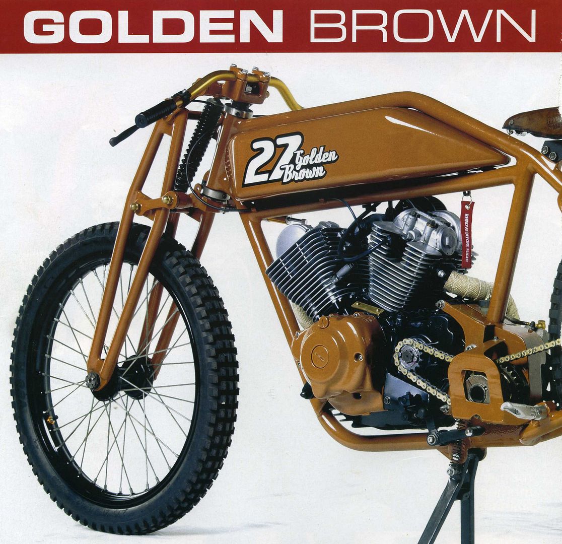

Got a guy from england who lives around the corner and he mess's with well older Triumph's, he has a brand new Robins egg blue 850 super I believe and it is beautiful, I've never talked to him just driven by when I leave the house and his drive is full of those Triumph's,one day I'll stop and talk to him.
By the way nice job I like it!
I'd also like to see more about this golden brown bike as well can you get more pic's and info about it? sorry DD I love your bike so don't feel like we're traders, did you ever come up with a decal decision for the big X ?
Hi Guys....Good to see someone else has usd the XV250 motor.....looks a treat....this motor is also available in 125cc in Britain and Europe .... same outside dimensions...DD
