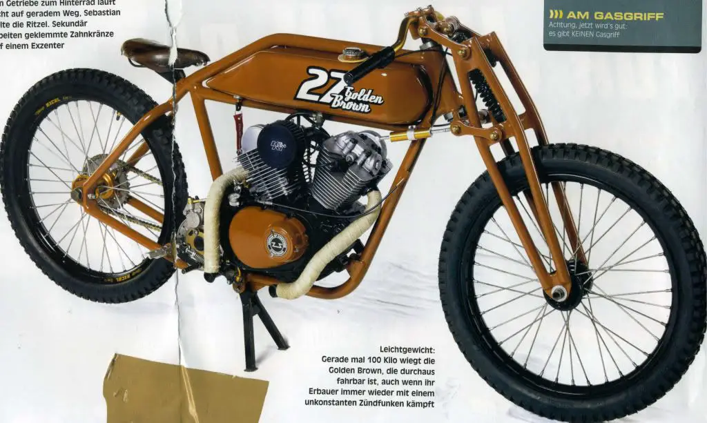

Damn that is a nice bike! Have you got a link or more pictures as I'd love to check it out a little better?
Truckd, Culver, Harry - It appeared in a German magazine "Custombike" - which I now subscribe to.
I'll scan some more pix and post in due course. My Photobucket account has been playing up the past few days - need to resolve that.
What is more amazing is that the builder is only in his 20's and built it for under 1000 euros !
This German mag. covers all genres of "Specials" - Cafe Racers, Bobbers, Cruisers, Boardtrackers, ....................., and oh yes, my German is nicht gut !

Rather than highjack your thread I'll post other "inspirational" pix over on my cafe Creme build thread. However as requested here's another of "Golden Brown".
As I'm - shall we say - generously proportioned [ big boned my Mum used to say ] - a bike of this size which would normally give the Gorilla on a pit bike image if I were to build one. However, that probably equates proportionally to a less "big boned" person on a bicycle with an engine styled Boardtracker !
