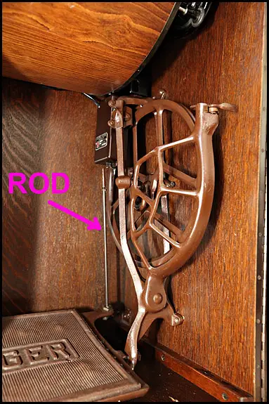

I remember my grandmother's Singer sewing machine, it had a lever to guide the belt off the wheel, whether or not it could guide it back on, I do not know.
That sounds worthy of investigation. The issue being, How does one keep the
belt from flopping around between the wheel & the stays? I've used zip ties to
that end, but it's not really a satisfactory solution.
The treadle wheel was enclosed on the one side by a cast iron cage. From memory, there was a dismounting notch in the wheel as well, to allow the belt to move sideways when required.
