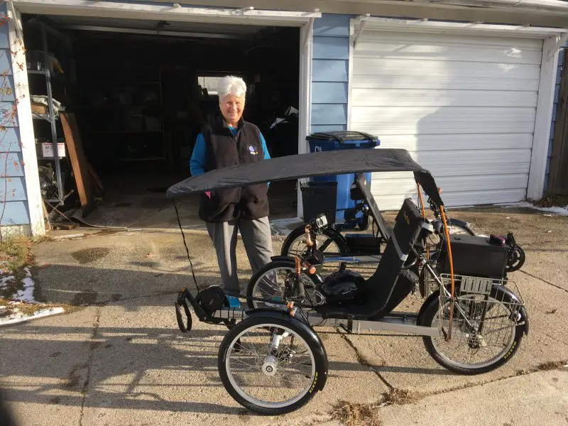

So there’s a picture below which shows two Rovers in their current state of development, looking a good bit different now than when work started on them this fall. One is for me and the other for my partner in crime Sue. They are close to being done and have proven to be a whole lot of fun. But I’m getting ahead of myself and need to back up, which is the purpose of this thread and long introduction. I had never before ridden a recumbent and had no experience with a mid drive electric motor. Never even considered making my own lithium batteries. I invite you to join me in recounting this elder adventure. Who knows? You might decide to get your own tadpole when you grow up and come along for a ride… woohoo!

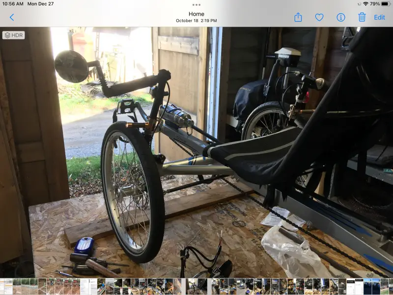

I’m back and unsure of where to begin. I think what most prompted this project was actually the completion of an amazing bike trail passing by our summer cabin At Eagles Nest Lake near Ely Minnesota just south of the Canadian border.The trail ends at Ely and passes through the Superior National Forest going south for a total of around 130 miles. At our end the landscape is a wonder, passing by clear water lakes and a wilderness forest teeming with wildlife from Moose and white tailed deer to timber wolves black bears and lynx… a long list of north country animals call our forest home. We are the invasive species in their domain. So, it is special and passes by lakes I have never seen before in spite of over 7 decades of exposure. Our section of the trail was just finished and if I want to see this new to me woodland I’ll need to bike it. And no gas bikes permitted. But electric are! So that was what started all this. The new trail is 10 feet wide and paved and in the photo below runs next to the road near our cabin

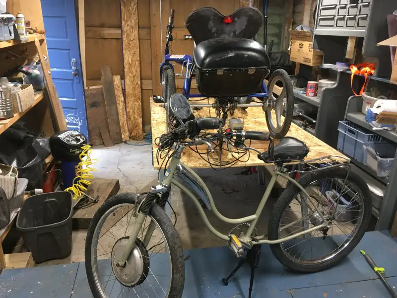

I looked around at my gas bikes stowed away, some more or less in running order and a couple others abandoned mid stream. What would be a good candidate? And what do I know about electric bikes? Just about nothing, although I had fooled around with a 36V Golden Motor which had the motor as the hub in the front wheel. It was interesting, but lugging 3 12 volt lead acid batteries around on the rear rack was not so cool as the balance with all that weight high up was precarious. I put it away. But now they have these lithium batteries which are lots lighter, so that wheel and electronics got dusted off. I also had another promising candidate which had been given to me by Sue’s brother… a 1980’s electric assist recumbent quadricycle with derailleur gearing. I’d never ridden a recumbent and also never used a derailleur, so while four wheels had appeal I was reluctant. It had a 24 volt brushed motor and utilized two 12 volt lead acid batteries. I figured I could use the light lithium batteries instead.
My partner Sue got interested and called dibs on the quad. Okay, I’d use the hub motor on a step through frame.
And when Sue’s sister got wind of what we were planning to do she offered her retired Terratrike Rover tadpole if we’d pay the shipping. You bet we would!
It was dismantled by a bike shop in Florida and shipped Fedex. And in short order Sue’s brother in law followed suit and offered us his retired Rover which was then shipped north to us. The quad and step through got put on the back burner and now we had two used Rovers to play with! Now all I had to do was reassemble them and convert them to electric assist. That’s all. All I needed to do was learn how…

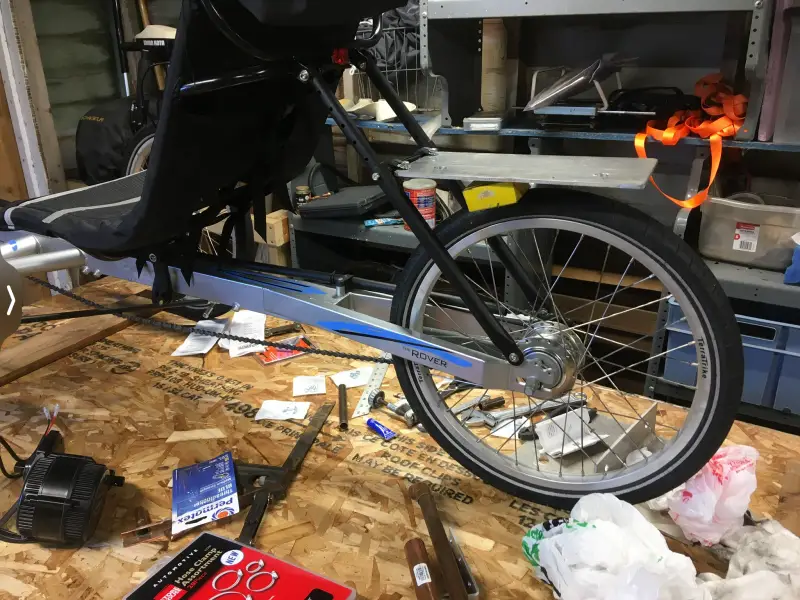

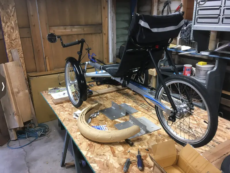

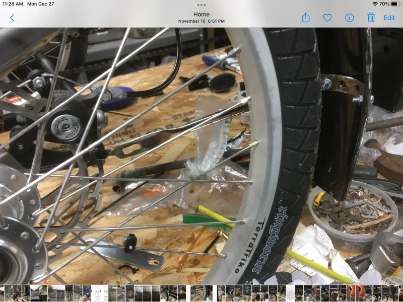

When Sue’s tadpole arrived in a regular bike box it took some ”creative staring” to get it put back together. The only damage in transit was one of the disc brake rotors being bent. Disc brakes are something else new to me and I tried to straighten it out without success. Finding a replacement on line and doing a little disc brake research remedied the situation and now I know about mechanical disc brakes. Easy peasy. This was the time to do a lot of looking and imagining. I knew it was going to have an electric motor and asked my friend Steve what he suggested and also spent some time wandering around in cyberspace… and eventually settled on a mid drive electric motor which replaces the pedals, pedal cranks and bottom bracket assembly with the kit motor and cranks. You use your own pedals. I found good reviews and the best price for what I wanted was with a 750 watt Bafang kit which we purchased through Luna cycles out of California. The kit is Chinese, of course. More on that later. I had to figure out where the battery was going to go and knew I wanted a rear rack of some sort for transporting things and preferred fenders. Hmmm…and more hmmm…a cup of coffee…a can of beer….hmmm…. I purchased some new old stock 20” fenders without braces. Nice heavy metal black Wald fenders from a bike shop going out of business. Three sets in a bundle and I purchased two bundles, enough for both trikes and some rear fenders to repurpose on the quad later on. I had no idea how they were going to be mounted so set one in place on the wheel and did some more staring to see if the trike would tell me what to do.
It didn’t have much to say at that point and it knew that this was going to be a problem to be pondered again and again. Walking away is good. Sometimes the answer comes in the middle of the night while one should be sleeping or it comes in stages… or not at all. In the meantime it gets moved to the back burner and another part of the build gets attention. I had some plate aluminum from a boat dock which my brother and I made from recycled high school bleachers offered at auction by a local township. But that’s another story. A fresh look at some of the leftovers suggested using aluminum plate for the rear rack. The trike uses something like seat stays for setting the recline/upright position and has holes on each stay for setting it. I used all thread rod to go from one side to the other with locknuts and ran the rod through a section of old copper water pipe painted black to match the rest of the seat support. Then connected the plate to the rod with rubber insulated clamps I guess you call them which I purchased at Harbor Freight… these clamps have been useful elsewhere on the build and economical, don’t scratch or make noise. So now the plate is attached at the seat stays, but needs something underneath to support it. At this point I didn’t know what that would be, but I was please with the rack itself. I’d figure something out.

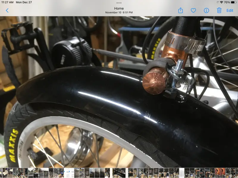

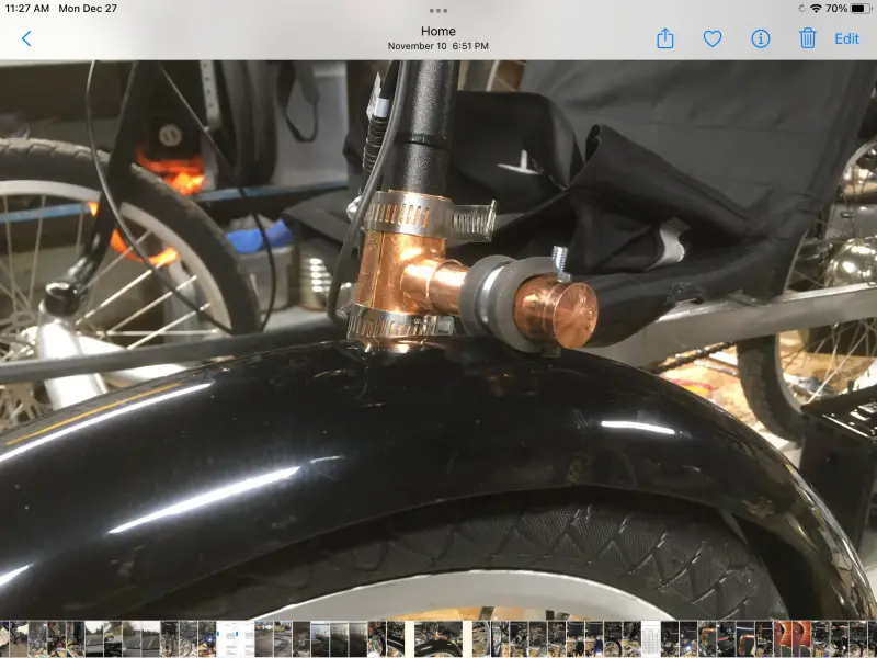

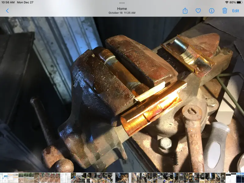

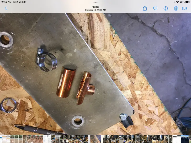

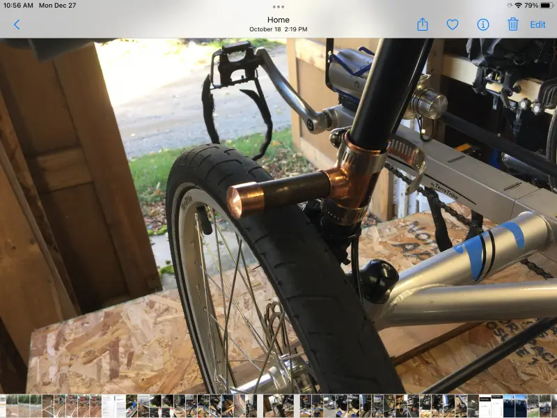

Further pondering on how to mount the front fenders led to part of the solution. On a two wheeler it would be held from above by a bolt going into the front fork. On the trike there is no front fork so something else would need to do the lift. The vertical handlebar was the only thing available, but was both on an angle and offset to the side. I’d need something to bridge the gap. I looked through my trove of stuff and took a second look at a copper water pipe fitting which was a T reducer from 3/4” to 1/2” (or was it to 3/8”…I’ll check later). I put the reducer T into the vice and used my side grinder with a cutting wheel to slice it in two. A hack saw would also work. Then clean up the cut with a file.
Using hose clamps the sliced 3/4 part of the T sandwiches the upright handlebar so the reduced part of the T sticks out over the wheel.
So now I have something to attach the fender to from above. Not sure yet how to make the attachment, but making progress.

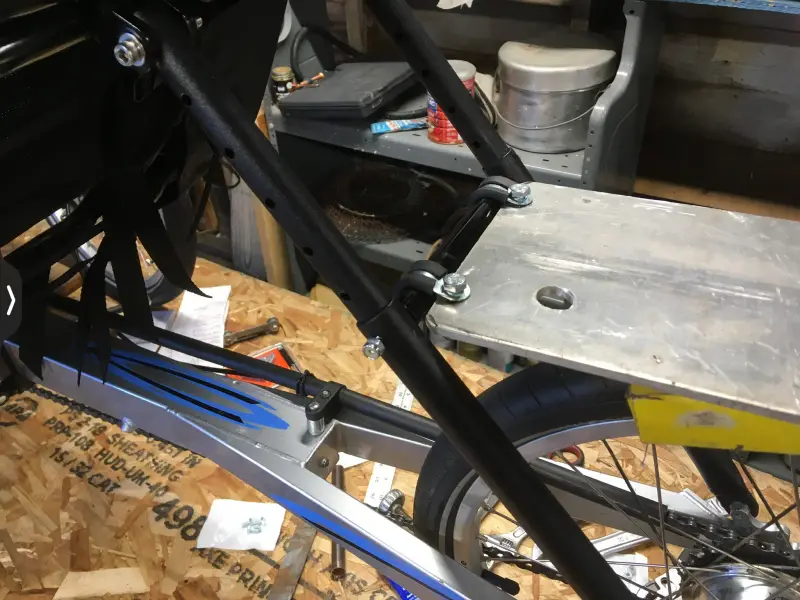

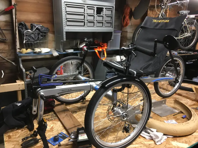

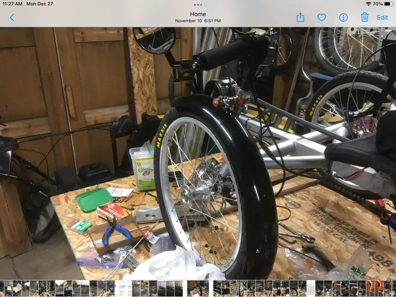

I was working on both trikes on the work table at the same time so the one above is my trike and is a little further along than Sue’s. The connection between fender and T fitting is with one of those rubber cushioned clamps which I think are used in electrical work. The bolt has a rubber washer where the clamp contacts the fender. Nylock nut on the upper side
Now the fender is securely lifted, but the bolt also provides a pivot point so something is needed at the lower rear part of the fender to hold it steady. On a two wheeler the fender bracket would attach to each end of the wheel axle. But this is a trike and on the outside the axle is recessed and on the inside there is no bolt to thread a nut to. So, I cut off half of the fender bracket and went to the inside of the wheel searching for an attachment point.
I found it at the front wheels steering connecting rod. After cutting the fender bracket to length I flattened it with a hammer and then bent it 45 degrees, then drilled a hole for the bolt to pass through. Not great, but better than nothing. It is not as secure as it would be on a two wheeler, but doesn’t rattle and will stay in place. Ignor the extra hole in the bracket above. It was the first attempt and a second version followed.
I’m not entirely happy with the rear support, but for now I’ll move on to other things and keep thinking about it. Maybe something better will present itself.
