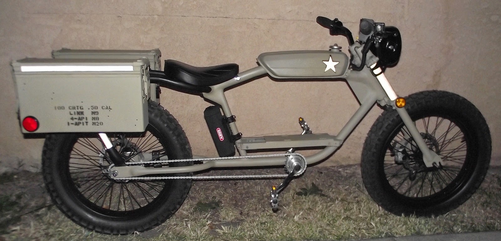

Thanks. I welded a bunch of .065" steel tubes that I bent together, with nothing to look at or reference, and that's what I ended up with. Cost about $100 in steel tubes.
I did that already on my last bike but neither motor, by itself, was worth a crap. The price of that setup was insane for what it got me. So now I'm sticking a 14,000 Watt electric motor on that frame that is 4x the power of my last bike. If the frame doesn't explode that is. LOL

Actually I need to see if my home grown frame is gonna be able to hold the 450 lbs of total weight (with me on it). I just have no idea what that frame is capable of withstanding just yet. It's ain't to trust a frame until you ride it hard. I don't want to be going down the road saying, "what the heII was that noise?" every 5 seconds. LOL
So load the ammo cans with bricks, strap a sandbag or 3 to the engine mount & launch it off a curb a few times.
I would want to know the frame was ok before I put 2k worth of batteries, motor & controller on it.
I Agree with FFV8. Load it up and take it over a coulple good pot holes....see if that rear section holds up...
I rode it, Kamikaze style, down a flight of stairs. It had no affect on it. Next up is the stairs with just the motor mounted.
The chainstays can't give way without the seatstay tubes going first and taking the chainstays down with it. I'm not sure what kind of force would make that happen though. Ooh, it makes me wonder, Ooh, it really makes me wonder...........LOL

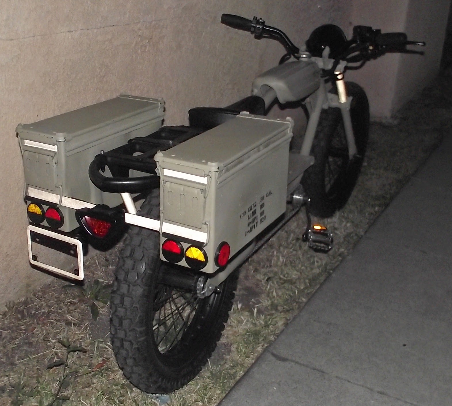

You don't have seatstays, that's the problem. You should make some.
What you have is a "rack" The vector is not there between your butt and the rear axle.
They're there, look closer. They're 1" diameter, Horizontal Seatstays.
They are pulling double duty but those tubes are double the normal size and thickness of what a normal bicycle has. That's my compensation for the lack of traditional seatstays. Whether or not it's enough compensation is now officially open for debate but since my @ss is literally test riding those tubes and their welds, My bike will ultimately have the last say of what it can withstand.
The Left and Right Seatstays are also welded to each other in 4 places instead of the normal 0 or 1 place you see on a regular bike. What does that mean exactly? I have no idea......yet. It might be absolutely meaningless. LOL
