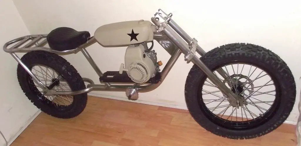

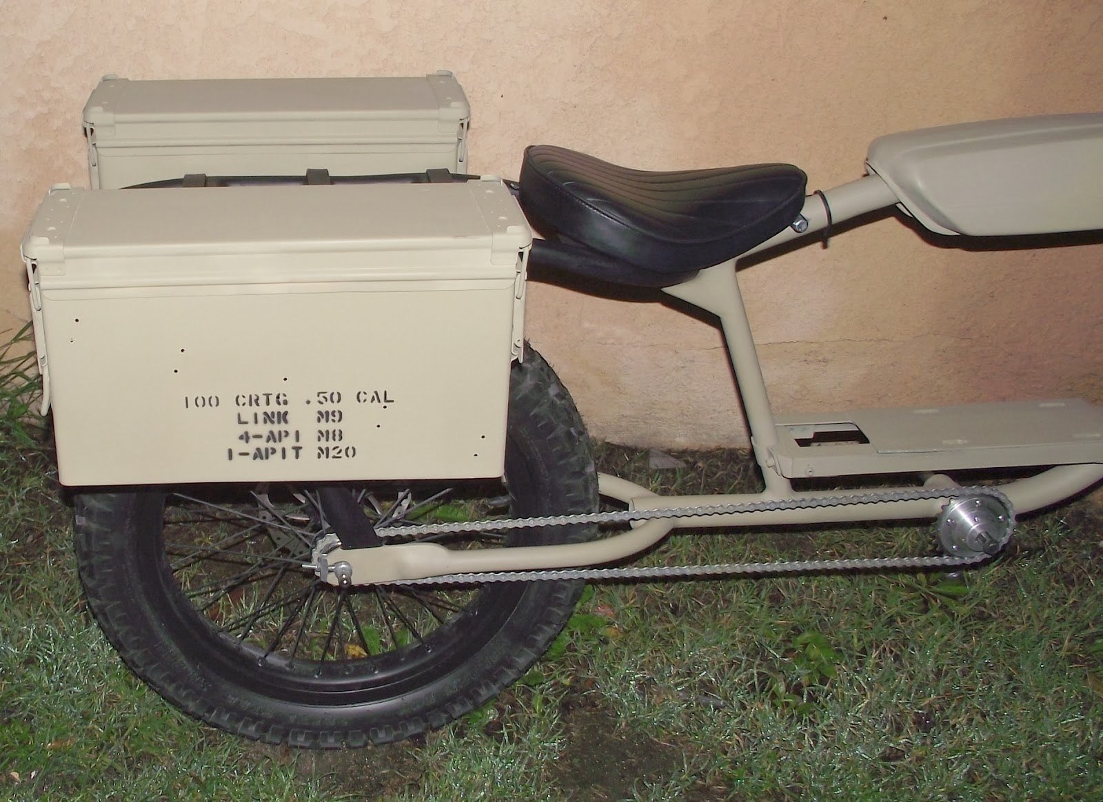

Thanks Easy. Hopefully that bike doesn't kill me, since it was my first welding job ever. I also decided that I don't need any seat stays cause they just get in the way. LOL
I needed that rear rack on their for numerous reasons though. Really had no choice on it.

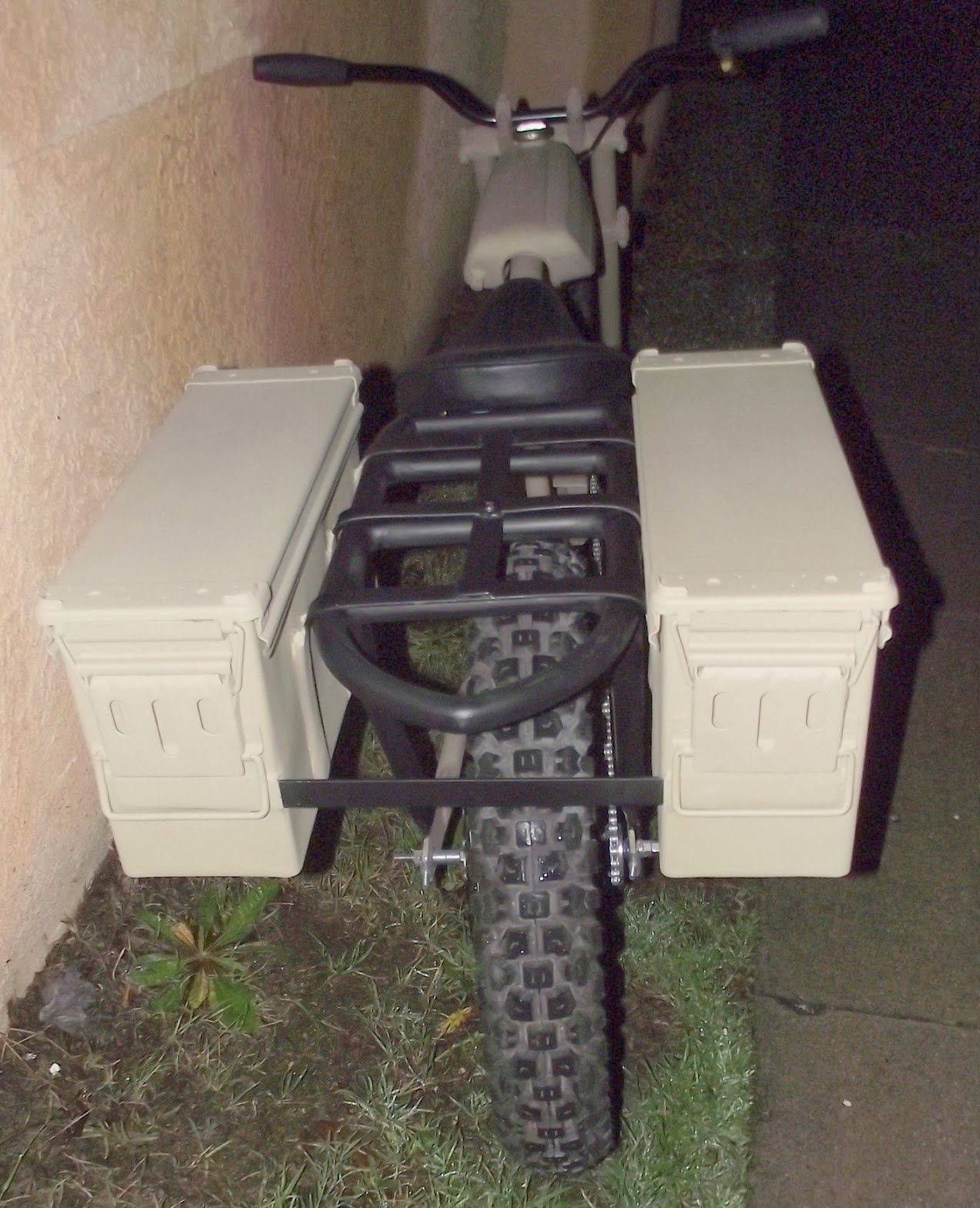

This will be a very good test for your welds......everything looks good from here.
Did I mention? ........ Nice rack! :D

I'm just guessing but I'd say it's either a Honda GXH 50 or an HS 49cc 4-stroke.
Actually I missed 3 pics with the motor. That motor mount looks like your monster 212cc can fit there with plenty of room to spare.
What kind of motor are you using?
Thanks much Scotto. The rack is a little massive for my likes but my tubing bender goes no lower than 1". I just wanted it to disappear visually, so I blacked it out.
That motor is a craptastic Dooldlebug 97cc with a bad rod that I just threw on there. The motor mount and entire bike frame is specifically made for a GX 200 or a 212cc engine.
The bike frame was actually wrapped around that motor mount. I had no sketches, no drawings, no concrete measurements at all. What you see is a bike solely designed around Flat Mounting a 200 or 212 engine. LOL
Looks like there's room for two of them.
You are correct. There is room for 2 of them. ''

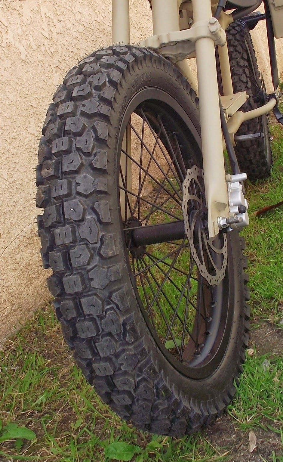

Tire Width (across the knobs): 4.125"
Tire Height: 25.5"
Tire Size: 3.5" x 18"
Tire Make: Shinko SR244
Tire Load: 484 lbs. (each @ 32 PSI)
Max PSI: 32 PSI
Spokes: 11 Gauge
