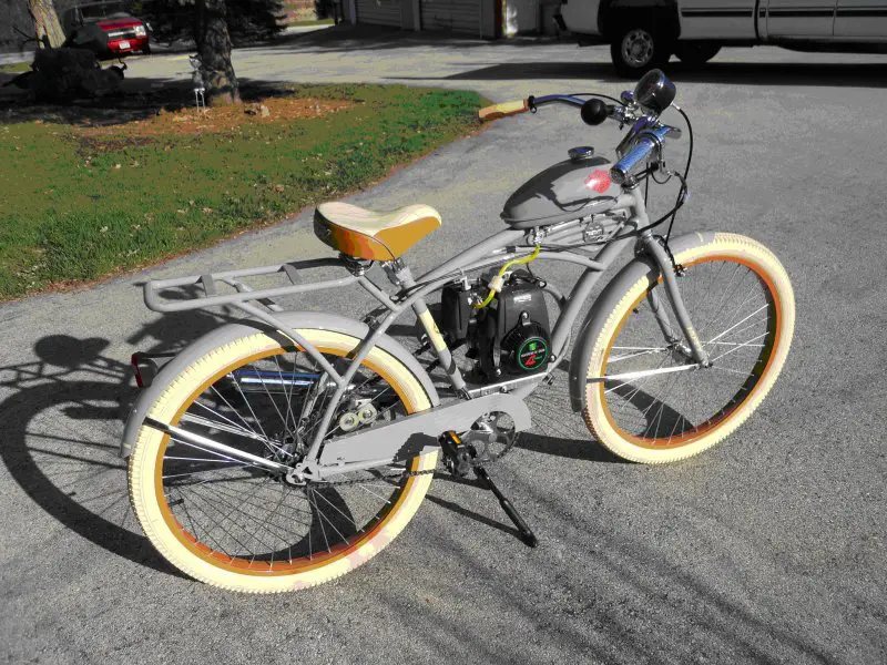

Same as mine, different color, unbeatable price.
