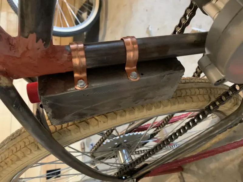

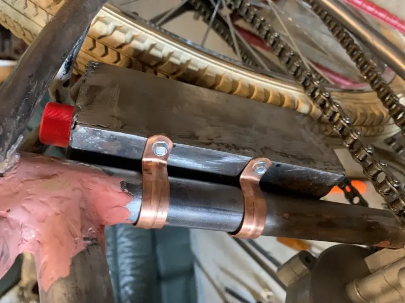

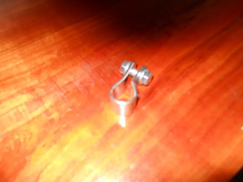

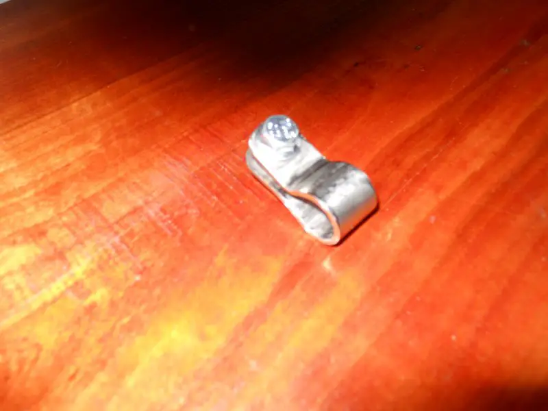

Made you up a bullet proof brake strap for #1 Boardy. You said the chain stay is 9/16 dia. Right?
Strap is made out of .077", 2mm 316 SS 5/8" wide. 1/4" dia clearance clamping holes for 6mm clamping screw, provided.

yes sir, 9/16 of an inch. I sure do appreciate that. I owe you one!

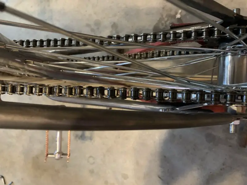

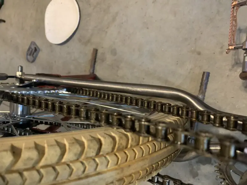

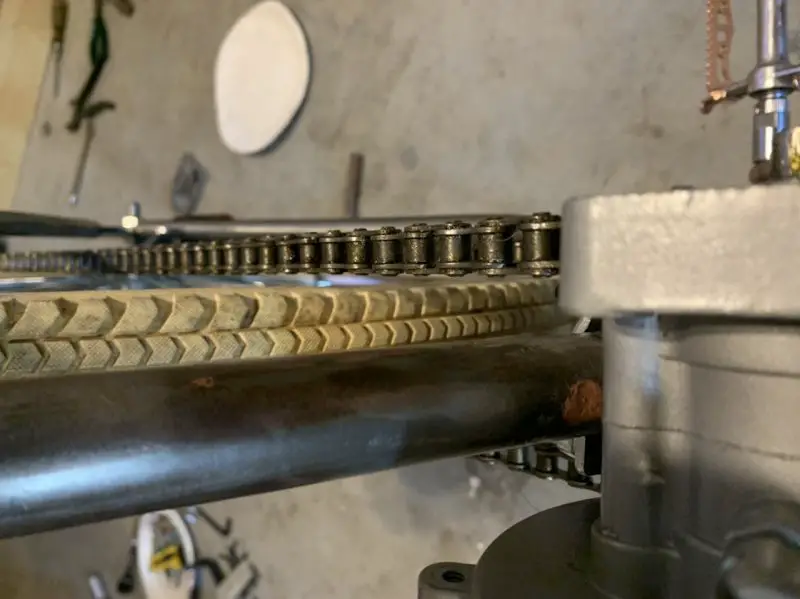

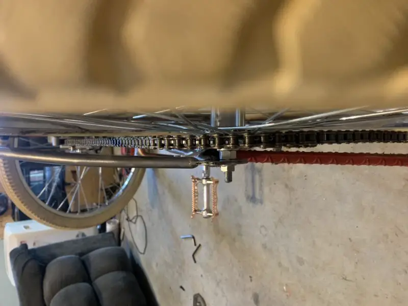

I’ve ordered a hub adapter and sprocket from Pat also. but just slipping the sprocket that comes with the kit on the back hub, makes it look like I might have clearance and not have to use a tensioner. That would please me tremendously

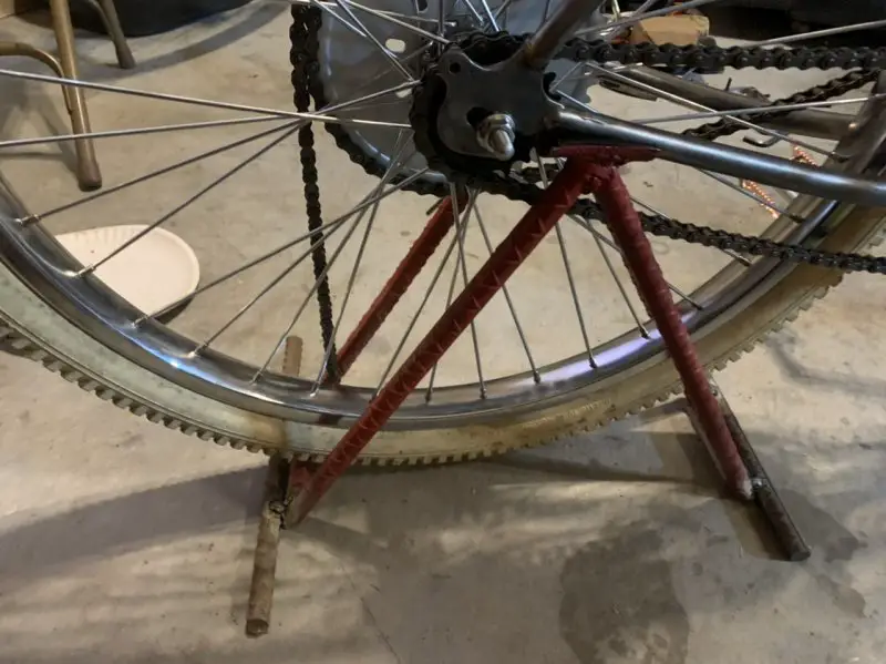

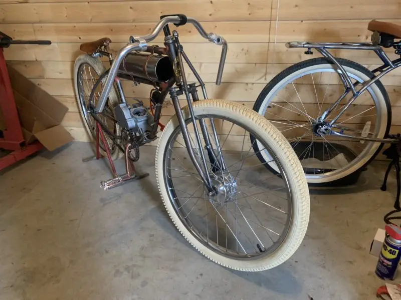

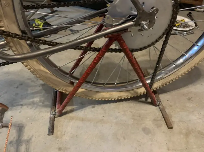

Danny, did you build the bike stand in your photos ? Can you provide some closer pics of it ? How do you support the bike on it ?
Sure but it’s cheap and unsure if it could handle the motor running. With that said I can sit on the bike and pedal with no issues.
The half pipe sections I welded on top of the rebar are not as straight as I planned and could be angled slightly more. I built this right after I got my welder and didn’t even have a bike yet. I’ve had to break it apart a couple of times and add extra side support as you can see. Needs another wire brush and some more paint.
I’m betting with a cable tie or two I could run the motor and not have any issues.
As you can see the chain stays sit on the rack.

The brake arm anchor made, is offset. Try it out.
I made a forming die today to make the brake strap with a true 9/32" radius. If a brake arm strap perfectly centered on the chain stay is needed, I am now tooled to produce it. No big deal in my machine shop. Took one beer.
The offset version, gives some allowance for brake arm position. Pat had brake strap and arm ideas, which he holds close to his vest. For good reason.

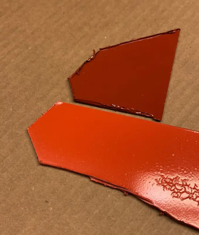

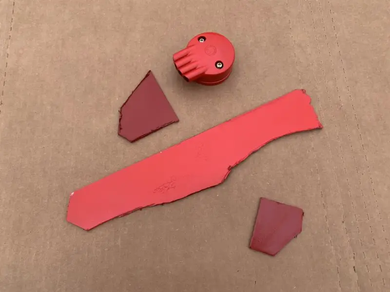

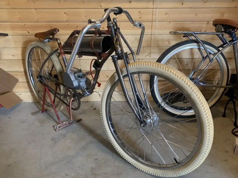

Too early to think about paint, but...
so far I have tried a little regal red and gloss cherry. The gloss cherry is just too bright in my opinion. Wish I would’ve taken some pictures when the sun was up. The regal read appears pretty sexy to me.
after looking over a bunch of different reds I’ve eliminated most but still have two more I would like to try. Some gloss sunrise and some safety red.
it’s sort of hard to tell on just the Internet, but when I actually lay some paint down I can see the color. With that said however, based on the Internet pictures, I’m leaning towards the gloss sunrise.
pictured below is the cherry red and the regal red

It’s cloudy today, but the colors come through better outside. Regal red is the winner so far. The cherry red almost looks orange in these pictures but it is a little more red, just too bright
