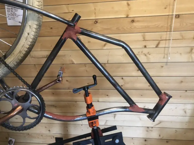

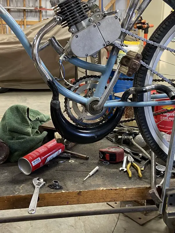

I feel pretty good about these brazed joints, but I will keep a lookout for potential issues or cracks.

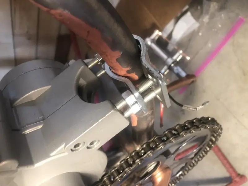

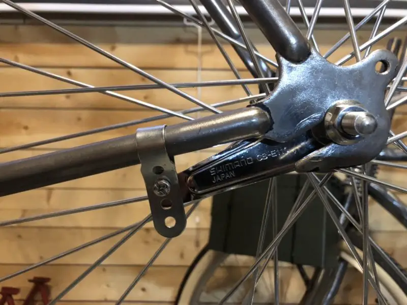

btw Tom, were you telling me not to trust the brake clip that came with my wheel?

The brake strap isn't gripping the chain stay fer beans. But, at this point it is moot.
You got to get the drive sprocket mounted.
Then see how much and where the brake arm needs to be offset to clear the drive sprocket.
I ended up offsetting my brake arm 3/4" with two 90 degree bends to clear the sprocket and center the brake arm to the chain stay.
Gotcha, just ordered handlebars from pat, Drive sprocket and hub adapter will be next

Brake strap I can make for you, when you give me a chain stay dia. and you need it. Time'l tell.

And the chain stay is 9/16” Tom. And thank man !!!
Chain stay dia. is 9/16" roger.

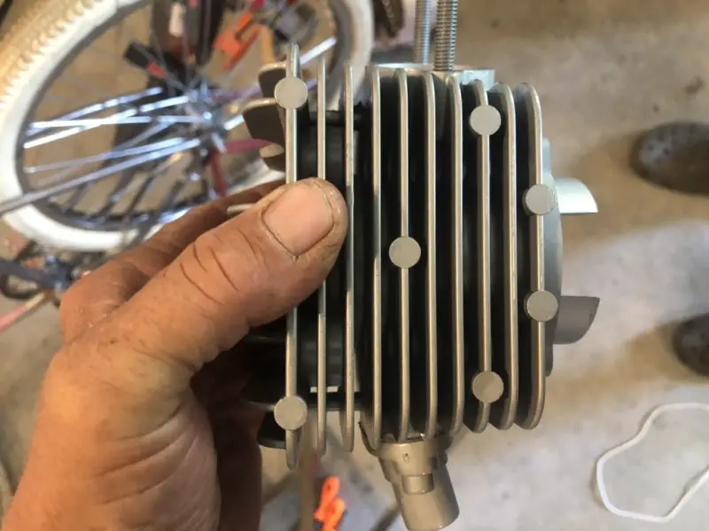

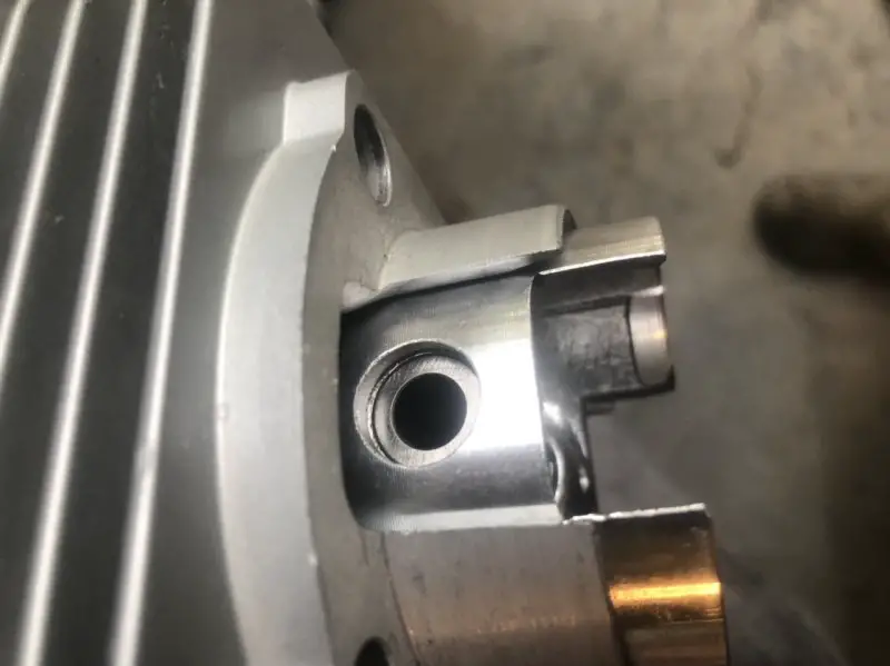

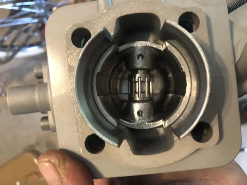

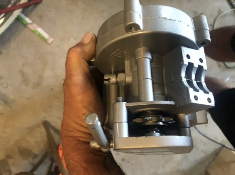

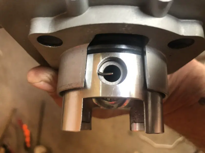

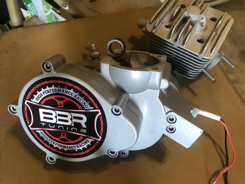

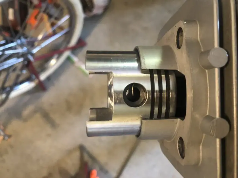

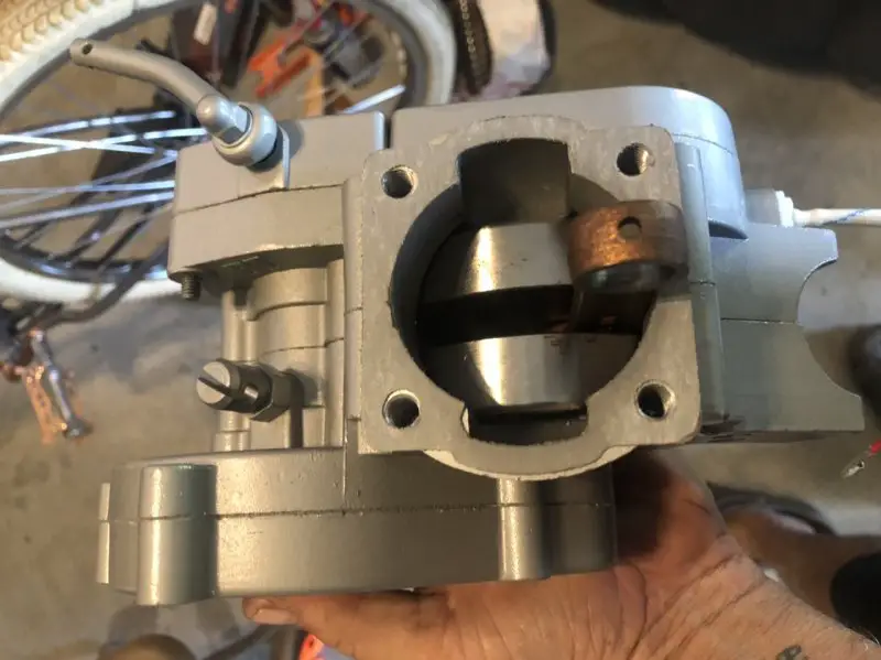

Ok, so my motor came in yesterday and the first thing I notice is a missing wrist pin on the piston roller. Have contacted bikeberry for a replacement. The kit also can without instructions. Nuts and bolt and spare parts in a single bag.
I was gonna put the jug on the bottom end when I noticed the missing pin. Last pic shows the side with the pin. Thought I took a picture of the other side also, guess not. I will when I get home

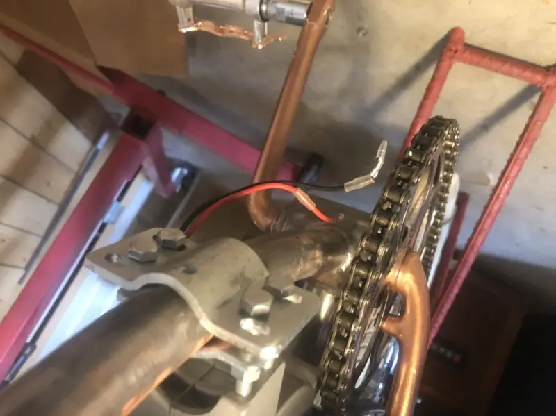

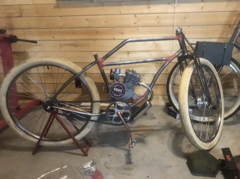

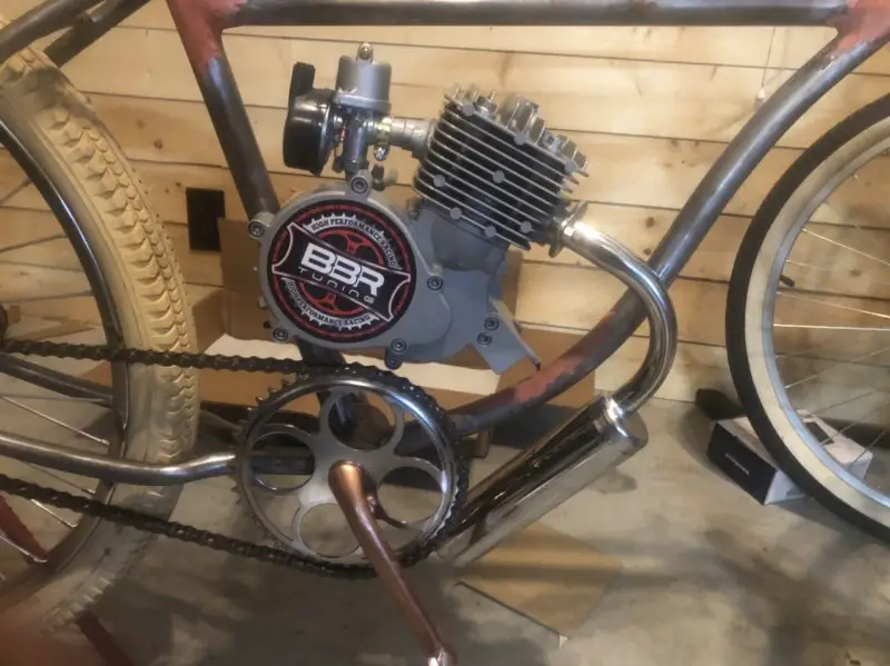

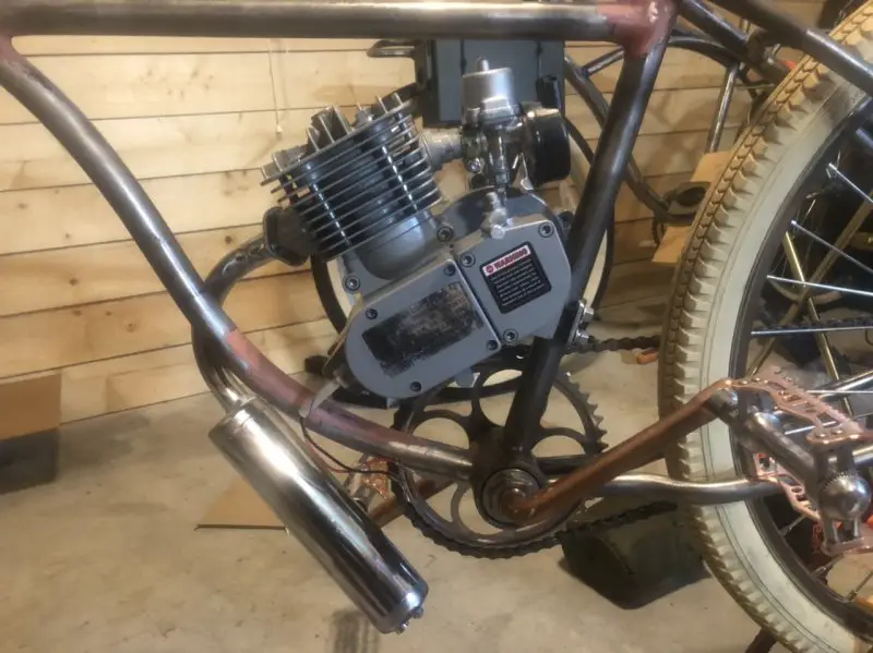

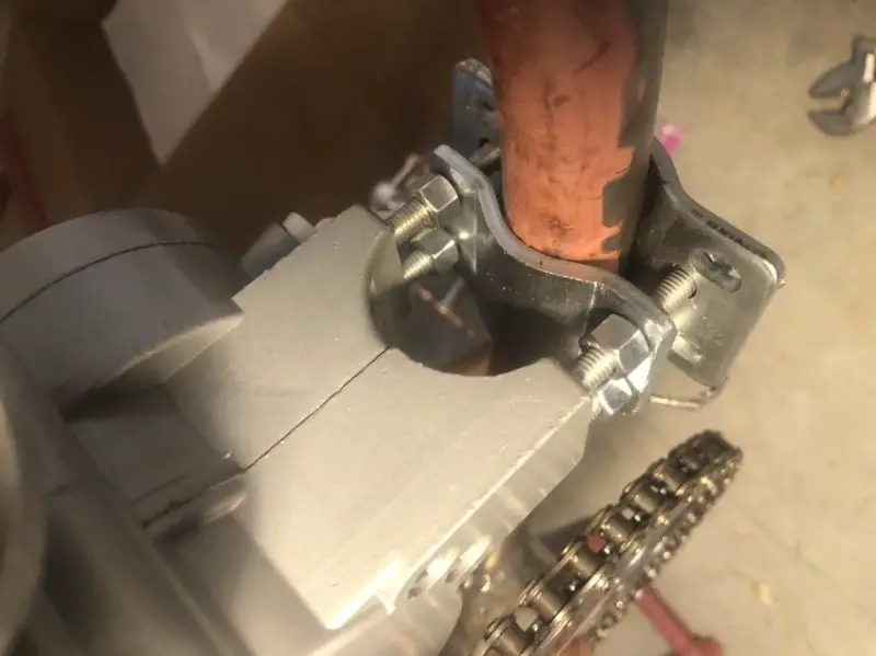

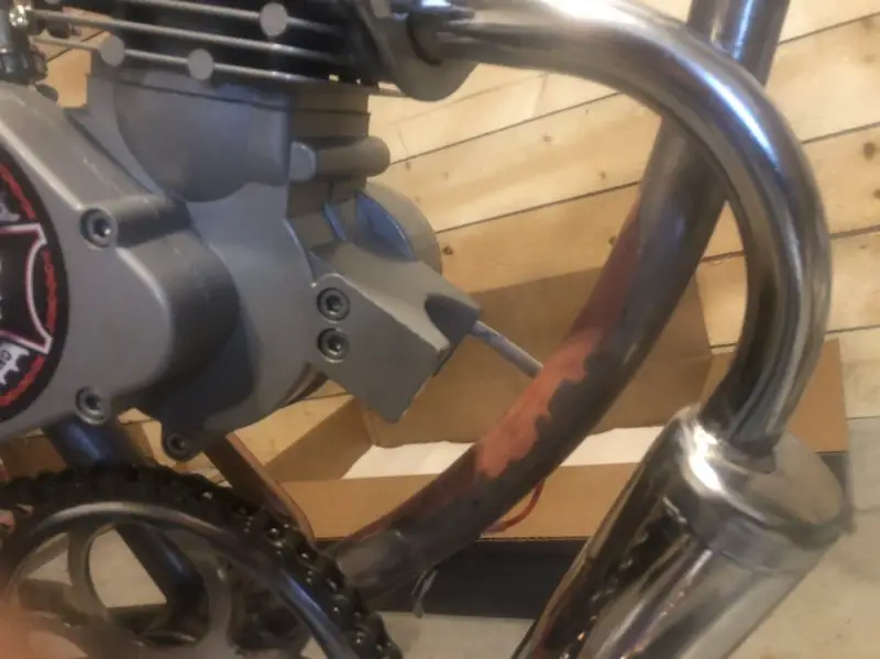

So my second problem. Motor looks bad ass but I had to clear the pedal chain and the front motor mount is gonna need help.
Old the biscuit used a solution I might have to try. His is the last picture, another tube.

So I don’t think this is the solution, but it’s the best I could come up with out of the kit. Still researching
