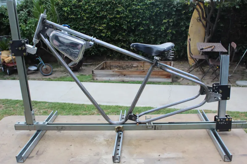

Remember me recommending Unistrut?
Courtesy of Jeff Wolf photo.

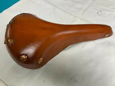

While searching eBay for a seat for my WLA build, I came across this beauty and could not resist for my Indian BTR with copper accents.

The Indian Brooks has the nose screw, which adjusts the saddle tension. Saddle break-in is more about racing saddles that for weight reduction have no such adjustment. But that Indian saddle, has no suspension. I got one hanging on a nail.
Painful so called prostate massager is real on a un- adjustable saddle frame.
I was hugely lucky to acquire what for now was a new release, prototype B190 Brooks saddle last year. It is double sprung.
On rough roads, is a comfortable ride. Full sprung saddles.
Currently their best offering for a sit on saddle. B135 (brooksengland.com) Had not the B190 briefly appeared, the B135 would be my saddle today. The B190 has a slightly broader seat pan. Pricey? No Chit. The only fault is the seat clamp.
cheap and under engineered. Stamped, formed steel mounted do not hold up to our stresses.
I made my own seat post saddle clamp components. Solid.

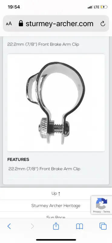

So I was messing with my front brake arm clip and it’s way too small. I see the only thing that’s available from Sturmey archer is the 7/8 and 11/16”, I am assuming I have the 11/16 but it’s kinda hard to tell. If I do then I can tell you now the 7/8 is probably too small also.
what so people do to overcome this?

You son, have hit the proverbial wall. A loop to retain the brake drum arm is necessary. You have demonstrated adequate welding skills to get er done.
Use the provided strap welded to the fork leg. Or $hit can the stock fork for either a Monarch copy or a Felt springer. Both are able to use SA drum brakes without mods. Disregard this message if it no longer applies.
This isn’t even a stock Fork, these are my nice faux Indian Chinese made forks. But if welding is the correct answer, I guess I’ll have to git her done.
thanks Tom
