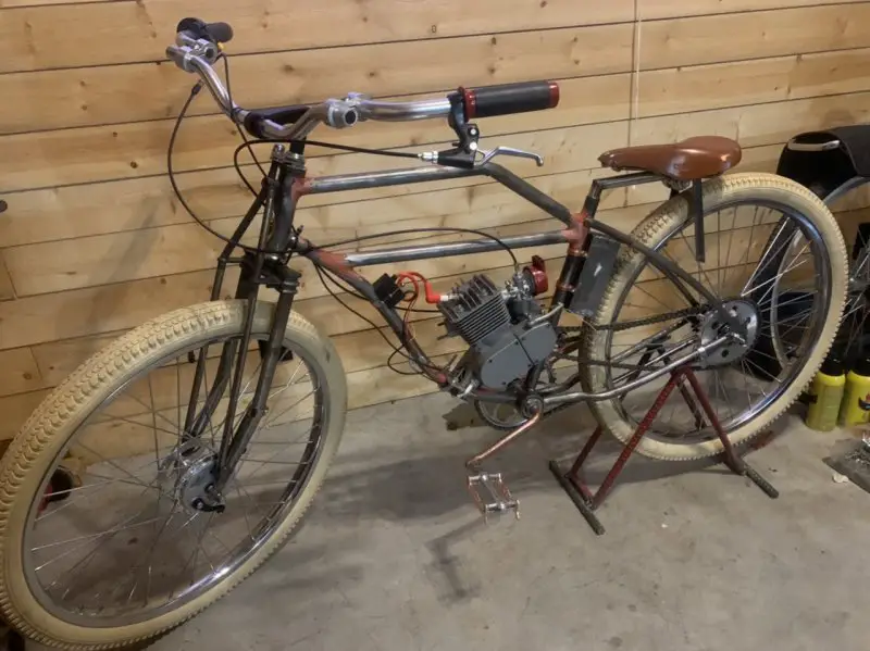

Here ya go Danny.

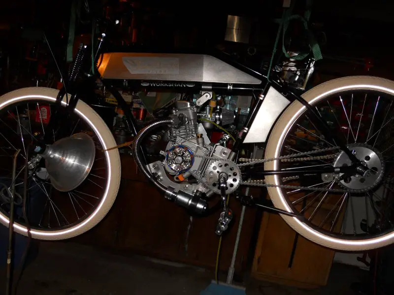

I am a relative newcomer to this forum, but Pat's are the only other Flyers I have seen.

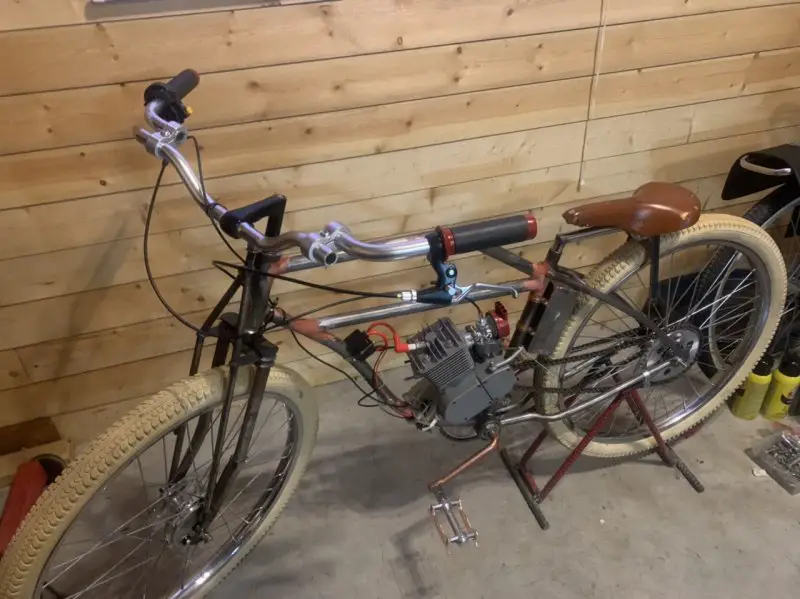

So I got the clutch cable and hand lever hooked up to the clutch lever. Works fine.
However my throttle cable is too long. If the plastic shielding on the outside was longer it would work. Is this the best way to address this issue? Cutting and using silver solder.
Or has anyone successfully spliced extra plastic around the cable?

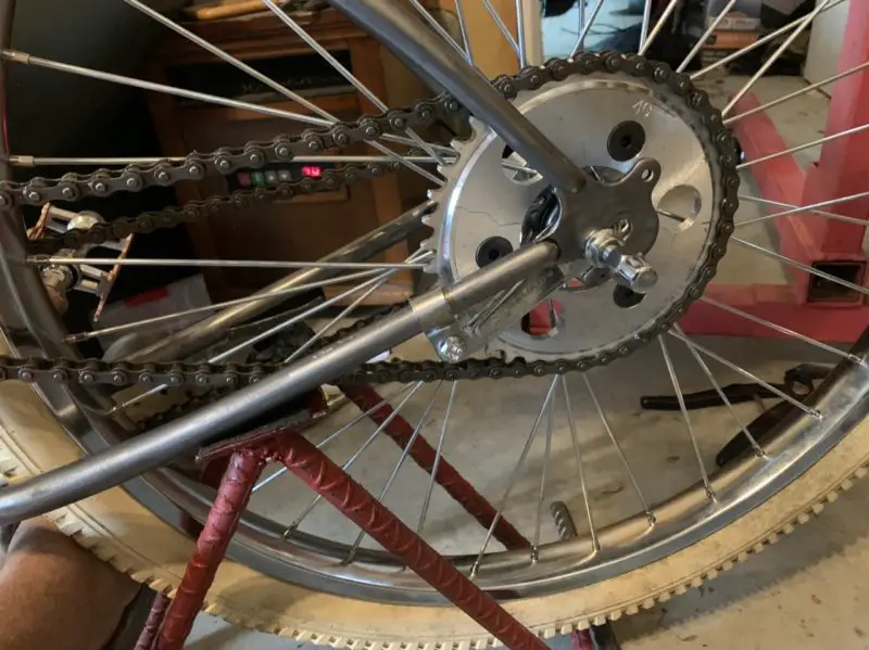

Perfecting your chain line is essential.
My H. D. will roll forward all day. Back it up 3/4 wheel rotation and the chain walks off. Rag joints suck for no adjustment.
Flyer with perfect chain line is indifferent to rolling direction.
If your chain feeds with out flaw forward or backward, yer good. Maybe not perfect but good enough.
Tensioners are not needed with Diamond brand chain.
Tensioners for POS 415 yes.
So I just got done walking the bike about 15 feet and backing it up. No chain rubbing anywhere and no alignment problems. No sprocket jumping

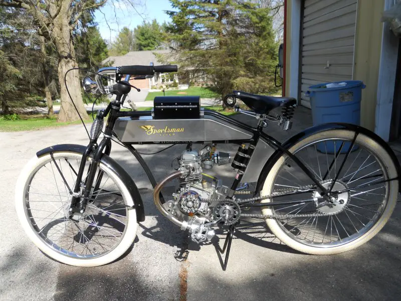

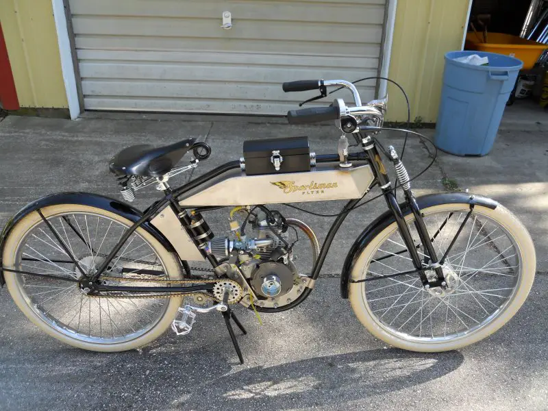

Couple of questions for you, what motor is that?
Did you build the toolbox, have not seen that on Pats website?

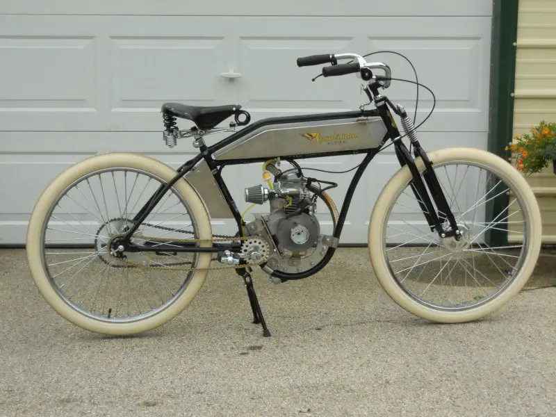

Pat's motorbikes are very Indian based. His reduction drive/transfer drive is pure Indian.
The Flyer 80 and 160 use a Bully centrifugal single disc clutch. Ain't cheap, but delivers engine braking.
Pat has them set up just for the 80 from the factory. Slick.
My bike is a Sportsman Flyer 80. The 80 is the Harbor Freight 79cc Predator engine. Can be Hot rodded.
The box on top of the tank straddling the top frame tube was fabricated by Dan Orabona.
Pat has in partnership with Worksman Bicycles mostly been a precision production builder.
Dan, is a one off mostly Indian styled fabricator , artist.
His 1913 Oscar Hedstrom, cradle-spring frame recreation stands as a masterpiece.

Dan made the tool box. I gave him basic specs. Bicycle inner tube sheets made it tight

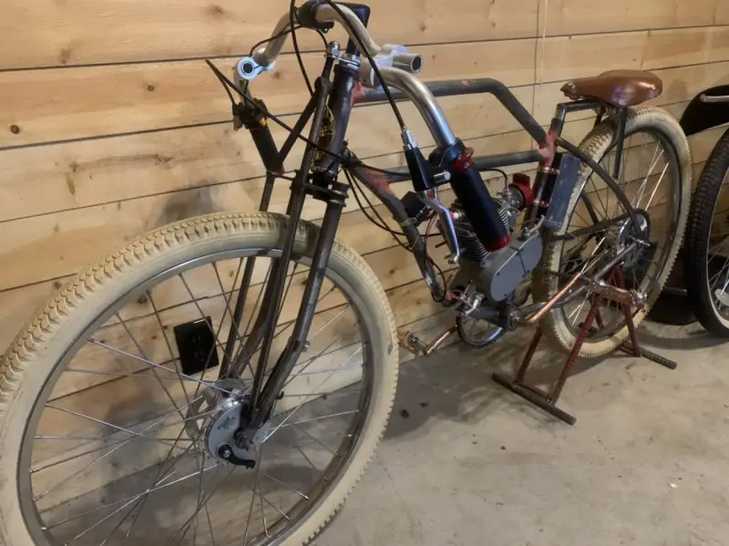

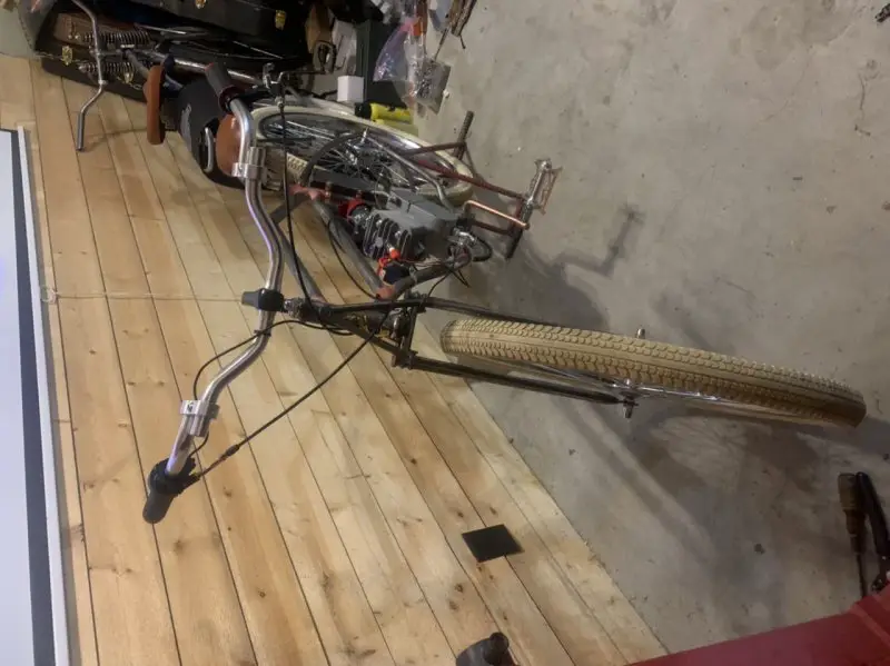

These handlebars from Pat are slick. Literally five screws and I flipped them up to make it look more street than board track racer. No cable adjustment or disconnection necessary. Gives me nice options.
so I could flip the handlebars up, put on a different seat and a old headlight for a secondary look.

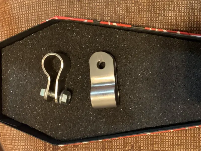

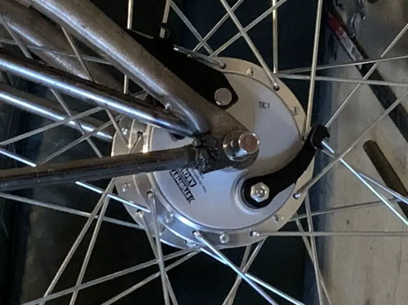

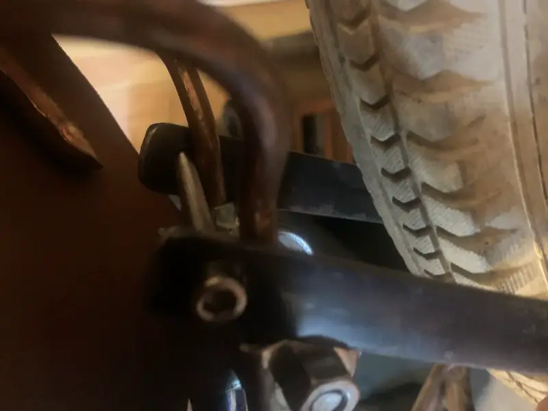

Glad to be of service Danny, looks like you chose the offset one. Make sure you have full clamp on the brake arm.
Pretzeling a brake arm can be hazardous to your hide.

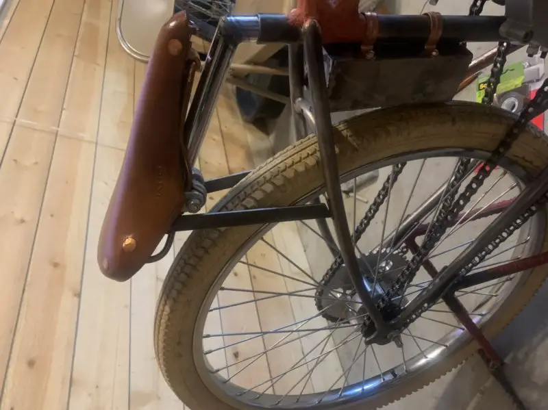

What do you think of the Shadow Conspiracy chain box?
Took a chain and a half for pedal side. Crazy Kool BMX chain. Have to have a trick a$$ breaker/maker tool
Chain must be tough. Culver City Classics, Jeff Wolf uses it drive side.

I did put the offset one on. Just looking at it closer I believe I’ll try the other one also to see how it fits.
Tom, your shipping containers are top notch, and that’s a sweet little tool, adding it to my wishlist...
