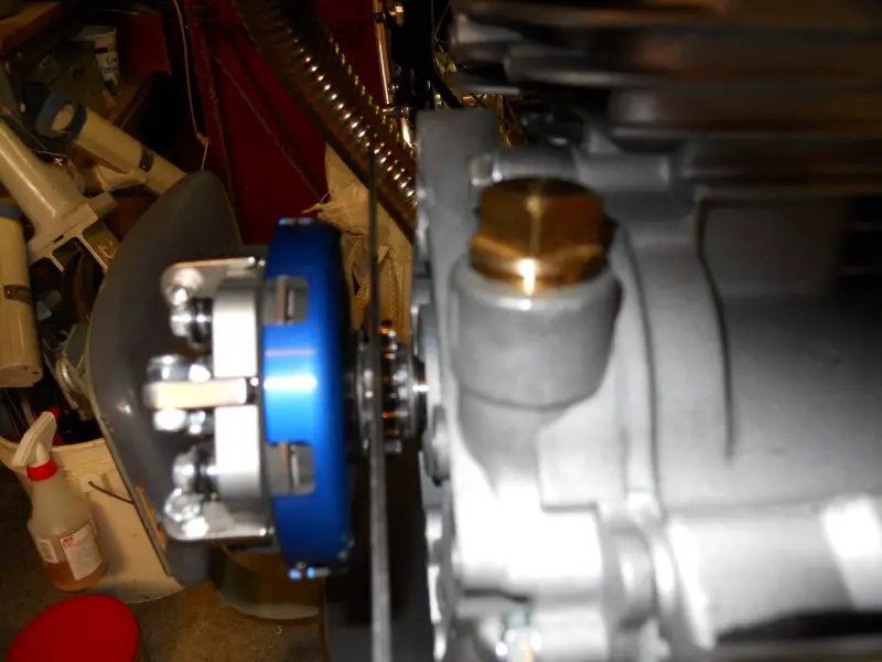

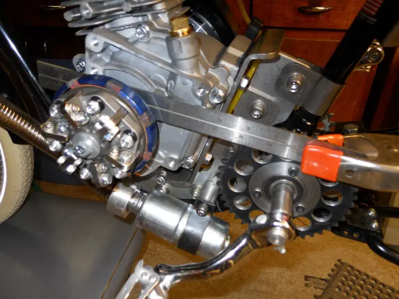

How I do chain line verification.
Same goes for rear sprocket to reduction drive out put sprocket. Which is when I started buying and adapting Marten steel sprockets for the reduction drive. Overkill? Yup! I like it.
Cool, I will try that next time I’ll take the wheel and chain off. The motor is pretty solid and there’s not much adjustment room there. I did use the hub adapter to push the sprocket out where I needed it. Looks pretty damn straight to me.

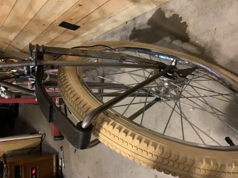

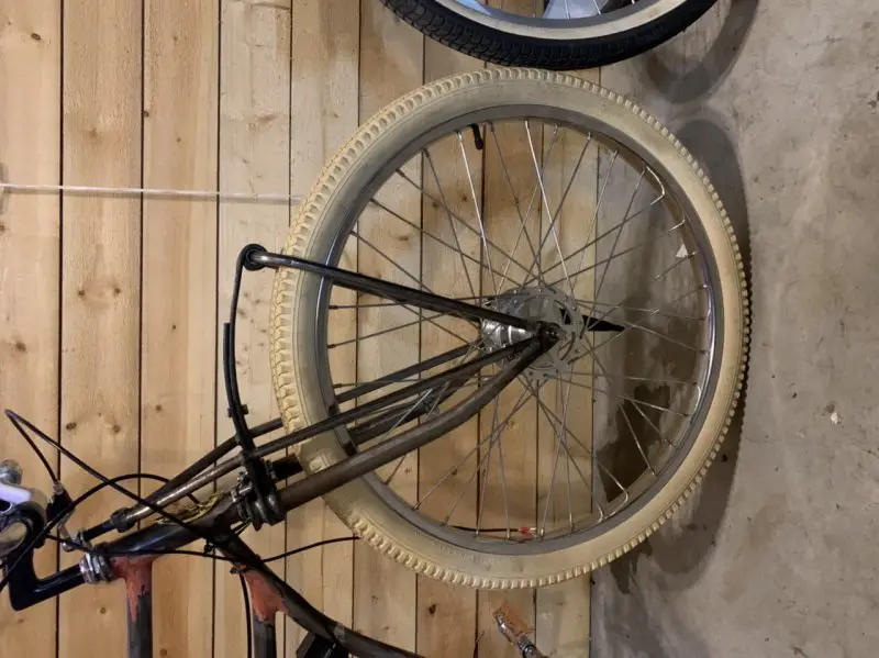

Indian leaf spring, will get em looking.

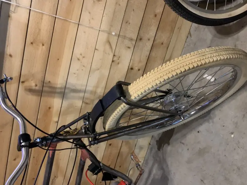

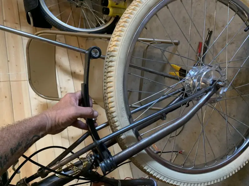

and yea the Indian leaf spring is turning out nice so far, I’m really pleased. It’s completely mounted, now I have to bend the supports and weld on the second mounting mount.
pay no attention to the cheap hardware I’ve mounted the spring with. Quality hardware will be used. The bends are not perfectly symmetrical unfortunately but close. Mounting it this way I had to make the second bend with the leafspring already attached. In fact, I heated the first bend (Pipe full of sand) and ended up having the been the second one by hand with a cheater bar.

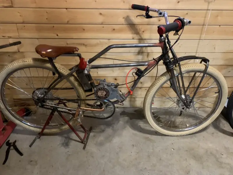

Just have the tank to finish, weld the seat struts and get it started before heading to sanding and paint.

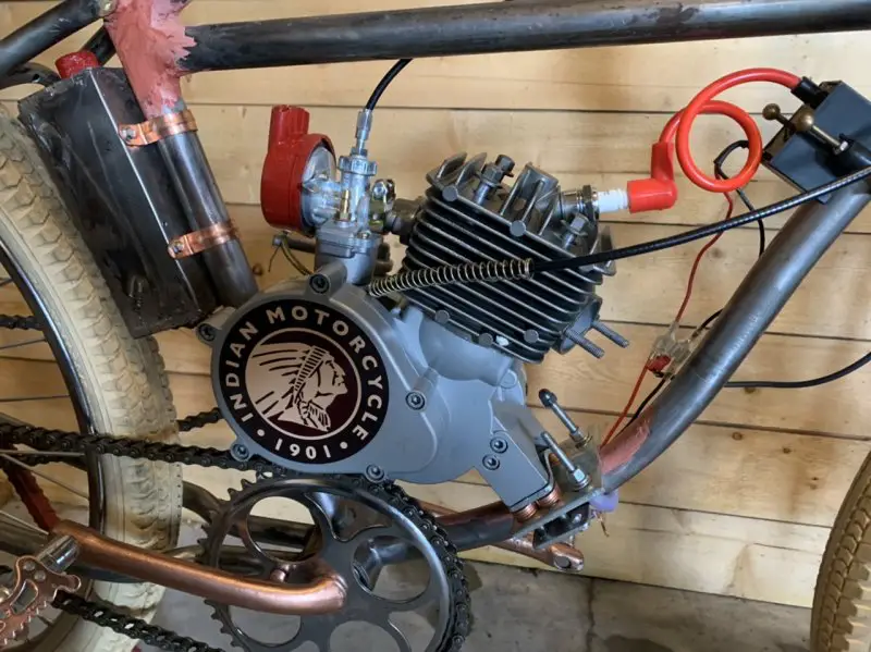

it’s fake, but it looks good lol .shft. usflg

Passes my close scrutification. Beers may dull disappointment but often liberally applied lead to obfuscation.

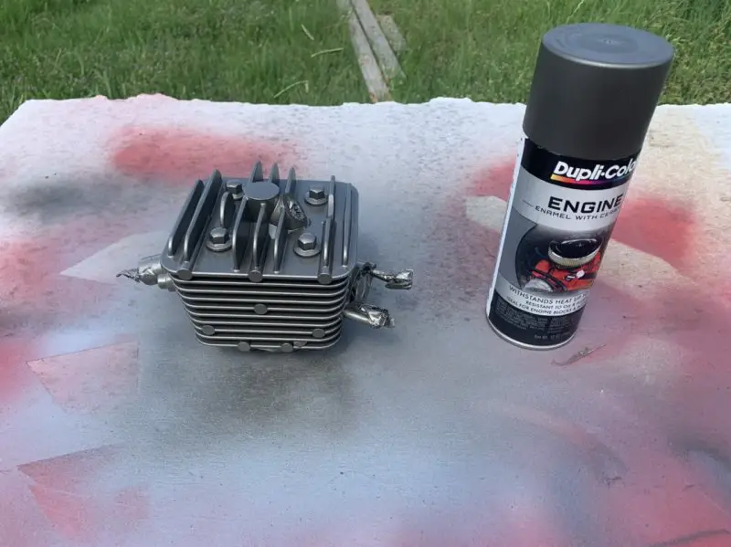

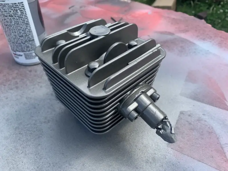

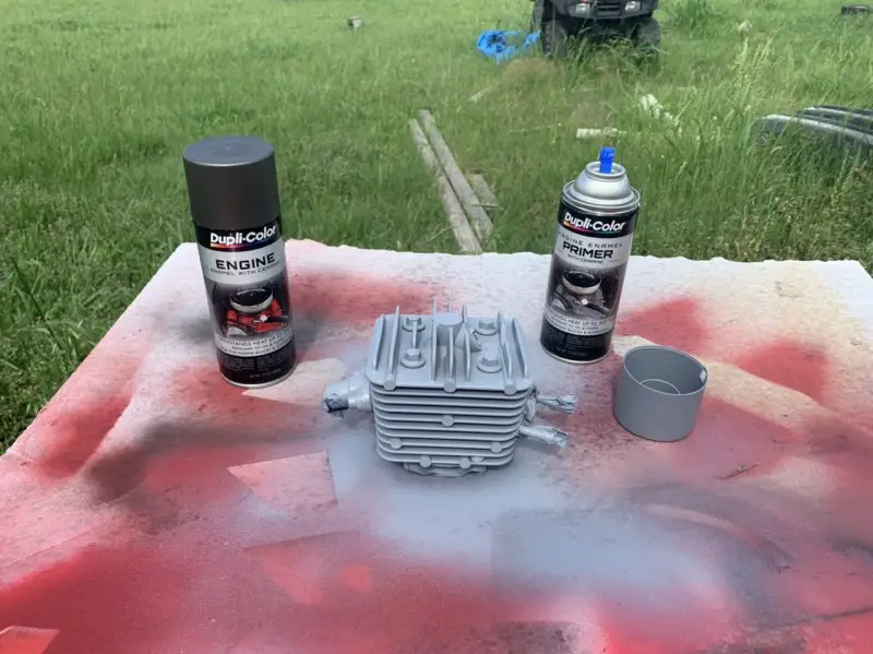

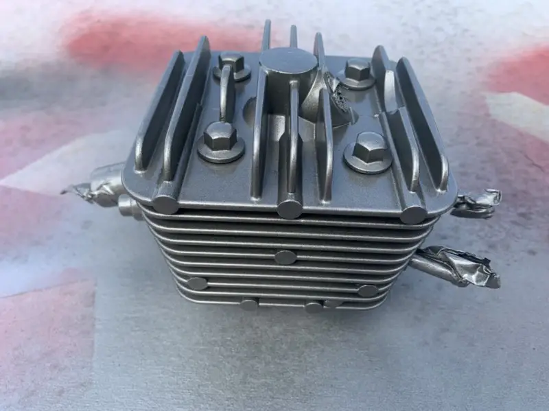

Got some paint on the jug today. Crankcase needs it too now that I see how good it looks
