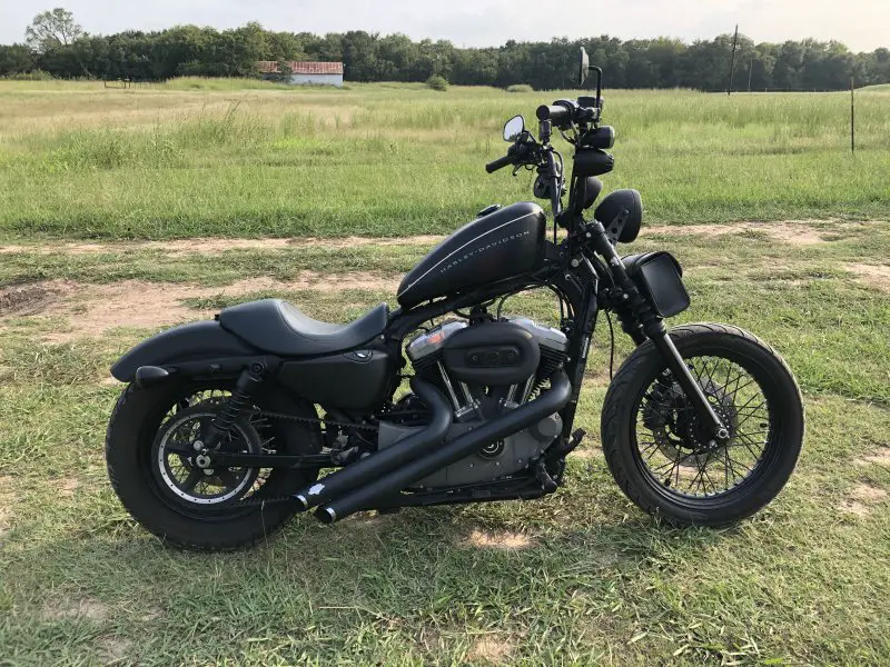

it’s kinda in my blood, just wish I had some metal fabrication tools. Anyway, here’s my two latest projects.

The Harley is a Nightster. A sportster model. She’s quick !!!

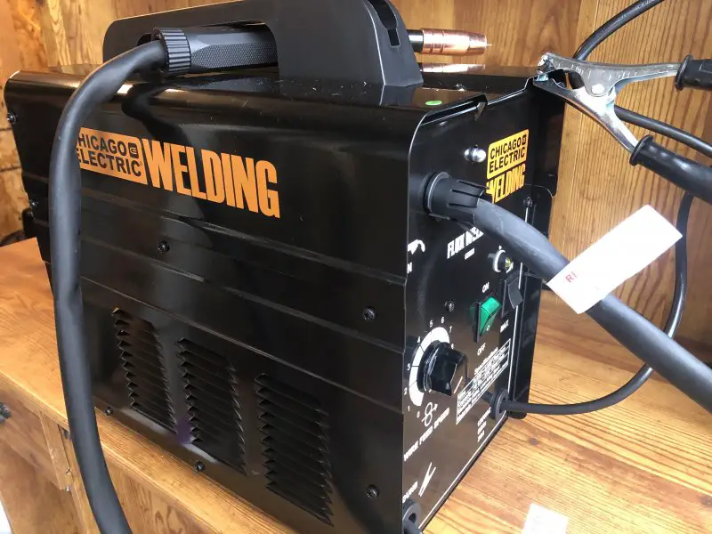

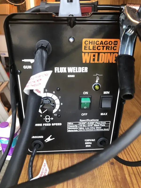

Well not a mig welder, but a flux welder. This will up the game a little bit. The cheapest welder at Harbor freight, but it’ll help me make a custom gas tank even if it’s just for looks, with a plastic bladder inside. I would imagine getting a gas tank welded well enough to seal is fairly difficult. I’m an extremely novice welder as I’ve only done it a few times in my life. Says it can weld up to 3/16 of an inch thick, should be good for bicycle frames also I believe.
