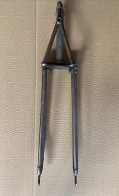

Stay away from that springer for its garbage.
flimsy as a noodle.

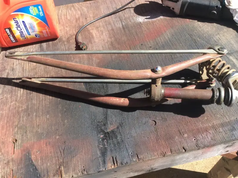

this one is way better, I can vouch for it almost 300 miles and no issues and it had a bracket to mount a disc brake.

Thanks for confirming what is already posted loop. Most springer forks increase wheel base and trail. Danny will soon enough find out how exciting a Cranbrook can feel. It ain't a Harley, and it will thrill. My Huffy Davidson is the first machine that I, having imbibed feared for my safety.

The fork you bought is down right dangerous. I've been here since 2009 and over the years there have been some might graphic photos of different rider who had them snap in two. The degree of injuries were in direct relation to whether the rider was peddling or under power.
I just looked this fork up. The price has gone up $60 but may give you a chance to make an Indian style springer fork. Rick, Tom or Curt will have a better idea if it's a good choice.

Hey Steve and thanks for your input as well. Guess I probably jumped the gun buying that fork. I can’t ignore what all of you are telling me.

From back in the 50"s lucky to find one, and no haven't used it yet. Also the original Schwinn were a lot heavier, but again to find one. I did however have a Monark twin spring on a factory Monark motor bike back in the 50"s and loved it, but was 16 at the time when details were not important. The fork Loop showed is a lot heavier and would be the better choice, much more stable the the springe, and then the old Monark fork, as I have one of them also. Member Motomegs has used the one like loop showed and likes it well. I used the Monark type rockers on the leaf spring Indian type fork I made and worked good. Just save your springer for pedal bike, like me I rider everyday, on my pedal bike when nice out............Curt

Thanks, so the key is an older heavier model, gotcha.
