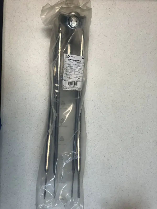

Yup that's the one Danny, mounting hardware will go in a bag or in a box. The Sunlite front fork has the part welded on to hold the brake arm, Just in case you change your mind. Right side had the mounting bracket for a disc brake caliper.
You got options.

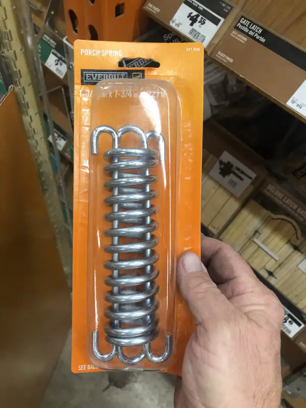

Something decent. But my new welder has me considering more fabrication. Specifically a gas tank, a laid back seat post and possibly forgetting the sprinter front end for a fake one. May build something like Eugene did in the video I posted last, using the stock forks. But I would probably add some springs on the uprights he added. Something like this I saw at Home Depot tonight (Guts removed) might even look decent, but some real springs would look better Then I would have a solid stock front end looking springy

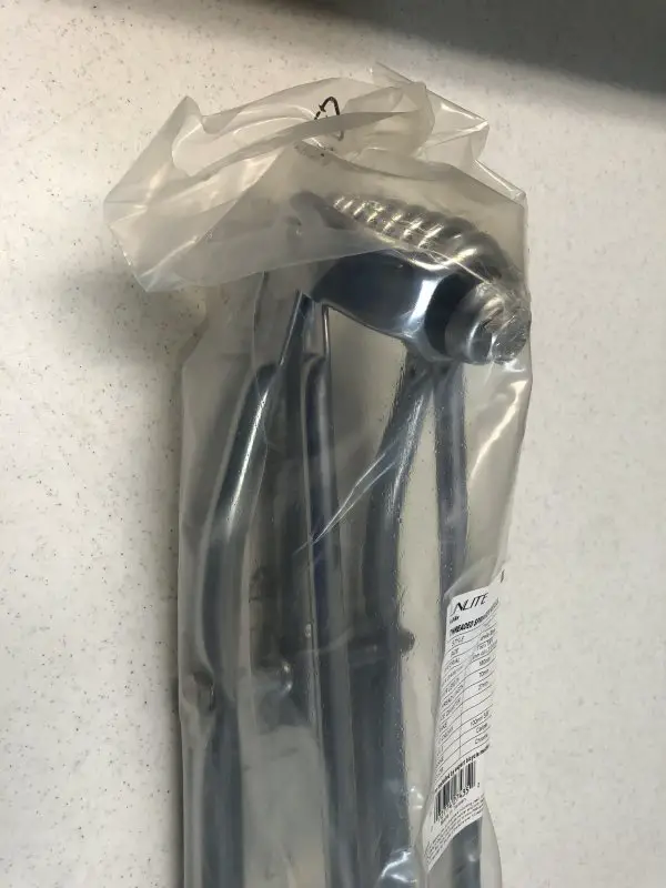

Got my first part in. Still undecided on whether to use it on this build or save it for a future build

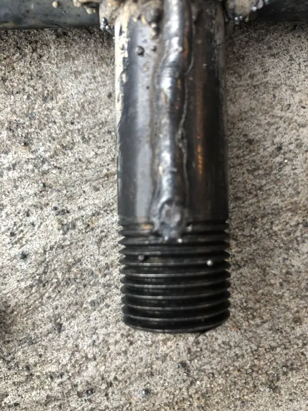

Learning how to adjust this little welder I got. this was my last bead I ran. Getting there.

Yer weld bead is respectable. My home 110V flux core welder only got use once so far, repairing a weld on a mower deck.
These dinky welders have limited continuous service. But a good breeze can keep you going.

i’m getting there on the welder, it’s all about understanding thicknesses and wire speed.
