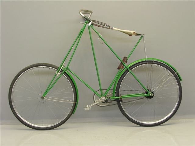

I can't do anything for the next couple of weeks, Doug is up to his eyeballs in work, including the polishing of tubes for a pair of Dursley pedersen frames. Ever seen a Dursley Pedersen?
Back to Redditch again tomorrow, brush painting Pedersen frame tubes and then possibly trimming a solid rubber tyre for an American high wheel bicycle.
