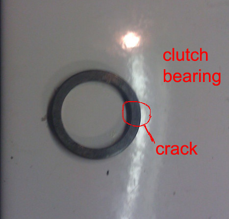

you can't tell in this picture but there is a small crack in my bearing. i need to know if i could just replace the bearing or would it be better to just replace the whole clutch assy.?
I really doubt if anyone sells just that part so you will have to
replace the whole clutch.
Where in CA are you?
I happen to have just one of those bearing rings but it may not
fit on your clutch.
fit on your clutch.
in santa maria.
i found a clutch at kings i was going to p/u. it didn't say what size or motor it was for. i didn't do my homework b4 i built my bike and over paid when i bought it from motovelo :/ they don't have a parts section so i'm kind of screwed. won't be going back there since i've been reading through a few of these threads.

I think all the clutches are the same except that some have a wide woodruff key, while others have a narrow one.
