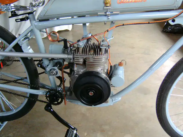

Anyone lookie lew'n...have you ever tried this(pic) I like that the cylinder is seen. Reason for this thought is not having an exposed fly and cup. I would end up hurtin myself.

Seen that done with the little 49cc HS engine.
I removed the recoil on a 5hp Robin flattie in a build I did, Ground off all the flywheel fins then made a start pulley out of a lawn mower deck idler and moved the starter rope notch inside. It was all smooth. If yer pants got in it not much happened, just let you know it there. Gotta live on the edge some time!
Just don't leave your start rope at home, it was a long push back!
pic. http://motorbicycling.com/attachment.php?attachmentid=47832&d=1336601541

That is a nice way of doing a rope start. I'm runnin the alum flywheel. I don't know for sure if the cast would work with the mag. I took mag and flywhheel off a 4hp mower, put em on my 3.5 and worked great. If the cast fly works, how do you remove the fins. I've got a couple to practice on! I don't want to do the alum one because, if you don't do it right, it will snap back, as you mentioned. At first I thought the engine gained heck a compression..till you told about your experience with alum fly.

The flywheels should interchange. We ran 3hp flywheels on 5hp engines just by making a drop for the mag.
Lathing the fins is the best way if $$ isn't a problem. As crude as it sounds on the Robin I knocked the fins off with a hammer then ground the stubs down. The fins were fairly delicate. As I remember on the Briggs the fins are quite stout and may not knock off so easily. You can grind em just takes a while. I left just a faint trace of the fins so I was sure I hadn't ground into the flywheel itself, not a good idea.
Check with Msrfan I believe a lot of his builds may be finless.
Remember with no or even your cut shroud you have to be moving to cool. Probably not a good idea if you sit idling for long periods.
