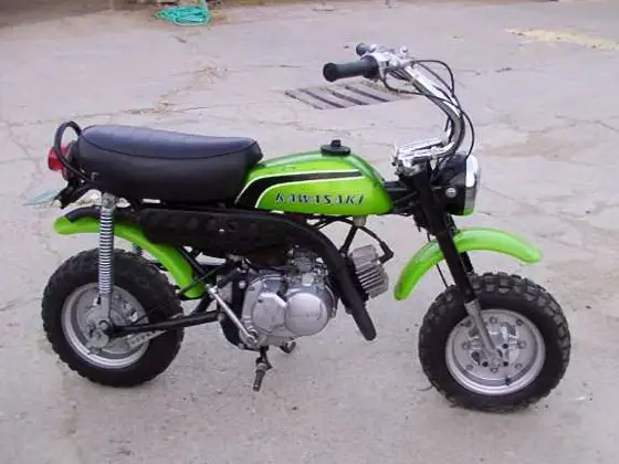

Yeah, I've decided to not use the big blue tank, but rather the new red one I got on ebay. The red tank was listed as a "minibike" tank with no further description, and I've been wondering what kind of minibike it came from? Doing my daily ebay scour, I noticed a "minibike" tank that looks like mine, and upon further investigation, I've decided that this must be my tank.
The red tank came from a Kawasaki KV75.
Here's mine:
And here is one on a KV75:
So it's weird that I purchased two Kawasaki tanks for this bike???
Anyway, if anyone likes this tank and think they might want to use one, it's a KV75 tank.
