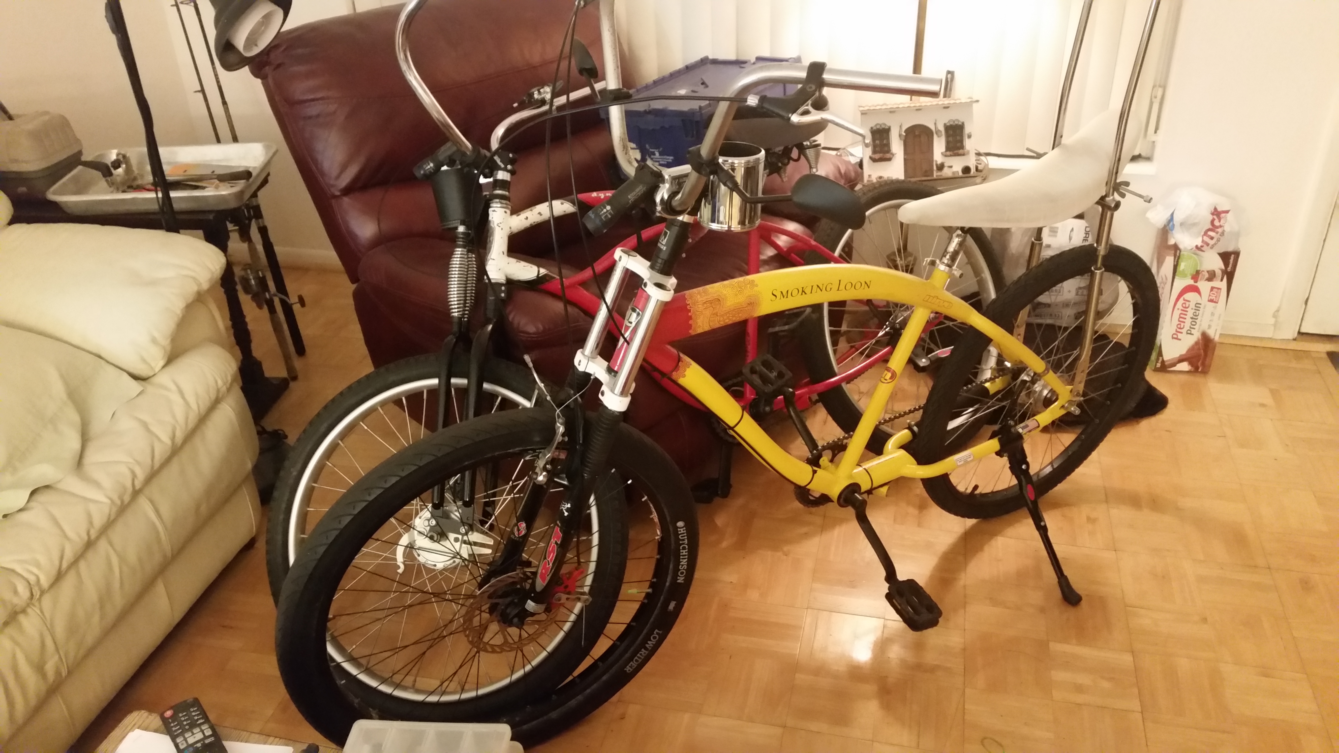

Thanks I already have a set of sunlite dual springers(the really tall ones that fit occ choppers. Ive got the fork worked out with a headset spacer and a dual bolt seatpost clamp to raise up the crown race). Lucked on to the forks for $75 on amazon.
I have a set of wheels from a Worksman urban Commuter I got the entire bike for $125. The wheels are stupid thick alloy with 11g SS spokes. Front wheel is a worksman sealed bearing drum brake hub. The rear is a 3 speed nexus with trigger shifter!
Im making a custom seat that will sit in suspension sissy bars (been brain storming ideas of how to make this have a sweet rear suspension)... any ideas?
If I dont go 49cc 4 stroke & SBP Shift kit I'll go electric and still with shift kit.
The Dyno is actually my next build right now im working on a Nirve Smoking Loon promotional bike. I put downhill triple tree suspension forks and a nexus 7 on it. Ive got my SBP 4stroke shift kit w heavy duty front freewheel and 49cc huasheng tapered shaft/ belt drive tranny.
Any way I'll start build threads for both and will definitely be referencing your work and welcoming any help along the way thanks.
You can see my place is a mess. Moving these to my huddies shop this week. These are just mocked up (and still need tweaking) just getting a feel for them. That banana seat was free just wanted to get the sissy bars I got for $23 on(they aren't going to cut it). I love both bikes.
