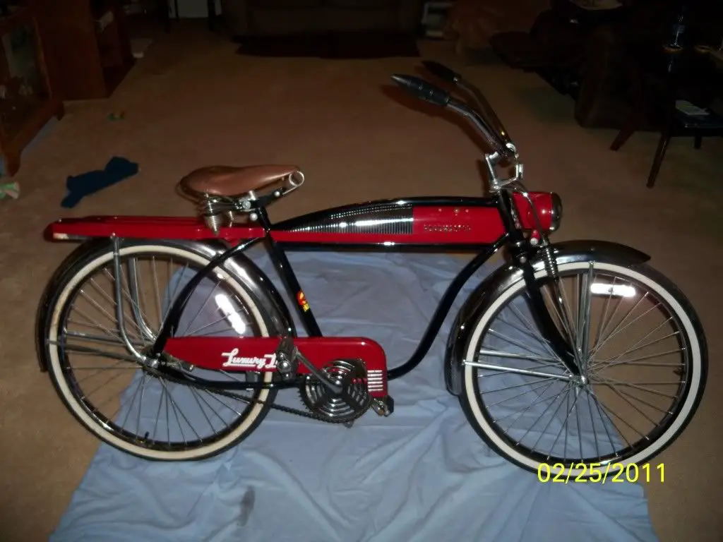

Haha, yeah and now that I am searching the internet looking for a pic of the Roadmaster I am absolutely kicking myself! I think the bike was probably a pre-war Cleveland Mfg bike with all the original parts and the patina. Ugh.
The bike looked something like this, but with alot of stuff like the fenders painted instead of chromed. The springer was like this one, not sure what this type of springer is called? It pivots right at the bottom of the steerer tube.
Looking into this a bit more, appears the fork is called a "Shockmaster" and apparently there are some on the CABE that feel this is the best, most well engineered springer fork design.

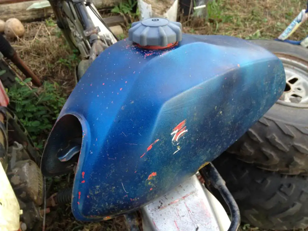

Took a small gamble today- bought a 1986 Kawasaki KD80 steel gas tank off ebay. Looks like this one (but crappier):
I had been watching another KD80 tank on ebay, along with alot of other small motorcycle and moped tanks. This one popped up and I had to buy it; $21 shipped includes cap and petcock. Of course it has some dents in it and I'm sure I'm going to have to de-rust the tank. I plan on trying apple cider vinegar to derust it. Hopefully the rust won't be too bad. It didn't look horrible in the pics and supposedly came off a running bike, but after recieving it I will post pics.
Fingers crossed this one will mate well with the Dyno frame and not be too big.
Pic of actual tank. Who knows how long the pic will be hosted now that the auction has ended:

OK, I received the Kawasaki KD80 tank. Not sure about it; soliciting all of your expert advice. Tank too big???? It does look like it shouldn't be too hard to mount it to the top tube.
It is big. I wonder if it would look smaller in black. The blue really jumps out at you right now, or is that how you want it? You wouldn't need to gas up often. You might just need to use it for awhile and see how you feel about it once you're used to it.
