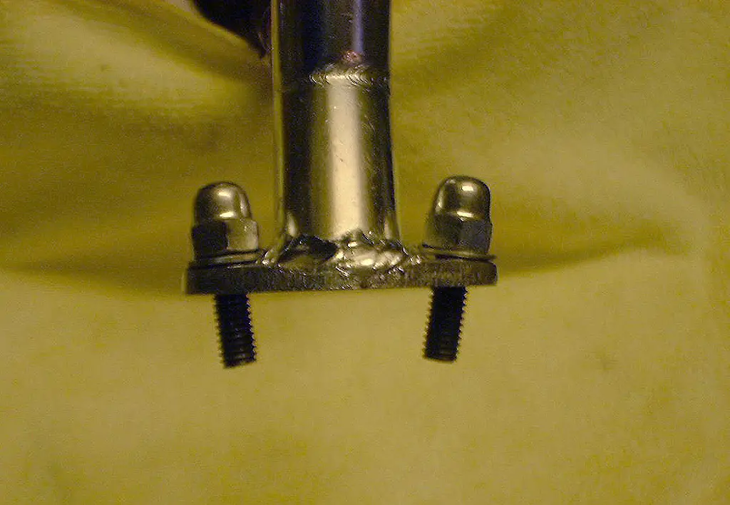

If your studs look like this (see photo) you are tightening way too much my friend. You can also see this if your tube is wider then the studs.
Bottom line is if your studs look like this...something is wrong and your most likely gonna have broken studs over and over like this guy.
Another cause for broken studs is mounting. If you dont have your motor mounted properly you can keep breaking studs over and over.

OMG...Just a little mechaincal common sense, please?
Dave, I've seen those kinds of things before. The same goes for intake and exhaust flange fasteners. The welds on a lot of them will not allow the fasteners to lay flush so they get bent, like your photo, then the guy wonders why he keeps breaking fasteners.
How would you think that doing that was a good idea. How are you supposed to get the motor off for service WITHOUT breaking them. People really dont think do they. I have to constantly tell people how to not start an electrical fire in their house cause they want to do it "their way". Darwin we need your help!!!

Ouch, Dave, that is a nasty pic, why didn't the guy use some of the washers in his megastack UNDER the mounting plate?
those 6mm studs are too small anyway I replaced mine with 5/16-18 studs
as they will shear even if mounted to a shift kit plate thats perfectly flat.
mine sheared at the death race and couldn't finish the second heat or get into the main for the third race in a row. I've had it with the china motor gonna try a morini hope it holds together !!! or my racing days are over cause I'll be to broke to replace it!!!!!
