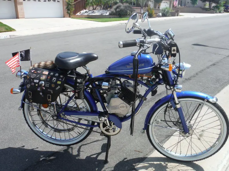

I’m pretty sure it is going to work and I don’t mind having it on there for the Grange race in April.
I have another appendage hanging off my bike up front. There is nowhere to hide all the wiring because I can’t hide it behind the stock Whizzer fork. I’m using an aftermarket Crossbow/ Monarch fork just for the look. I’ve spent a few bucks trying to get the look I want on this bike so I will be rewiring and a few other details after I win this race, oh yeah! Jim

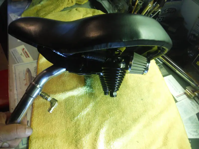

I would like to share with ya all how to make a COOL looking (C.A.O.S.) crankcase air oil separator breather for your New Gen Whizzer.
The PVC or the Big Rubber Hose C.A.O.S. looks very homemade.
I guess that's why people say that it makes the bike look like it's on LIFE SUPPORT.
The C.A.O.S. Breather concept was invented over 100 years ago.
When I first got my NE-5 Whizzer in 2005 and the stock vent hose would spit oil everywhere I knew something had to be done.
I looked at all the C.A.O.S. Breathers available on the market for Motorcycles, Scooters and Motorbikes. I didn't see any that were COOL enough to mount on a Whizzer.
So of course I had to design my own.
Here's what I came up with.
I call it the Seatpost C.A.O.S. Breather.
I'll explain how to make your own
Make a COOL crankcase breather for your New Gen Whizzer.

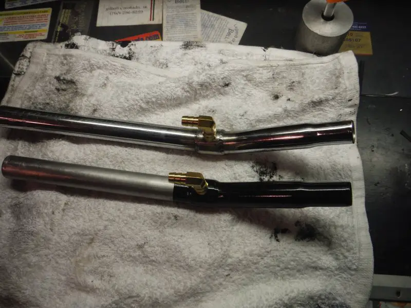

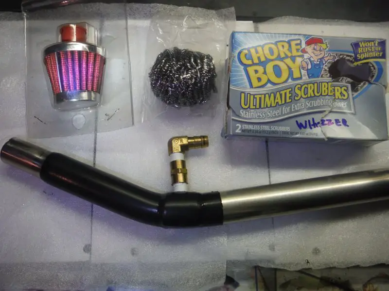

First cut 1" off the bottom of the Chromolly seatpost.
Then cut and spread the piece to slip on over the seatpost.
Now TIG weld the piece in place with stainless steel (for support) stainless steel and chrome go good together.
A welding shop should only charge $20 it's a small job.

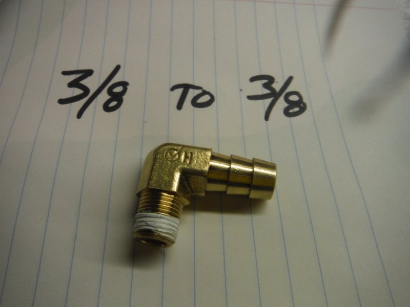

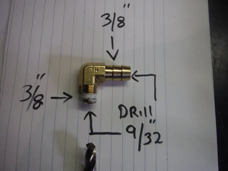

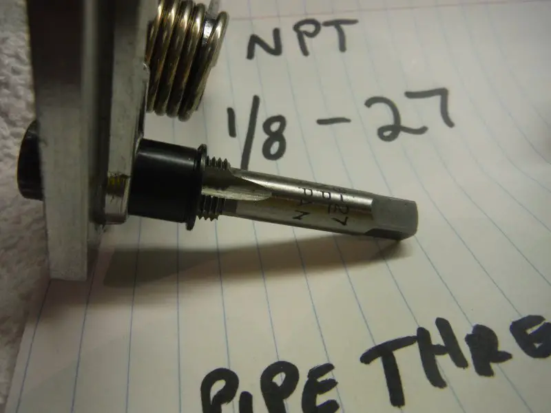

Next drill and tap a hole for a 3/8" hose fitting.
Seal inside the seatpost with a 7/8" rubber stopper and epoxy.
Seal the inside of the seatpost right below the hose fitting.
No oil gets into bike frame. All oil drains back to crankcase.
Use 3/4 of a pot scrubber pad (air oil separator)

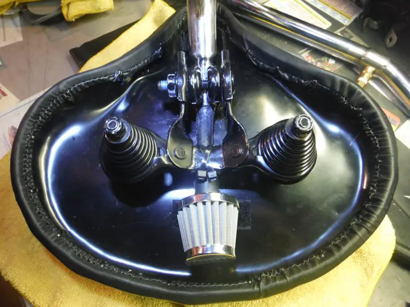

I have also attached a 3/8" ID hose to the top of seatpost with RTV silicone and attached a small breather filter up under the seat ( I like the look).

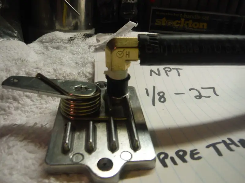

Howzit,
Some more info I would like to share.

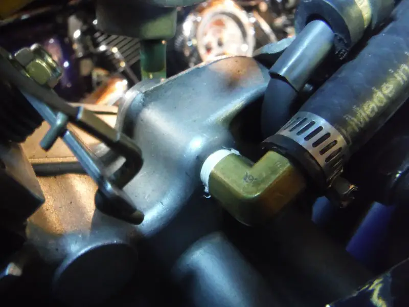

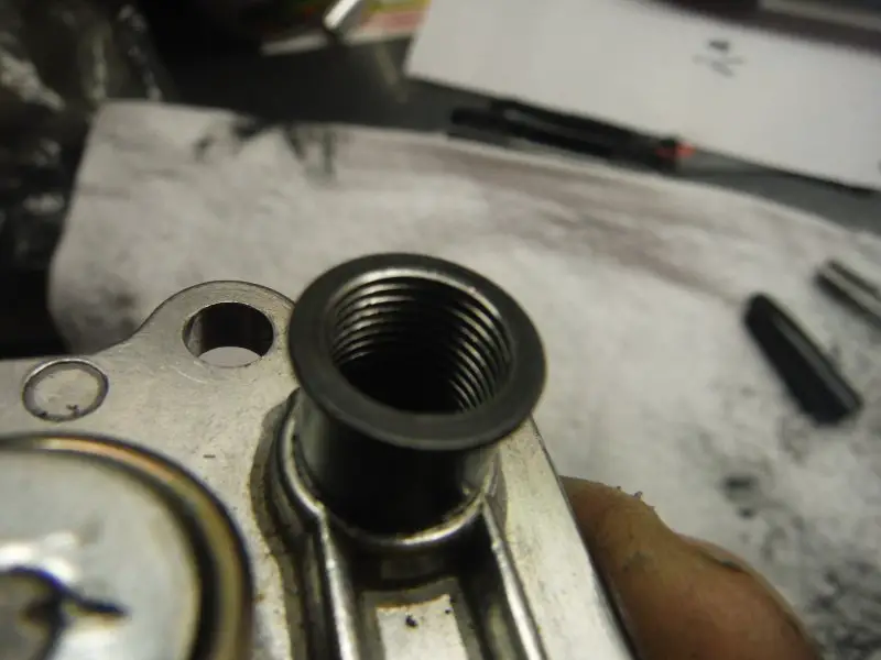

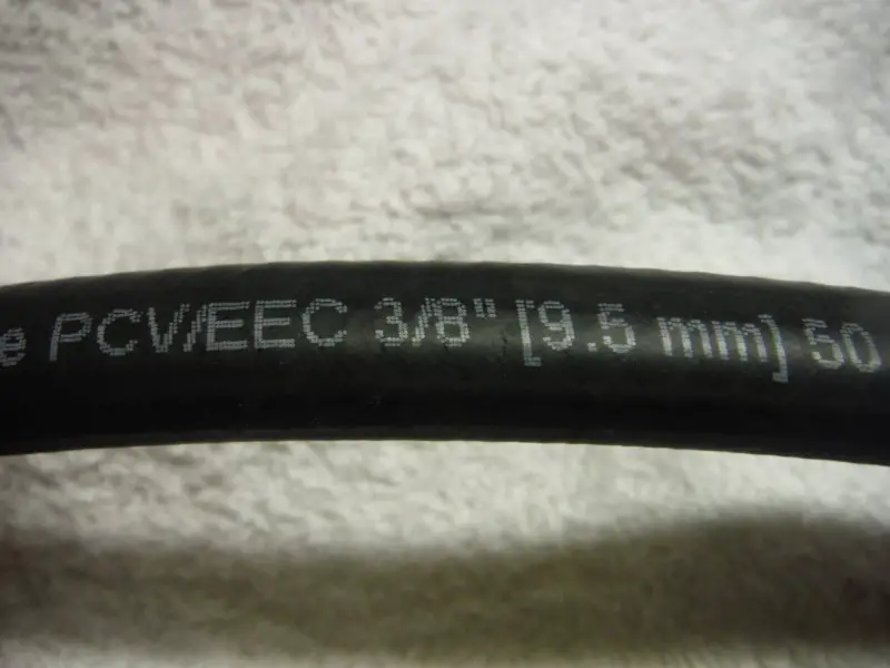

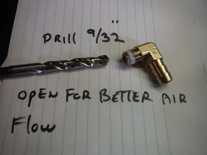

The 3/8" ID hose that I recommend using is too small to fit on the vent tube on the compression release cover.
I recommend using Made In USA NAPA hose 3/8'IDx5/8"OD

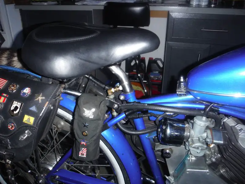

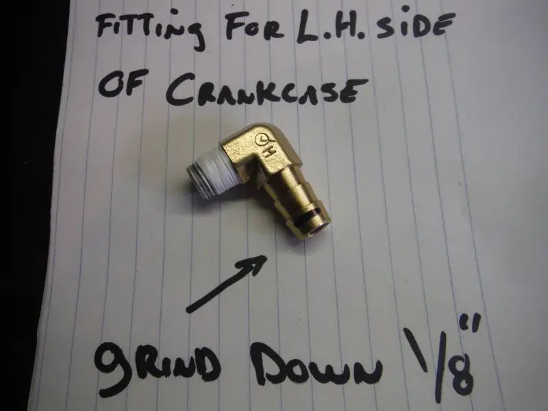

These pictures should explain everything to make it all work.
I also recommend using the left side vent port. As this vent port offers excellent oil drainage back to the crankcase from the Seatpost C.A.O.S. Breather. Plus assists in more air flow.
I suggest routing all hoses to run up hill. Oil has a much harder time going up hill.

I only use a small Breather filter after my Seatpost C.A.O.S.

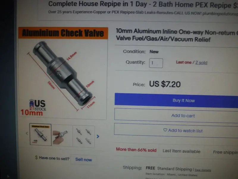

For those of you that want to use a PCV valve (one way check valve) after your Seatpost C.A.O.S.
There are many very very very low pressure one way check valves available on the market and will fit in line under the seat between the Seatpost C.A.O.S. and the small Breather filter.
