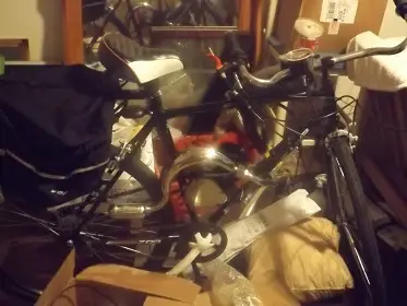

xct2View attachment 76818 heres the bike I built a few months ago I had to cut and weld the exhaust so it wouldn't hit the tire I also put 700c x45c tires and puncture resistant tubes it goes 43 M.P.H. with only about 60 miles on it but I only ran it that fast for a few minutes then only run it half throttle
