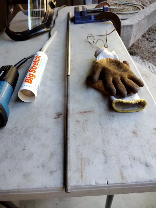

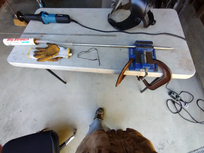

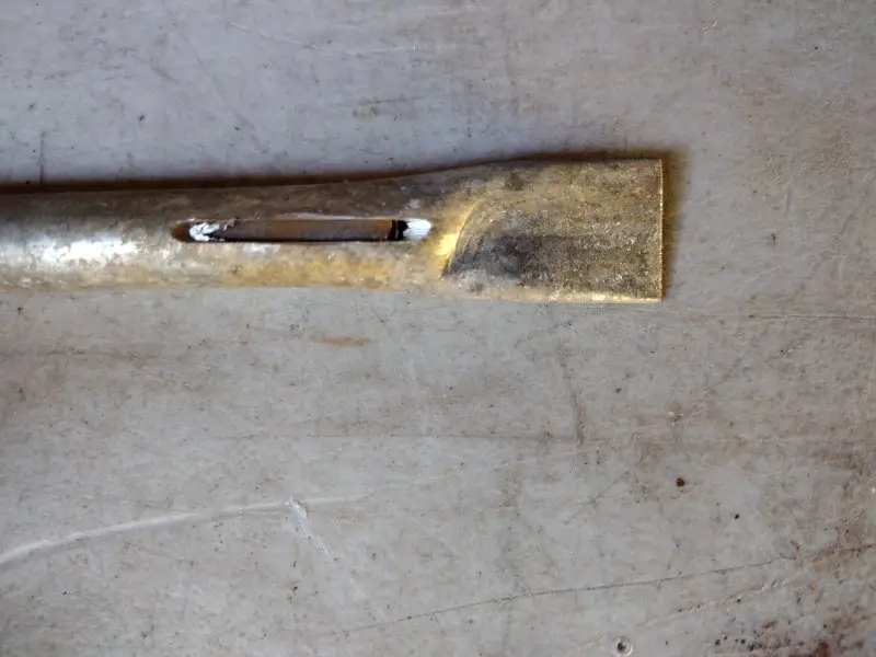

This setup is for adding some caulking in confined space between truck cab rear window and camper shell front window.
This is specifically for the area where the bottom of the shell meets the truck bed rail.
There is an area about 1/2 foot length where the gasket has pushed out. I can see it and can scrape it away.
Then without lifting up the whole shell, just leave it on the truck and add some caulking. If it does not work, then I'll pay 120 dollars an hour to a shop.
Car wash does not cause any leak, except for the ones that are the touch-less type with only high pressure water. The winter storms of snow, sleet, & rain last time had it leak.
Ten years original gasket may need complete replacement though?
One thing though is the die grinder I replaced with this new one is very smooth running. I tested it out officially!
PS: Use gas mask and ear plugs beside heavy work apron and face shield! Note separate speed control in use. Warning on unit about the small cut off wheel should not be run full bore!
The flattened end also serve purpose to scrape bead into area. Have not gotten around to putting it to use yet, but will before rain starts as if it fails I need to schedule the pros to empty my wallet some.

The idea for the caulking gun extension was a not a complete flop. The viscosity of the stuff would not allow it to work. If the caulking material was the consistency water, it would have. The vinyl tubing, I had between the caulking gun and the metal tube with larger inner diameter was along what did work. Still, it was not easy to get it smoothed out well in the cramped space between cab back window on pickup-truck to fix leak in shell forward seal on bed rail, but worked. Cleaned excess and am letting it dry a few days. In 2 weeks may see about a test with garden hose

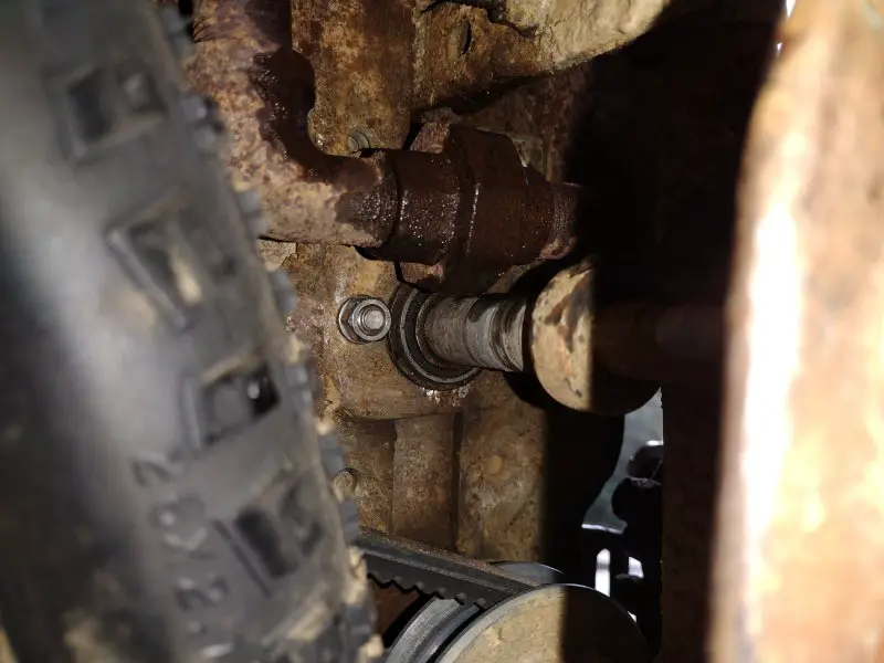

The rusted exhaust pipe I made for my motor bike with cast iron water pipe parts needed lots of penetrating fluid. Messed up my hand using a channel lock pliers. Vise Grip was a bit hard to fit without taking more stuff off. My hand is a lot better now.
The long Allen wrenches also had me use the pliers on the end to get into tight spaces. Yea probably voids warranty, be eh! I was so amazed when the union-coupling loosened up with vise grip and a huge adjustable wrench.
Next time wait for the penetrating fluid to do its job, else 5hrs work. I mean if it would have been just half that time, I would be happy.

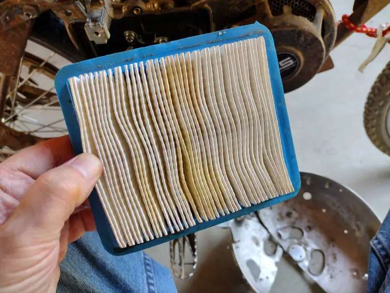

Pss from wrong way fuel for short moment during compression stroke. See filter picture. I would turn it upside down and get as much use out of the filter. But that is not going to get the compression back to normal. The oil bath filters don't clog like paper ones. Foam one I made not as good as paper when valves are in adjustment. I remember hearing a fluttering sound on a different engine where out of time valve would blow back into carb and suck into engine, this is what ratteled the carb butterfly of choke.

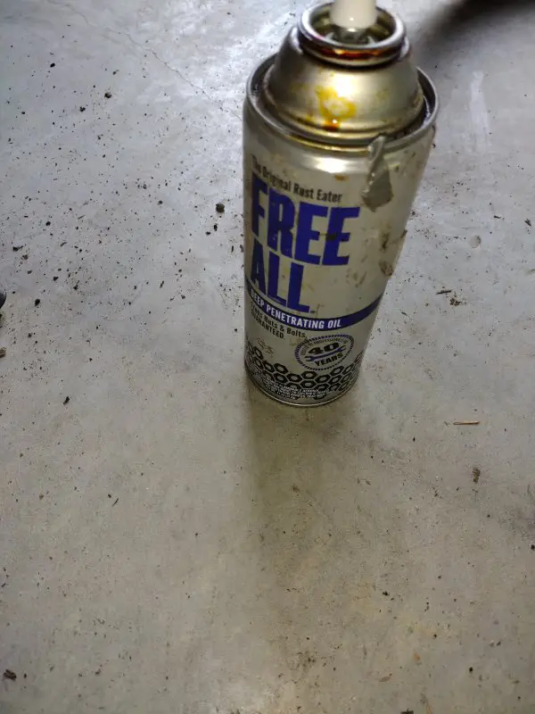

Freeall is good stuff. Less stinky that Liquid Wrench to free up rusted parts. After overnight outside no stink at all. While rain is to start up for a day, I could work on it inside maybe.

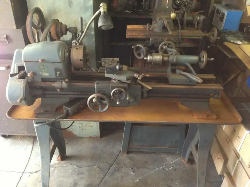

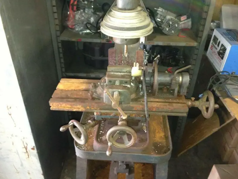

I'll just jump into this thread & repost from the other....
Here's my old lathe & mini mill that I bought from a friend when his father died... (this is what they looked like the day I brought them home).
They both needed a little cleaning up, but they both still work great & I also have several boxes of bits, replacement parts, & specialty tools for them for making special parts.
