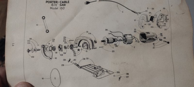

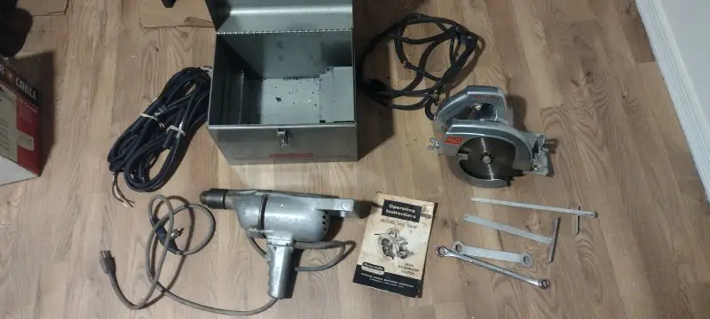

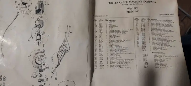

New in the box from 1956... Used once to build a 12x20 camp in '58 on lake moxie by my grandfather
'mossie' after most of the pieces were pre cut and brought in...
And a Sears and roebuck drill that I don't know much about from about the same time...
I have to replace the cords and looking through the booklet they offered an electric hedge trimmer that would have been something that would rival a Texas chainsaw massacre
A little history about lake moxie... Ted Williams and Bud levit would fly in and to go fishing and stay at my uncle Elmer Williams camp before my time... I got the stories told many times... A few years before Ted died he was caught on surveillance camera taking a piss in the parking lot of LL Bean... Most of my relatives worked there and retired from there... He was a real A hole along with the rest of the Williams Crew and he used a corked bat to get those amazing records... And they fought constantly as the story went Ted got thrown out of camp and Bud levit had to save him from my uncle or he wouldn't have finished his last season and had to stay at my grandfather's place until they sobered up enough and flew out the next morning my grandma was a Williams but died a few years before I was born... After the big fight and everything my grandfather never let any alcohol in his place after that...

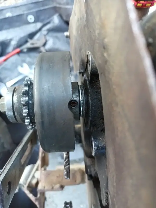

Other thing I figured out was one chain I have with the dual chain jack shafts, the one from engine/clutch to top jackshaft was getting where it was not moving smoothly. This clutch I got did not have enough room to fit an allen wrench to tighten the set screw on the clutch. The clutch that was given to me may have had the bell replace that was a bit bigger in one dimension.
I was able to see where someone had ground a spot on the edge of the bell to compensate and allow tightening the screw if you turn the bell to that position.
The key in the keyway which was somewhat loose, and the set screw is not use, means you have just the end of the engine crankshaft bolt keeping it together. It being this way had at low near idle rpm where clutch was starting to grab shake the chain excessively.
An over size key ground to be snug with set screw on key and also crankshaft end bolt is what up to do now. I hope the sprockets are not damaged and will get to it for the next ride.

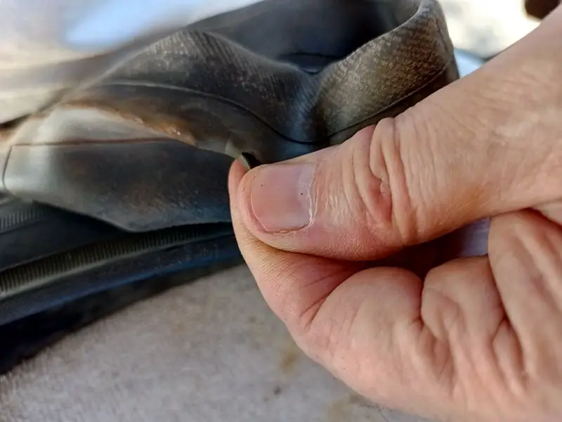

Oh yea, the bike tires are really not made to work in silty trails and roads. Scary and stopped and walked over rock maybe 1 to 2 time the size of a pomelo. I walked 10 feet over these sharp rock pushing my bike with engine off.
Hard time starting engine but did the road loop OK. Then back to camp where the tube was half deflated in a perfectly good tire. It was not a puncture but a pinched dried out tube material. Glad I did not fall with the air some what deflated. No walking the bike with flat tire or repairing on the trails.
