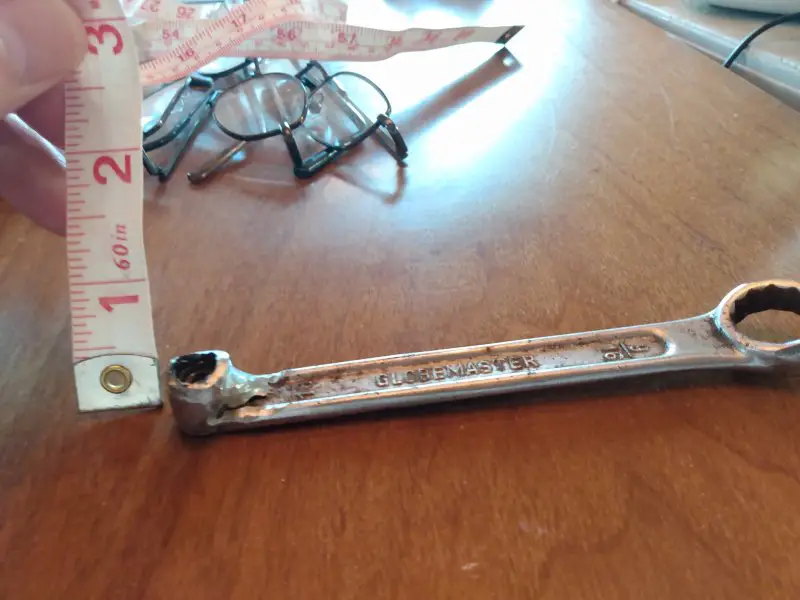

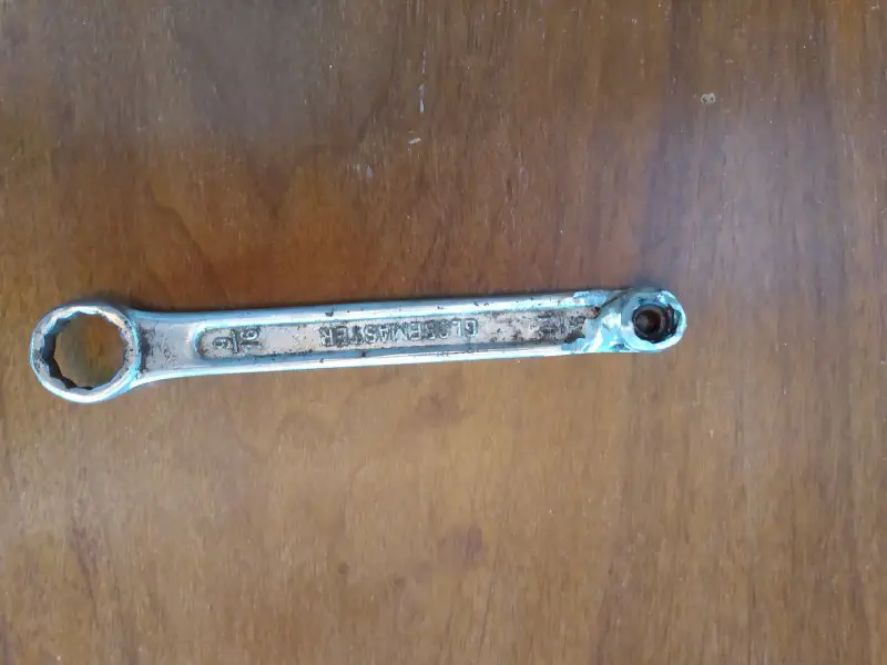

I welded a socket onto the end of an expendable wrench. It was so I could get into an area on an old sewing machine I got gears to replace on it. I had to cut it's depth of the socket a bit more when it still would get into the area needed to loosen the bolt holding in the upper shaft. I cut some off and though a bit too late, I could have beefed up the area around the socket with a rosette weld of sorts. I didn't think of it then. The socket then was able to reach inside and grab onto the bolt head. Only so much force and no budging the bolt, but yeah the socket rounded a bit. Still not giving up I took to die grinder cut wheel and opened up access to the access hole to the bolt head for a regular socket by wasting some of the casting in the way. It was a good idea and I also tried to guard the grind/cut dust with towel an tape. The I had a bear of a time loosening the bolt and it came out. The shaft was seemingly press fit as well. Here is where it would have also been thinking better with like a flywheel puller kind of deal in reverse. With the shaft sticking out one end of the machine and grab it and brace against the end of where the flywheel was removed and pull the shaft out. I did not do that at first and tried with a screwdriver in between the casting frame and connecting rod on the shaft. When I did not see till later I had also pushed on another smaller connecting rod and cracked it. SO BE WARNED. Anyway I have 2 extra gears that I can sell on Ebay, and a new machine on order. It has not just feed below the foot plate, but a so called walking foot feed on the top surrounding the needle. Thick material and multiple layers are handled much better. The walking foot works on forward and reverse as well as straight and ziz-zag. Really though the welding and grinding equipment I have has now been tested and still works! I actually got a nice sizzle sound and didn't melt the parts I custom made. It is just they modified the machine and didn't allow for easy service. The access hole for the bolt was off diagonally and had no chance other than disassembling a lot more intricate machinery. I bought a 3 yr extended warranty on the new machine. Otherwise it is 90 days and after only parts to 25 years. You pay shipping to them, they pay to ship back. Extended warranty pays both ways parts an labor 3 years. I'll leave it to them to fix should problems arise.

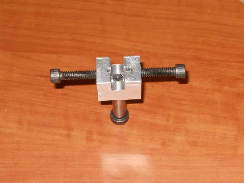

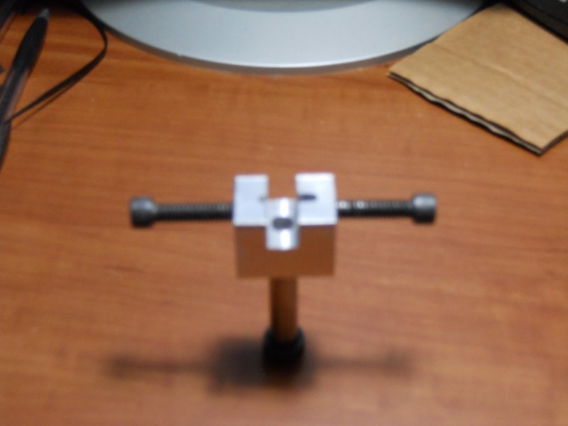

Inspired by the brake arm anchor of the 1914 model 10F HD, yesterday i did the layout work on a block of 6061.
Today, I set up the block in the Bridgeport vise, using an edge finder I established the center line. From the end of the block, finding the edge, moved in 5/8" set zero in X and Y of the digital read out. the 5/8" move was to generate a 1/4" web.
Center drilled and then drilled thru 1/2" dia., followed by a 3/4"dia. end mill through the block. The 3/4" bore matching the 3/4" dia. of the chain stay leg. I calculated in an excess amount of material.
You can take it off but you can't put it back on.
Unless you are a good welder. Another digression. Early in my apprenticeship I was turning a piece in a lathe. my measurement was off by ten thou. so I dialed in another ten and the d@mn thing got smaller.
The brake arm hanger cannot be centered to what I am making unlike the 10F. The Flyer chain stay tube is pinched and swells to hold the axel hanger. This whole exercise was to eliminate the usual hanger strap.

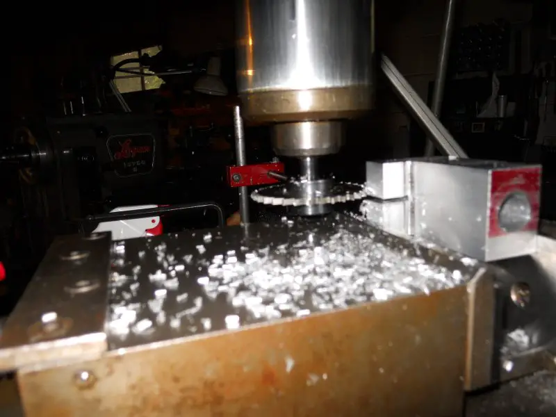

Was in the shop yesterday to sort out how to produce a 1/8" wide slot in the smaller section of the photo above.
Turned out the only 1/8 long end mill I had has a 3/16 shank. Well $hit I ain't got no R8 collet to fit it. Back to the make do.
Got two 3/8 collets. Dug thru my emergency adaptor bushings. Had one with a 3/8 OD but .175 ID so to make it usable I had to run a reamer thru it. Forward today. chucked up the 1/8 two flute endmill and started .025" plunge cuts.
That lasted three passes. Started the fourth and PING!
Plan B should have been Plan A. Got out the slitting saw arbor and a 3" x 1/8" wide slit saw. One pass to depth, done.
Still a lot of work to do on this part creating the clamping features, brake arm hanger holes, all the profiling, and drilling and tapping.

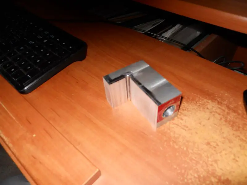

Got the brake arm hanger hole drilled but not tapped yet. Started the metal reduction sculpting. Ball end mills of various sizes and flute lengths depending on where metal needed to be removed. Two beers. Should have soldered on. One more beer would have completed the larger profile reductions. Should have done it, Mona was ruffing up the resident spider population in our Wick steel shed. On her exit she seemed pleased. Sunday is August 1st and I am still dicking around.
