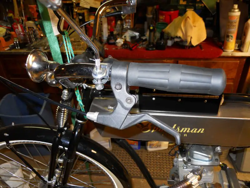

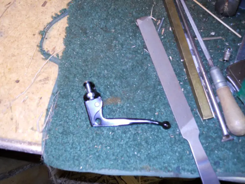

When I was building my Sportsman Flyer 80, I tried to incorporate left over components from the Huffy Davidson build.
One was a hand brake lever spare that activates a side pull rim brake. Functioned fine with the Huffy side pull brake.
SF 80 has a Husky front wheel Sturmey Archer XL drum brake.
The side pull brake lever never had enough cable travel to begin with, but over time and cable stretch 2020 front braking the XL was more wishing than stopping.
Couple years ago our Township recycle had unloved mountain bike standing by the dumpster. I salvaged the handle bar with goose neck complete with rotary shifters and brake levers, plus two sets of V brakes. (Big plans for the Huffy). Ha!
Forward today. Managed to weasel off the Donkey handle bar grip with a little help from ClearGlide Wire Pulling Lubricant, 1 Quart Squeeze Bottle. Think KY for conduit.
Once the grip was off, time to tackle the mountain bike lever. Once mounted the new brake lever gave the XL brake adjuster 80% of it's range back and much reserve lever travel once the brake pads are fully engaged.
So that was the fun had today in the machine shop. From left, new improved and replaced side pull lever.
