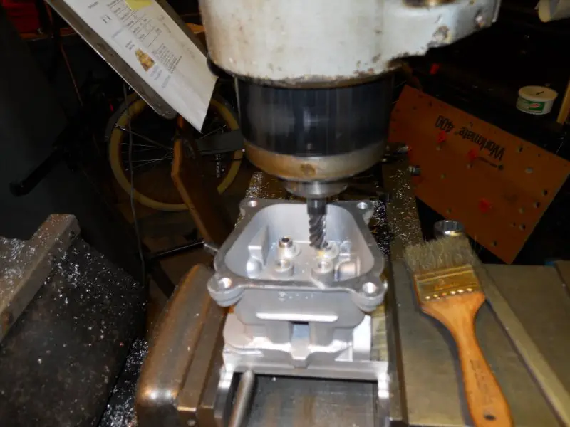

Drilled and tapped 5/16-18 x4 to mount the 79ccHF head mounting bolt holes.
Needed to mount the head on a tooling plate.
Once mounted and clamped in the Mill vise I was able to mill down the intake valve guide 1.9mm.
Allowing the intake valve seal flange to seat properly on the valve spring boss.
This was done after I pressed the valve guides flush in their respective intake and exhaust port pockets.
