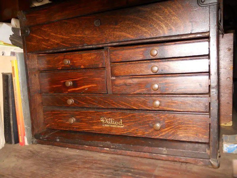

I acquired a Pilliod machinist tool box when I was searching for Gerstner chests to flesh out my home machine shop while keeping my Tool Maker Journeyman set intact. The Pilliod was encrusted with years of the crap we breathed. I kinda
figgered with out knowing that the original finish was lacquer as there was no surface checking. First swipe with alcohol brightened and further application cleaned to almost new.

Half alcohol and half lacquer thinner used with 4-000 steel wool. Alcohol softens the finish and the lacquer thinner cleans it off. Keep going until it's clean. It will need a new finish applied.

This is the tool chest Steve.
Paid $56 USD + $18 USD shipping ouch in 05 with no key. That is where the fun began.
After cleaning with alcohol only. See photo.
I removed the lock, clever mechanism. Two 14ga. hooks on activating rose and swung left and right into the lid recesses. Cute. I made a polycarbonate housing for the lock to watch the action, as I sawed and filed a key until the key cycled the locking mechanism freely. put the lock back in the case, closed the lid, turned the key in the lock.
Lid, sheeza no move. I have copied keys, but never made one to cycle a lock. When I die, some lucky dope has a key.

Perfect, Tom. You had to clean off the years of shop overburden and did that perfectly.. The few I did weren't that fortunate. They had to be rebuilt and I had to make the door for two of them.
I miss the old lock smiths and hardware stores where you could carry the chest in and they would dig through boxes until they found one. Good locksmith would look and know what type it was. Not today.
