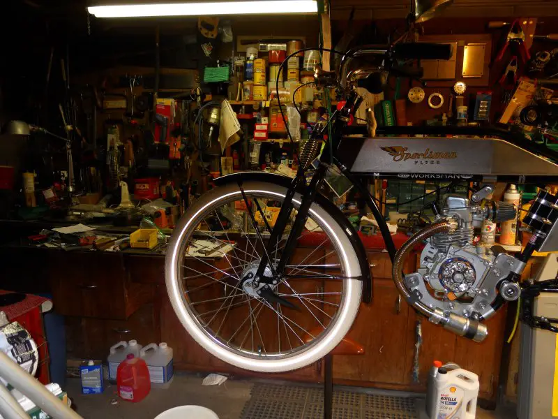

Was in the shop for a couple of hours today getting the front fender mount for the springer fork sorted out. Another hour will get it done. (photos soon) and then got the next 41b13 sprocket loaded in an emergency machinable collet and made one pass with the boring endmill. Tomorrow is supposed to be rainy so I will get more done. I really have to get the Flyer on the road before snow flies. I ain't getting any younger though I do my best to ignore the fact. Have fun guys!

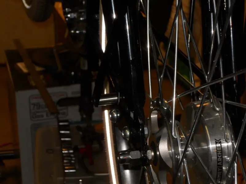

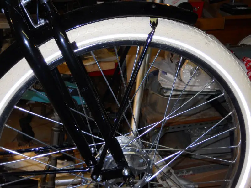

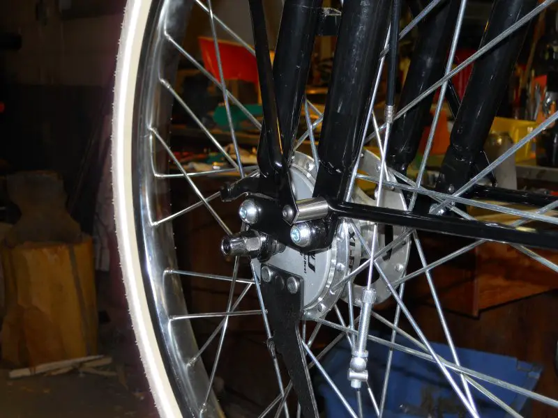

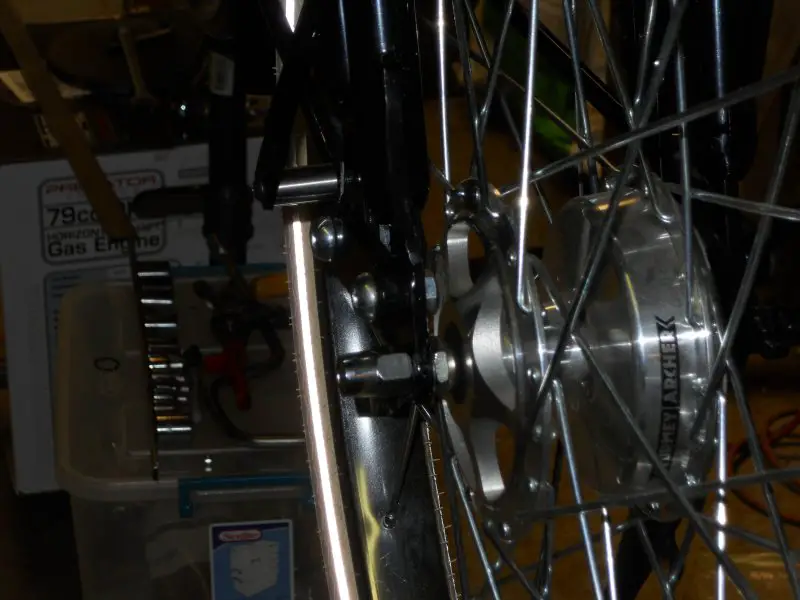

Yesterday, I made two 1" high stand offs for the front fender stays and bolted them up and I had more than 1/8" clearance with the axel fork so today I faced off .125" and still cleared the fork by at least .062" which is huge in a rigid assembly. Next were the rear stays and I knew it would be challenging and it was a bit. Not cutting 45 degree corners on the end of the stays until I made the cuts. But it is done and stiff and steady.

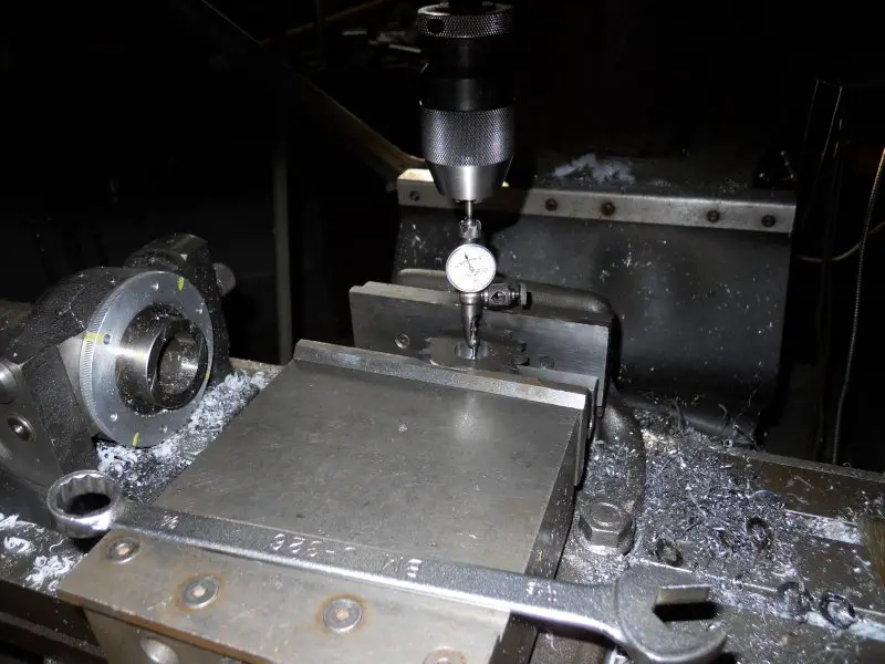

I completed the front fender installation by drawing up and locking all fasteners. That done I put the 41b13 sprocket in the mill vise and zero'd it in. Ready for tomorrow when I get home from work. I will drill and ream the bolt circle.
From using my 24" Lufkin blade I think turning .030" off the hub will make the chain line right and I am really getting tired of all this trifling around.

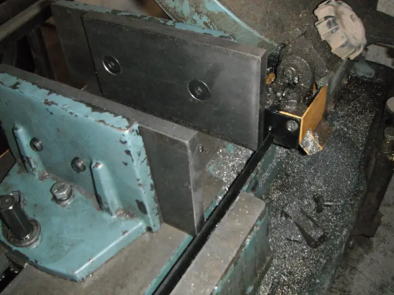

Got sidetracked from the bike making some extensions for the jaws on my band saw.
The stock ones didn't get within a inch and a half of the blade which meant I couldn't saw anything less than 3" long. I oughta be able to cut a quarter offa half now.
Of course another option on short stock is a parting blade on a lathe, but not on mine! It ain't big enough. Every time I've tried it the lathe gets mad at me and goes HONK!!
