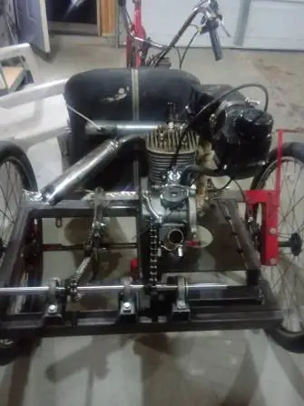

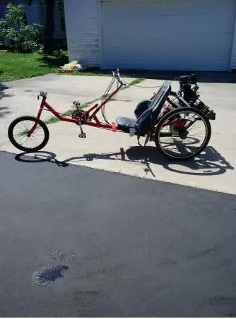

I was browsing through a Craig's listing yesterday and came across a fella's
recumbent build that is for sale. With the low-center of gravity it would be
better than motorizing a standard trike. I grabbed a few of the pictures.
Looks like a lot of work went into building it.
https://bn.craigslist.org/bik/d/bloomington-3-wheel-motorized-trike/6956245932.html
