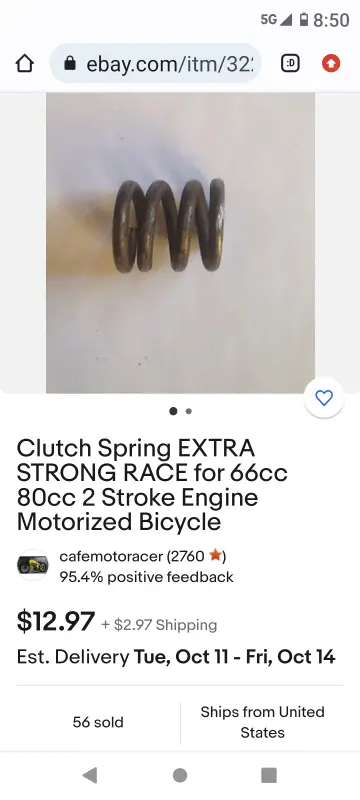

To adjust the spring you remove the cable adjustment from the motor and with a slotted screw driver inside there's a slot to hold and rolling the wheel you can get the spring to tighten and there's a stronger spring available
I did shave them so they would fit as best as possible. I used 320 grit sandpaper and very lightly sanded off a little bit of each side until it fit perfectly far as I could tell. Could it be because the pads need to break in and they don’t fully grab until they’re broken in? Thanks for the eBay link Mossy. I’ll check it out.
