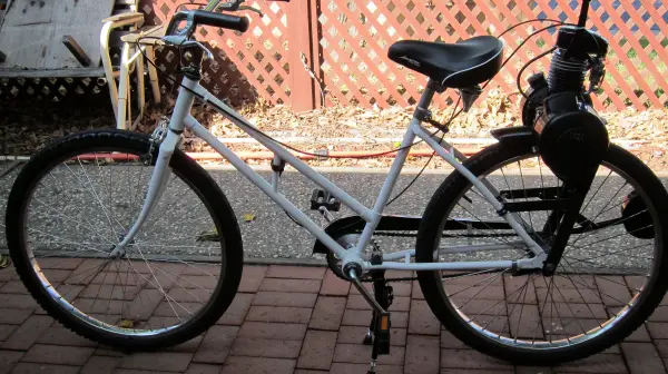

Here's mine;
Works great!
Much more stable on the back and the heat and the noise are behind you - :)
Nope, it's fixed. When I tried to raise it, it wouldn't move far enough to clear the tire. The muffler was holding it back.
In order to raise it I would have to remove the muffler, pull the motor back and run a bolt through the end hole of the slider slot.
I'm just gonna leave it fixed. Works great. Will run smooth at walk speed, hardly makes any noise. This is my neighborhood cruiser. Just pedal and off it goes. That cast iron cylinder takes a while to warm up though, you don't get full performance for like a half mile starting cold.
It's a hoot though and I really like it!
I have it geared real low, 36T on the pedal, 22T on the wheel, very nice for starting.
You came up with a nice clean install, I like it. In general my Solexes are cold natured too, take about the same amount of time before the choke can be fully released. Have any emergency disengagement proceedure in case of a far from home breakdown? It is amazing just how slow these things will run.

Yeah, rear mount is cool - :)
