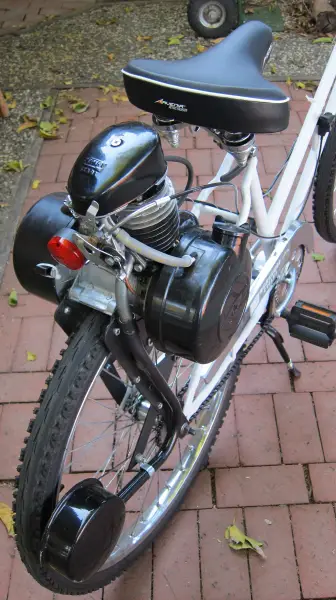

Thanks Mike B for another picture of your rear mount. I am just starting on my rear mount. I have been inspired by your pictures and the nice clean way you have worked out the mounting over the rear tire. I have tested out my clutch while stopping with the motor at a higher RPM. It does work better without the noise and roughness. I remember reading about this in a previous post but I had forgotten about it. Thank to everyone who has contributed. It is all helpful.

I think you'll really like it. I knew the front mount was not going to work for me. The bike almost went down twice when I was working on it when the fork whipped around with that heavy motor on it.
Yeah, heavy motor. Keep that in mind on your build. My main brackets go right on the axle. I wouldn't trust those little 4 mm fender support holes.

I have finished moving my solex from the front to the back. After riding for a couple of days I really like it. It is great to have that motor weight removed from the front fork. It now feels like I have power searing. I like the weight distribution much better. The bike rides better and is more quiet. Actually mounting the motor was easier for me. One added bonus is the center mounted kick stand supports the bike without a problem. I plan to move the motor to the back on my Trek bike.
