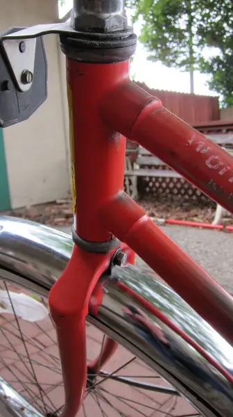

Hey All,
I just received my kit today. I am putting it onto a beach cruiser that I am fixing up. MB Dave,I really like your Solex clone too.
I am keeping an eye on ebay and will pick up a step through and do the same with it.
I will probably have some questions on the install LOL.
Adam

Hello Adam F. Welcome to the club. These things are soooo slooowwww.
Had a fella on a bicycle riding alongside me asking me how fast they go, I was going full throttle flat out and he was peddling alongside holding a conversation.
Best advice I can give for a trouble free install, is to use the older style forks.
The clamps will fit perfect. The newer round style forks with the rounded shoulder at the top may prove to be quite a challenge.
