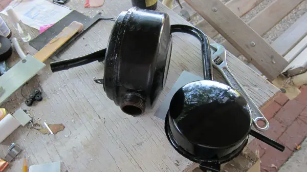

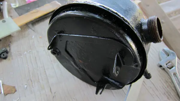

Here's the rusty gas tank. Rust on the inside, rust on the outside. See that rust I exposed under the blister? See how half the back of the tank is blistered?

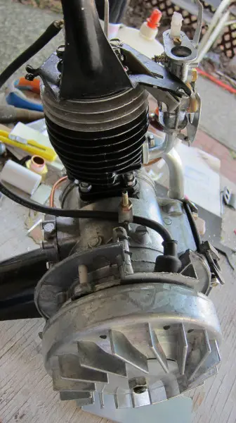

As I said, the motor looks straight.

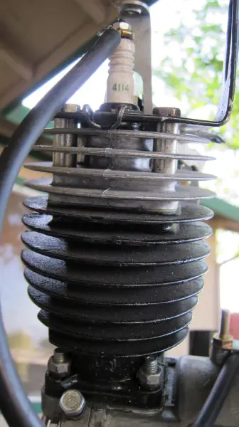

A 4114 spark plug
The castings all look very nice, much better than HT stuff.

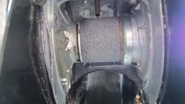

And here's the grindstone friction drive
I dunno, what do you experts think?
If its an original Solex it will have a serial# near the front of the engine case. The Hongdu doesnt. Also the Hongdu fuel cap is a female thread, I believe the Solex is a male. Sounds like a Hongdu with the earlier style roller. Seems they are all slightly different. The original as well as the Hd runs @ WOT and is returned to idle when the brake is pulled. I have set one up both ways and the WOT set up makes the best sense as that is where the engine lives most of its life.
Thats a Hongdu. At least you got a good cylinder casting, the roller is not like the Hds I have nor the original Solex I have. Pull the nut of the crank cover an see if there are points, my guess there is not.
Nah, no serial numbers anywhere.
There is a HD on the cast iron cylinder though, yeah, HongDu it is.
They must have got that rusty tank out of a scrap bin then. I did notice that one of the tank screws was not fully fastened.
I don't care, I knew it was China stuff when I bought it. The POS gas tank was a dissapointment though.

Some things to check. The compression releases have been too tight on both of mine, you may have to loosen the nut to allow the proper travel. If you switch to a long reach plug it raises the compression and the running is improved. If the plug in yours was like mine, it doesnt even come to the bottom of the threads in the head. The area in the head is so small that simple differences in plug dimension affect it. My first engine had one head gasket, the second had two for what reason I dont know. Depending on how far you want to go into the engine checking it, I pulled the head, lapped the compression release, and checked eveything out, just to see. All of these are different it seems, depending on who put them together and with what. Maybe these are rejects, or engines built from marginal/bad parts. My first engine was very good with only dents in the fuel tank, the second engine was nicer in most ways but had a marginal cylinder casting. I cant imagine this is a first run product.
Forgot to mention the sparkplugs. I am running a Bosch W8BC, a Champion L92YC works also. These are medium heat range.
That gas tank is about normal for these kits. Both mine were very scaly and rusty indide. They are ok after cleaning with gravel,being careful about the in tank filter and using rust neutralizer.
