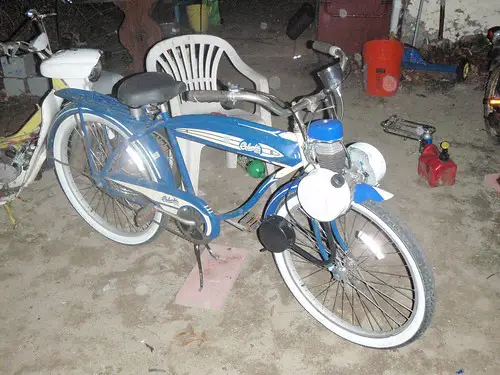

heres my solex copy engine on my 1951 columbia
it runs great but no power coming out of lighting coil seeing how rays lights work on his i might just ditch the whole lighting coil and just run the lights off a small 12 volt gel cell
Looks great! Has a really vintage look with the blue air filter cover and the white tank and fan cover. I have my light wired direct so it runs constantly. Have had no problems with the system. May be easier to go battery than to get another coil though.
the engine/light cover doesnt fit right so im gonna make a new one and put a different light on it
im not gonna ride it at night too much so this little 12 volt 1.5 ah battery should work fine plus the lights will be really bright
Nice bike Jay, I am looking forward to building mine.
I hope my coil works, I was planning to add a small red light for a tail light too.
