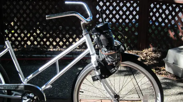

Got it mounted.
Need to get a smaller front tire, tire hits one of the motor bolts. Tire also hit the little plastic "archy" thing, so I ripped it off hoping I was done with tire hits. Nah, need a smaller tire.
Yeah, nothing fits right, typical China stuff - laff
