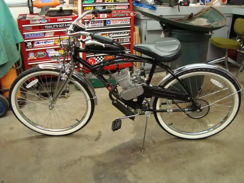

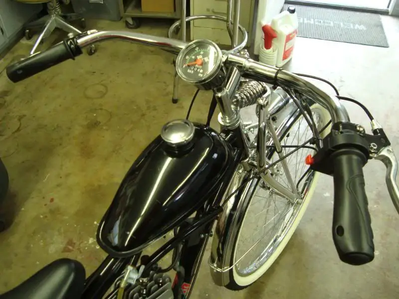

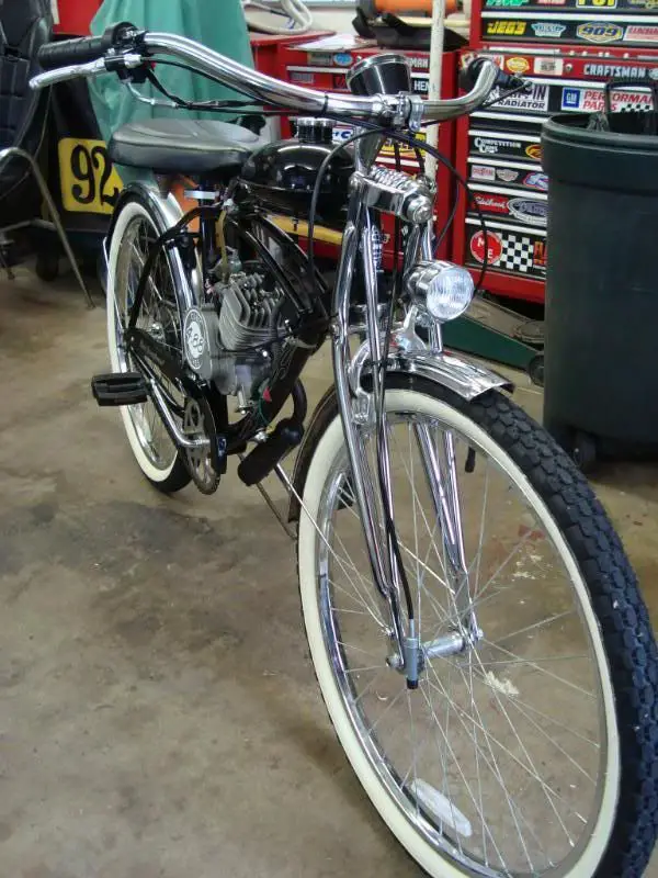

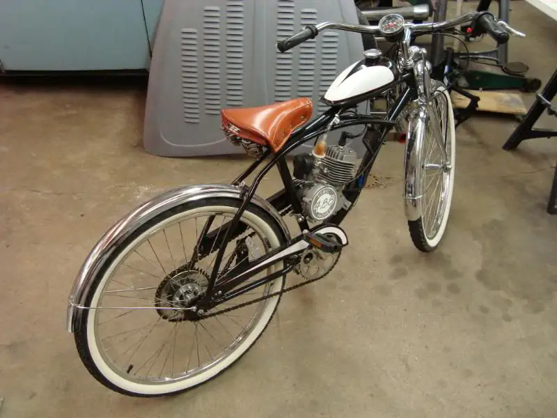

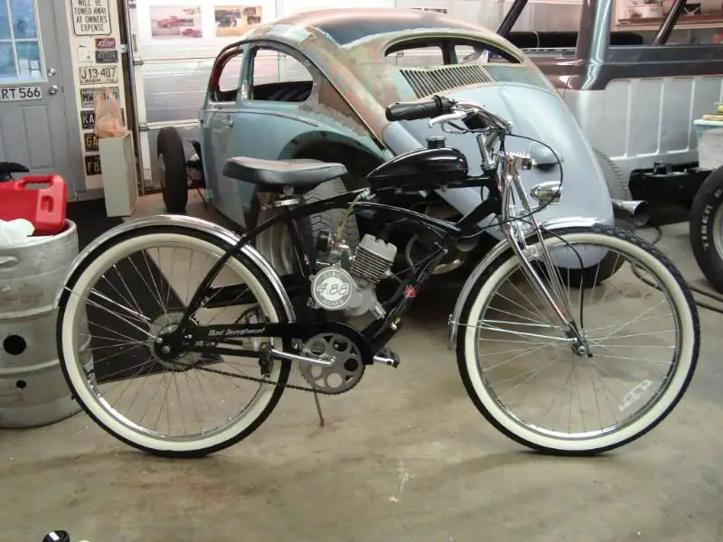

    Hello, My name is Gary, I am a graphic designer for a sign company and build hotrods and do custom paint and pinstriping, interior work... pretty much whatever. I have been wanting to get a bicycle or awhile to mess around with.
    Its a Huffy Cranbrook, I picked up the bike with the engine freshly installed on it for less than building a new one. When I paid the guy and loaded it up, I turned to my fiancee' and said, This is a bad investment lol, Hence the name! Since I got the bike, the chain broke, stuff fell off and I bought alot of fancy crap!
    I added a springer front end, front brake, speedo, I replaced the tensioner with a new one I got from a guy on ebay, he made spring loaded, bearing/sprocket ones, I just used the bearing/sprocket on the original tensioner bracket, made the chain alot quieter and smoother! I also remounted all the fenders and made them more solid! I made a sticker for the side of the engine case also & chain gaurd too.
    Next I want to get a rear tray for it, recover the seat in brown, maybe upgrade to heavier duty wheels, rework the exhaust and heat wrap it. I will repaint the tank and throw some pinstriping on it.
    I got lights for it, which I have not figured the best way to hook those up yet? I have read about hooking it up to the engine, or I have the generator that runs on the tire. Ideas anyone?
    Can you rework the pipes anyway you want or will effect how the engine runs? I kinda wanna extend the muffler to straight out the back.
    Any info/advice would be much appreciated!! This is my first one!
    -Gary

    Welcome to the site! Nice bike and i love the chopped v-dub. They sell longer pipes that come out the back of bike so you should be fine. We put one on a chopper bike that came off a pocket bike just cut and rewelded the pipes to fit frame,runs great. I use a 9volt l.e.d. headlight from - | BikeWorldUSA | Bicycle Parts and Bike Accessories and also the 6volt tail light they sell, ive got the tail light hooked to the white engine wire and it works great. You can also get little tail lights from a truck stop and replace with 6 volt bulb ,just get the lowest watt you can or it will not let engine idle and low speed without killing motor. Welcome to the money pit. lol

    Hi Gary, welcome to the site.
    NIce looking bike, you have a done a lot to it.
    I love how you named it, kind of like how people name their boats.
    I haven't seen a stock black cranbrook, mine was Champagne colored, did you paint it?
    Gary, Gary, Gary... You Don't NEED a Tensioner!
    If drive side tensioners were a good thing, motorcycles would have them.
    That link will help.
    When you get to chain matching from the pedal side, pop the stock 18 tooth rear sprocket off and put a 20 tooth on first. You will find that not only is the bike easier to start, your crappy stock rear hub coaster brake magically works well enough to lay a nice 'J skid' ;-}
    The white engine wire is raw ~7.5 VAC but it varies by RPM.
    With a diode and rechargeable NiCad batteries in a 6V light you can run that pulsed DC to it to charge the batteries while your ride, and the batteries will do the rest.

    Hi Gary I like the bike and looks like a fine investment. LOL One very important thing you need to know. Those fenders are very dangerous the upper bracket is so thin it will crack and break if that happens the small wire stay at the rear will wrap up the wheel and stall the bike throwing the rider. What I do with all those fenders is use a liberal amount of Silicone Rubber around the upper mount, so the fender is actually glued to the bike, or make up some extra strong brackets. I have seen too many posts about this problem and some gruesome pic's of the riders. Be safe and have fun, Dave

    Very nice looking bike, although I really don't like the way he mounted the engine. Keep a very close eye on the down tube for possible cracking. I NEVER drill holes in bike tubes..........anymore.

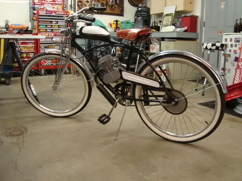

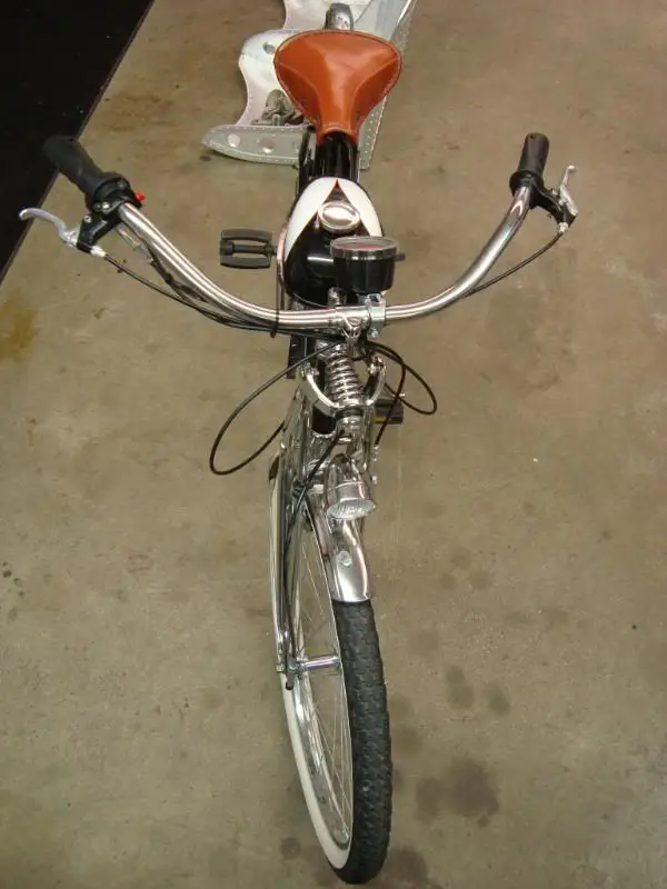

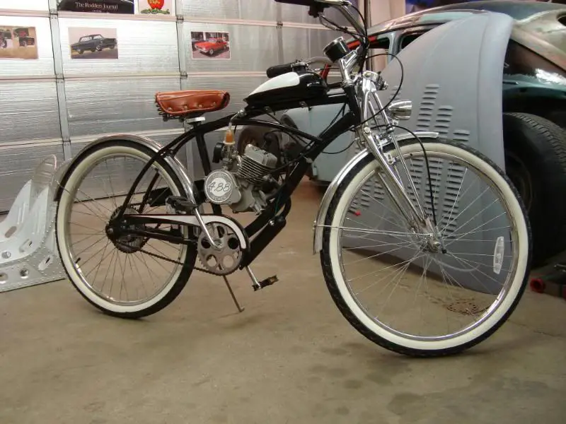

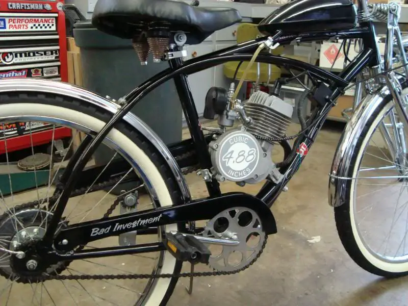

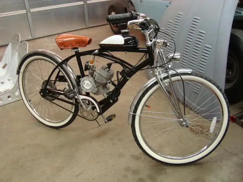

    Thanks for the compliments. So far its running great! After a little work and straightening out and fixing its fun to ride!
    I put front brakes on it, re-did the wiring on it, and made a headlight / front fender mount. Stole an old brown seat off a bike at my dads house. And threw a rattle can white paint job on it and some red pinstripes. I still need to figure out how to hook up the lights, I like the idea of a rechargeable battery pack type set up.
    Its dirty right now, I took it on a 10mile ride a while back and havent had time to clean it.
    Heres some pics, -Gary

    i'd say that seat completes the loook of the bike.
    is your rear spoon brake still operational?
    have you considered painting the clear fuel filter black or white?
    can you clarify your headlight/power source? i'm no good with electrical and am looking for a similarly sized headlight.

    Ya, all motorized bikes need two brakes. How did you re-wire it Gary?
    I'm curious as I sell a re-wire kit with a CDI ignition module keylock that replaces all the stock wire up to the neck for the kill button connectors.
    Nice job, it looks great.
