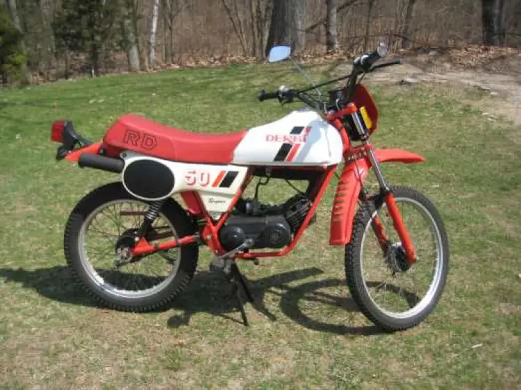

If you go on the 1977 moped site then you'll see there are 21" and 23" moped wheels. I am unsure what that translates into, in bicycle size... Here's the site:
http://www.1977mopeds.com/parts/wheels-and-tires/wheels.html
Of course, the wheels I'd be interested in are out of stock!
Ciao!, Mac-
Ciao!, Mac-
The 21" wheel that 1977 Mopeds has on their site appears to be the front wheel from a Derbi RD50. That was a dirtbike looking moped that was only made for a year or two. And the rear wheel was smaller than the front, probably 17 or 18". But I suppose if you could find just the rims you could lace up a rear wheel.
