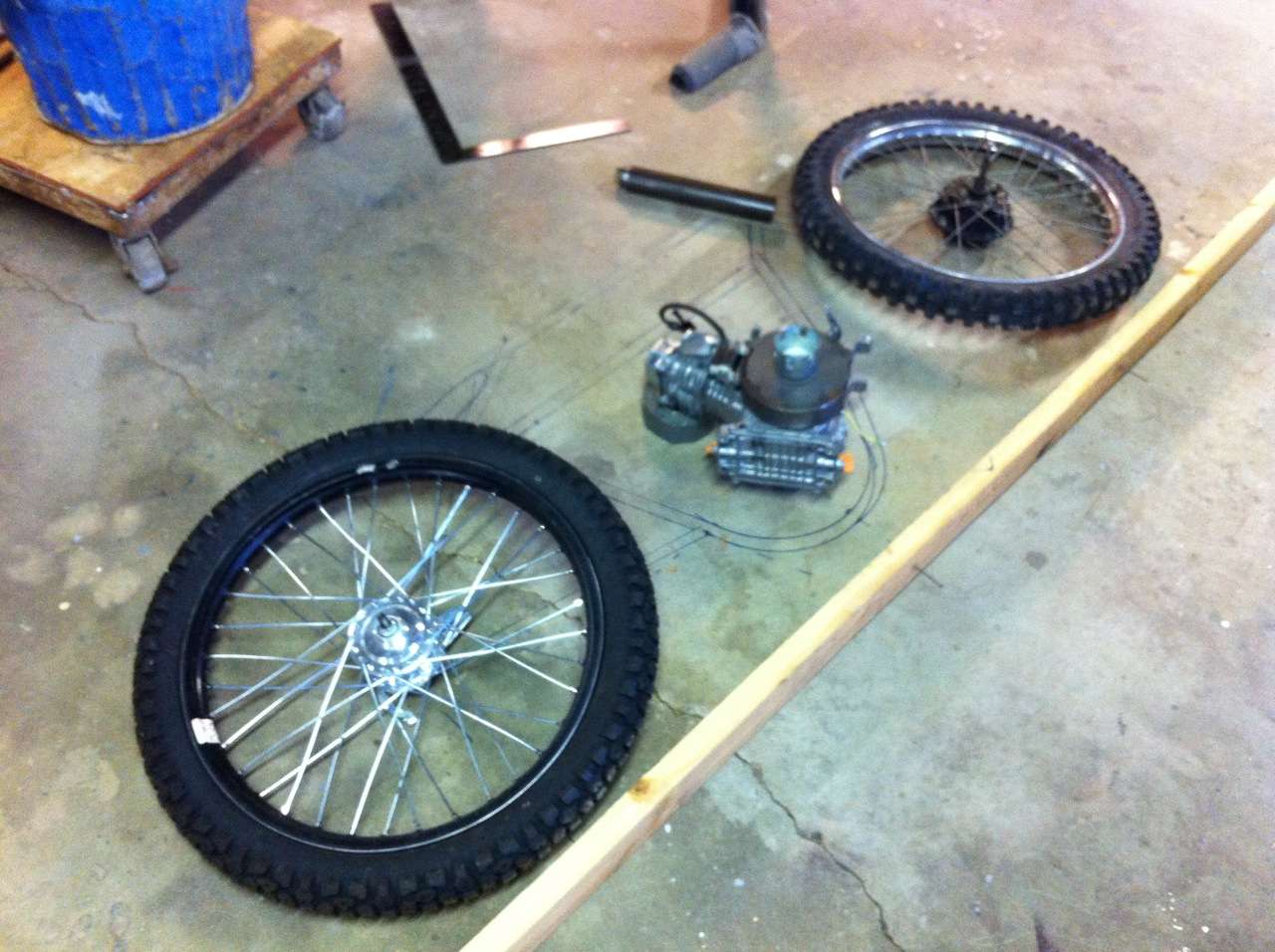

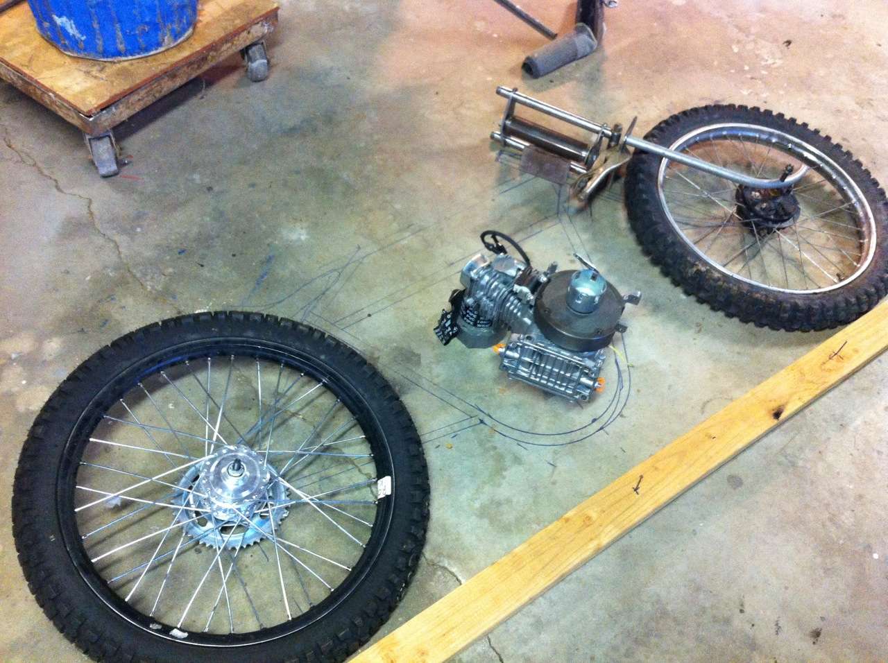

Finally ordering some tubing, 1" and 3/4" .120 wall Dom, I layed out the frame on the floor to help with making the bends, will hopefully see some real progress in the coming weeks...

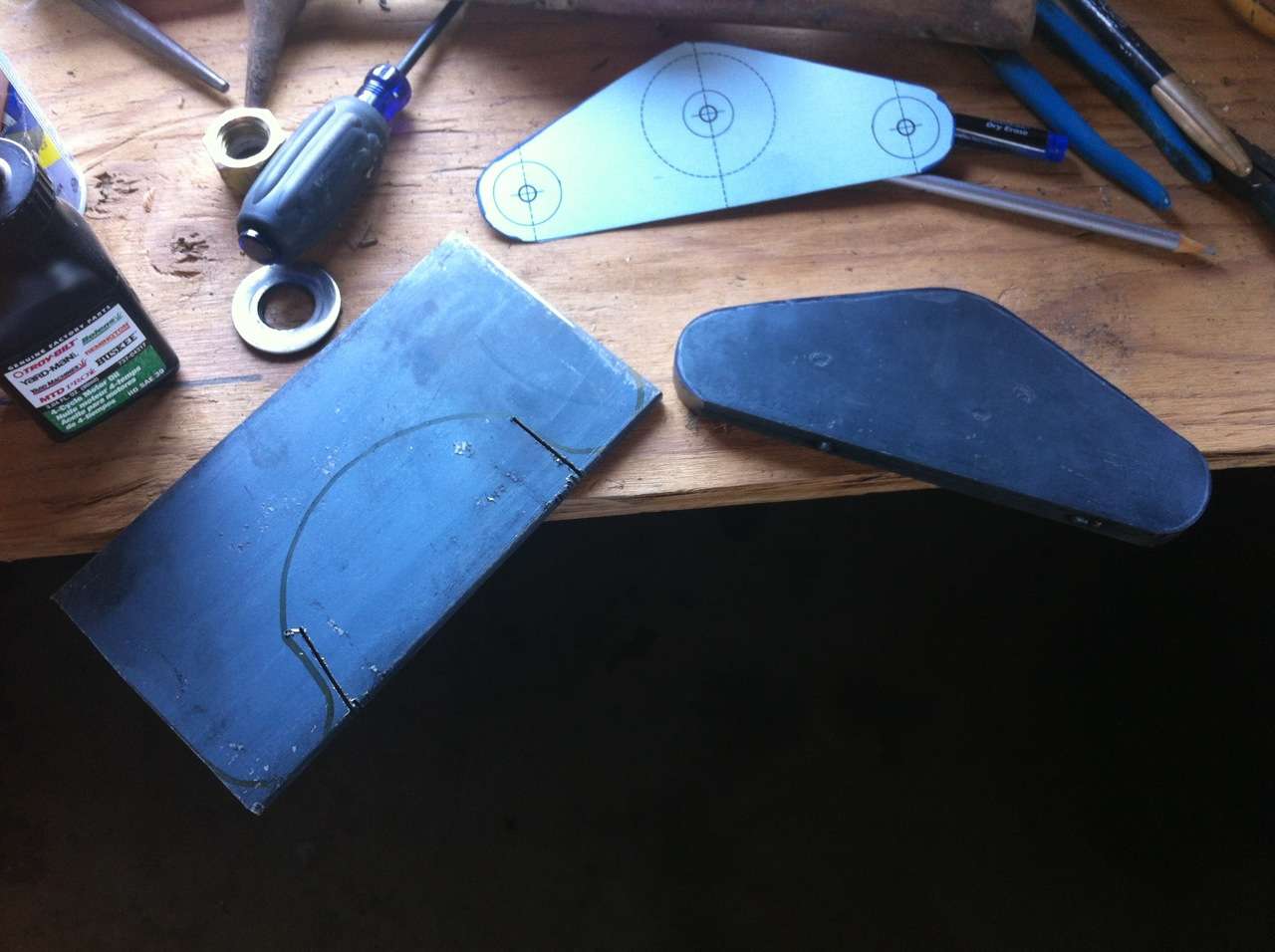

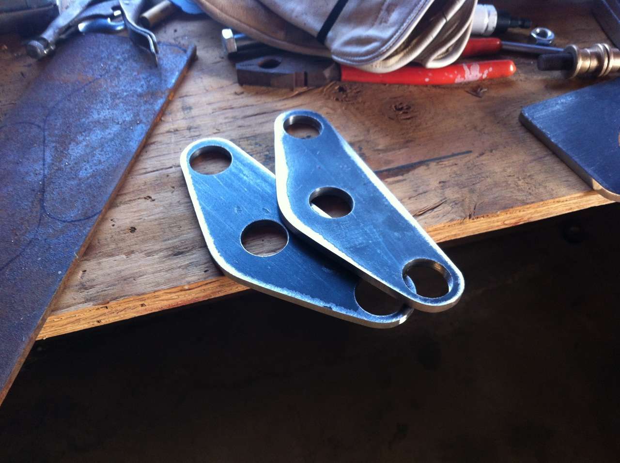

Got the metal, before I start on the frame I wanted to get the fork squared away since it's the most complicated part. This way I can still tweak head tube angle and geometry if the fork ends up a little different than on paper.
