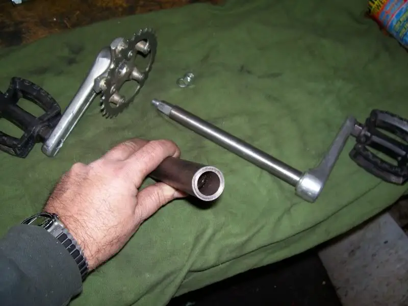

Here's what I have come up with for pedal gear...machined out a new crank axle, wider to clear the primary reduction sprocket...shortened the cranks by 2" and made up a new carrier tube to hold the whole thing...oilite bushings to support the shaft and the whole set up will be welded under the frame just behind the primary reduction spindle. When I get it welded in and the chain in place will post another shot.
