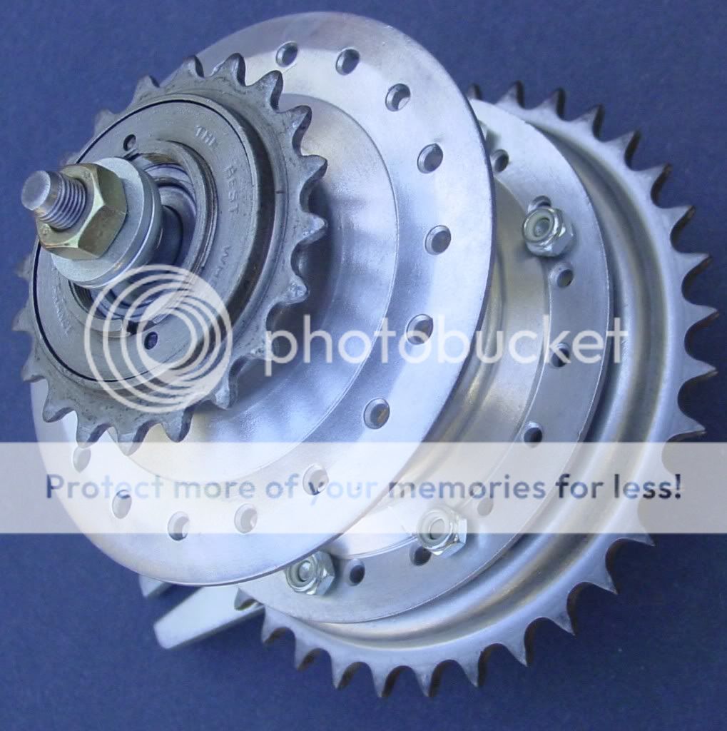

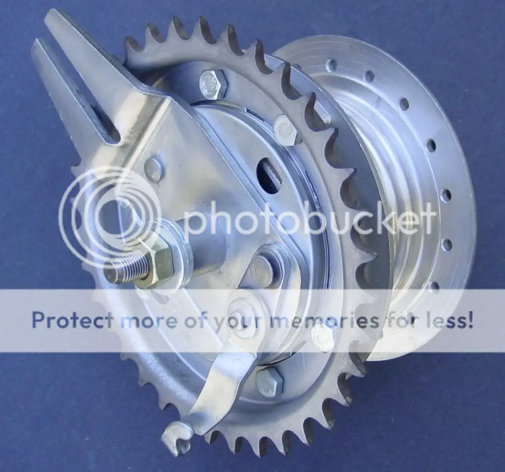

Totally my pleasure silverbear. Ebay's a great idea for sellling your extra parts. I've had no trouble getting rid of any 70's moped stuff. There's always someone out there restoring and in need of parts. The rear drum brake hubs with a bolted on sprocket are also cool, but it may not line up with a chinese motor because they're so outboard of center.
Ah, but it might line up nicely with a fatboy motor like the Harbor Freight Greyhound. Number of teeth on the sprocket might be all wrong, though. But another sprocket ground out to fit might work. Have to see one in person, so to speak. Thanks for all the great ideas. Love your bikes.

I want to thank you again for the moped donor information. I have since found my first victim, a 1980 AMF with good front fork and good wheels, brakes work, etc. I was going to remove everything to use on a Schwinn cantilever?Greyhound build later this winter but then got to staring at that weird little moped, removed the gas tank, set a used HT motor in place and discovered it is plug and play, as if they were made for each other. The problem with it was that the AMF was a rear wheel friction drive setup with no sprocket on the rear wheel for the engine to line up with. Then I got to looking at the photos of the rear hub you posted above and realized I can drill holes and mount a sprocket on there without a problem (I think). I'll find another donor for the Schwinn project having now developed moped radar. Many thanks. The little AMF Roadmaster will be a participant in the Rustoration 2.0 buildoff this winter... super low budget. I'm still hoping to use a rear moped hub to rebuild into a wheel specifically for the Schwinn/Greyhound motor which is wide and would allow me then to center the engine. I have a couple great 52 Schwinn rims to lace moped drums to. Do you have a source you'd recommend for 12 gauge spokes?

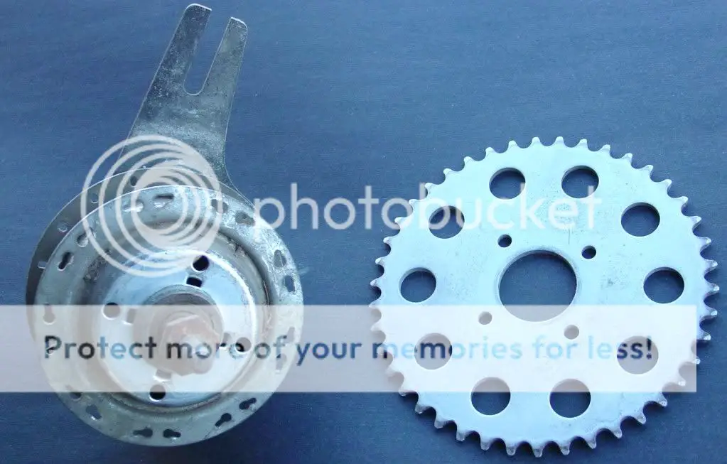

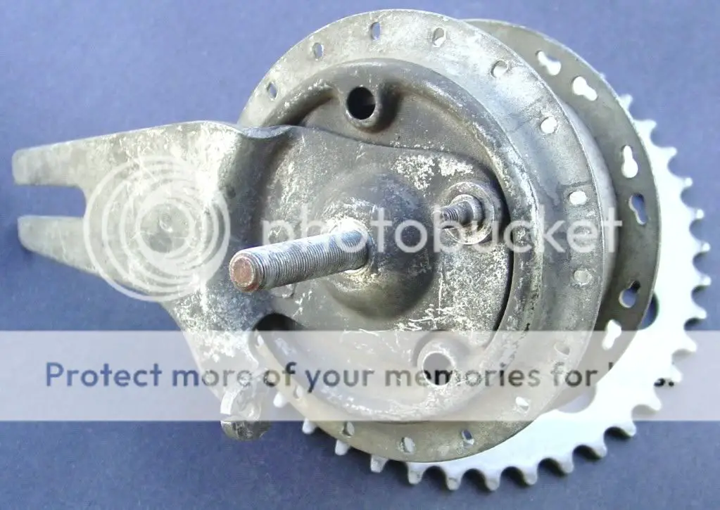

Hey silverbear. Sounds like a cool ride. Never seen a friction drive moped. Any photos? Here's another rear hub with bolt on sprocket, but it came off of a single chain moped and has no provision for pedal starting if used on a bicycle. Just showing what's out there.
