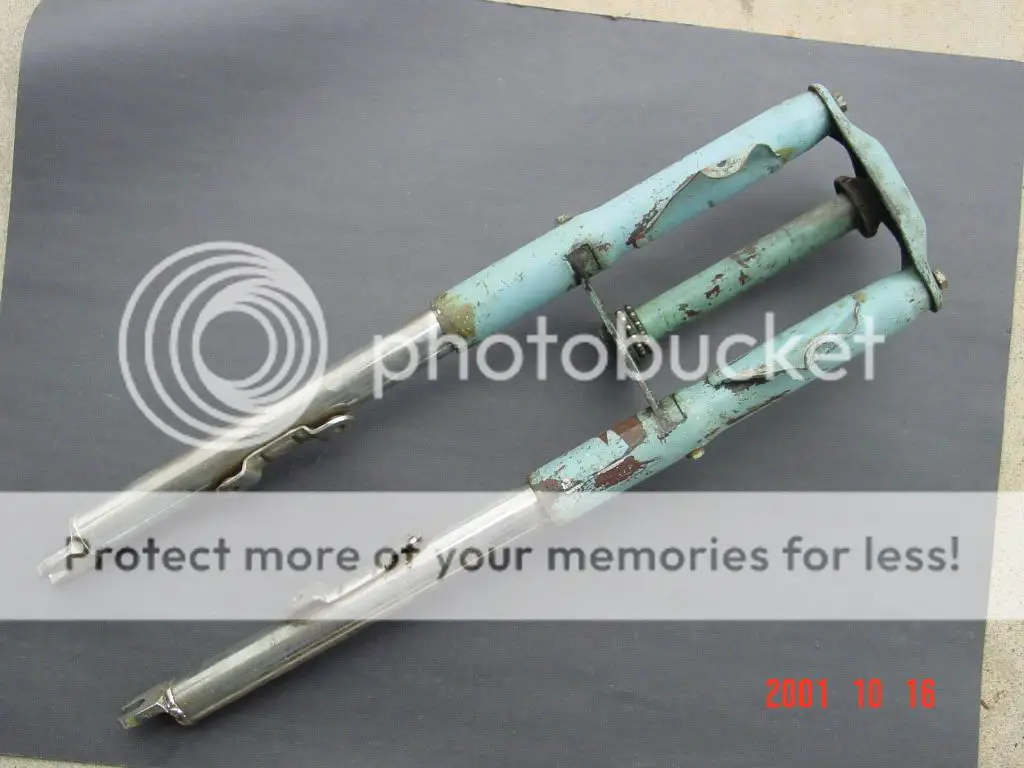

I only have one set left that's suitable for a bicycle frame. They're pretty heavy and clunky looking, but with a little trimming and paint they would look totally respectable. Let me know if your interested and I'll come up with a good deal for you. I also just got off ebay and there are a dozen or so moped forks on right now.

OH, $25 plus shipping would be good for me. It weighs almost ten pounds. If you want them, send me a private message with your address and I'll get a total for you. That way we won't clog up the forum with our deal.

I've been thinking about your build ever since I first saw it, zeroing in on the use of a moped front fork. I want to try it and am wondering if that is a Puch on this build. And are the wheels you used 26" or are they 24"? Do most of the moped forks have enough room for a 26" bicycle wheel? What kind of modifications do you need to do to make it fit a 50's era Schwinn? I've been asking around, posted a thread asking for information and coming up short. Any thoughts on this would be a great help.
