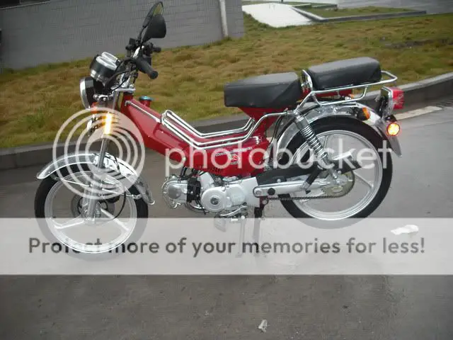

Here's the Chinese cloned version of a I'll call it the 2010 version PC-50, some dealers call it the SSR-Motorino Laser5 or just Motorino Moped it has a Honda cloned CRF style engine with built in pedals:

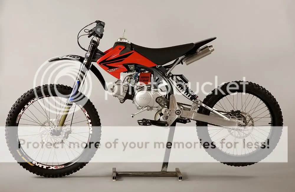

Here's the Motoped Extreme Mountain Bike Moped:

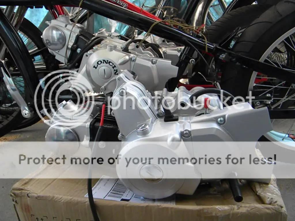

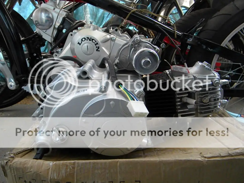

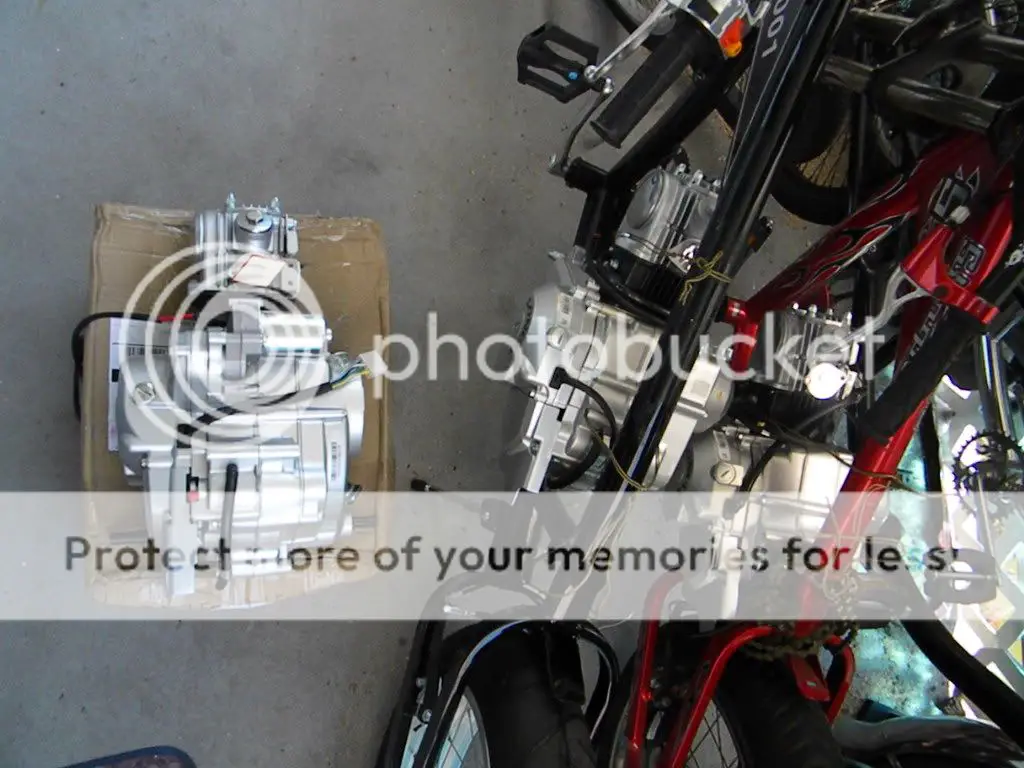

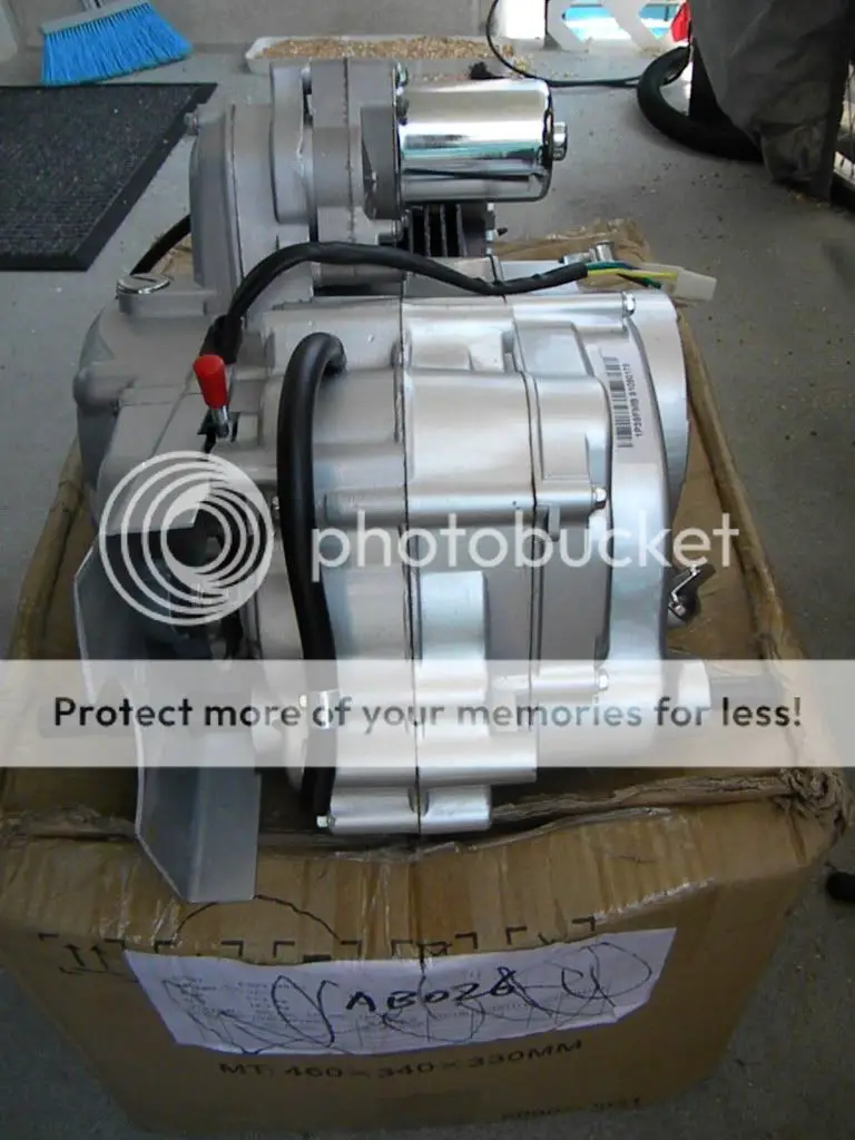

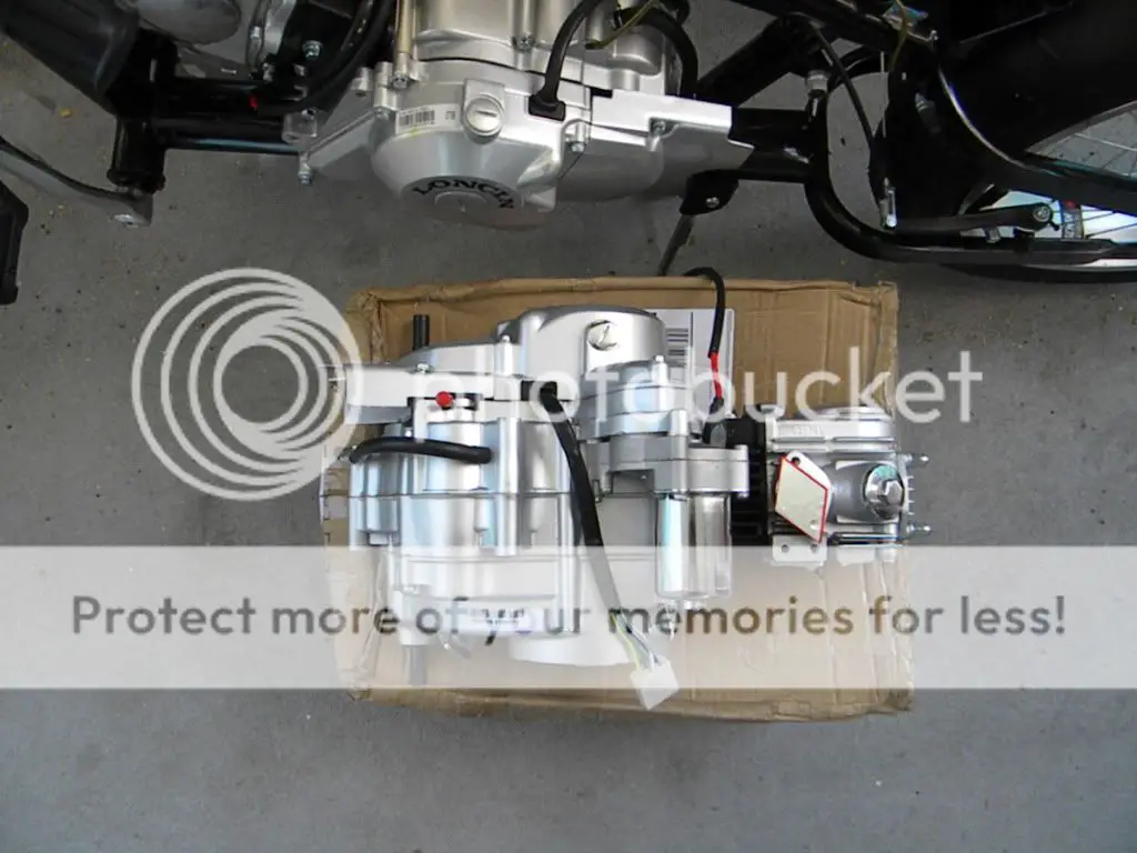

Joe..?? What's that little red handled lever, just above the final drive sprocket??
Cool Beans Me want one, Is this a single speed, as traditionally a moped is supposed to be?
Helmutt
SB, yes I'd like to come up for ColorFest in Thurmont, Maryland this fall and yes I should be able to bring one of my proto-type Stretch Cruisers powered with the Honda CRF 50 chinese cloned engine with built in pedal ie moped engine.
Helmutt, the lil red rubber tipped lever is where you switch the engine from human pedal power to engine power vice versa. The Honda CRF50 cloned engine is fully-automatic with electric start.
The lil red rubber tipped lever will disengage the engine drive train and only engage the final drive sprocket so you can pedal in bicycle mode if you wanna call it that.
You can also use the pedals to start the engine if your battery or starter dies on you!
Another nice feature is the parts for these engines are all over the internet just google Honda CRF 50 engine and these 50cc engines can be beefed up from the measly 50cc up to 192cc for off road riding/racing, of course while keeping a stamped 50cc cylinder for legal issues.

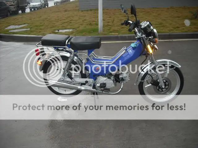

Here's the engine mounted on a Chinese Moped:
P.S. For those of you who have the resource's you could just purchase a brand new complete moped and scavenge the parts to build your own extreme motorized 4-stroke bicycle / moped!
Just something to think about!!!

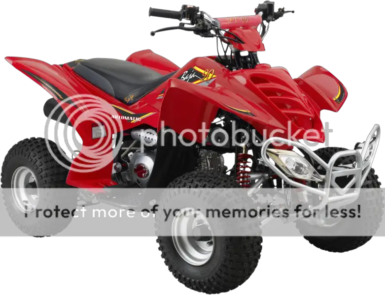

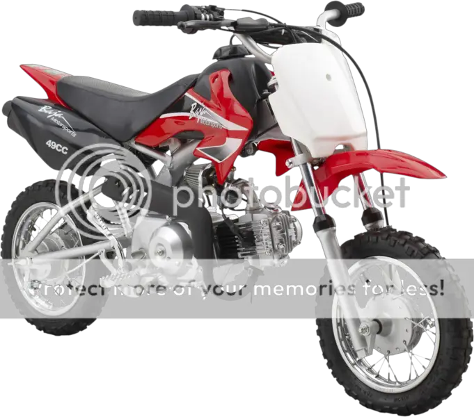

In the meantime might I suggest to those who are searching for this type of engine to purchase either a Baja 50cc Dirt Bike or Baja 50cc ATV available from your local PEP BOYS auto parts store. These two options offer give you a complete setup ready for transplant to your Stretch Cruiser or Chopper. Just weld in the skid plate / motor mount available from West Coast Mini Choppers, @
West Coast Mini Chopper Product Index
then mount your engine add a gas tank, run a chain idler under engine for the pedal chain clearance, etc etc...
These two options ( Baja 50cc Dirt Bike & Baja 50cc ATV ) will cost about $399.00 from PEP BOYS auto parts store. Note the Baja 50cc/90cc ATV comes with head lights and rear tail light. Or you can purchase the lighting kit for the Baja 50cc Dirt Bike separately from PCCMOTOR $69.00
Pitbike Headlight Kit Lights Light XR CRF50 50 RED LT07
I'd post a pic but 5 is the limit per post.
Here's pic's of the Pedal Engine, The Baja 50cc Dirt Bike & ATV, that you can scavenge for your build. Also note the pic of skid plate / motor mount that you'll have to weld to your bicycle!

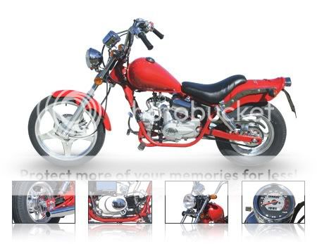

Or if you can find a supplier of the Honda 50cc Jazz clone you can swap everything speedometer, gas tank, lights, horn, turn signals, head & tail light, battery, complete wiring harness, and have you build done in no time.
Here's a pic of the Honda 50cc Jazz clone.
Here's a larger pic of the Chinese Cloned Honda Jazz 50cc.
