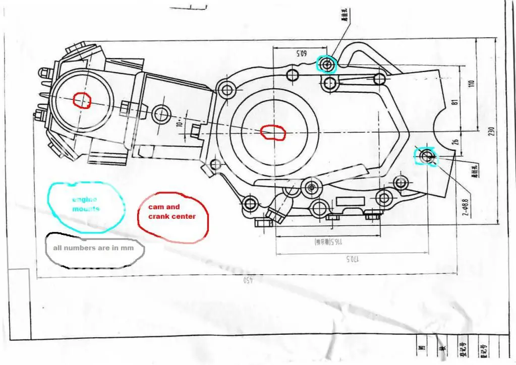

Hey anybody happen to know the dimensions of these clone 50cc engines as i am in middle of design phase of custom soft tail chopper and plan on using one of these with electic/kick start and cant find overall dimensions, if possible the one with uprigjt cylinder seperate heights for both gearbox and cylinder thanks. Great thread really useful
Did you request dimensions?
Length=450 millimeters = 17.7165354 inches.
Height=230 millimeters = 9.05511 inches. The height measurement does not include intake and carburetor.
C.H.
The above diagram is defo a good one, but it seems to be missing width - which for the auto clutches & automatics is usually 12" max (clutched manuals being a lil narrower).
