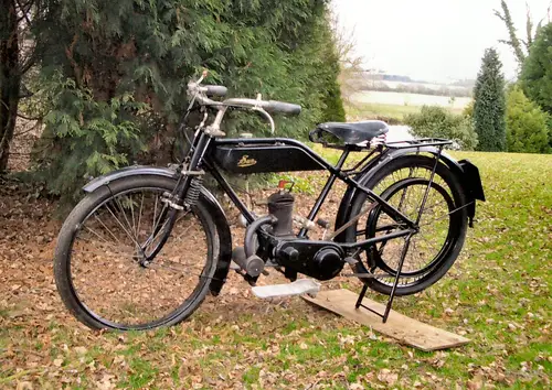

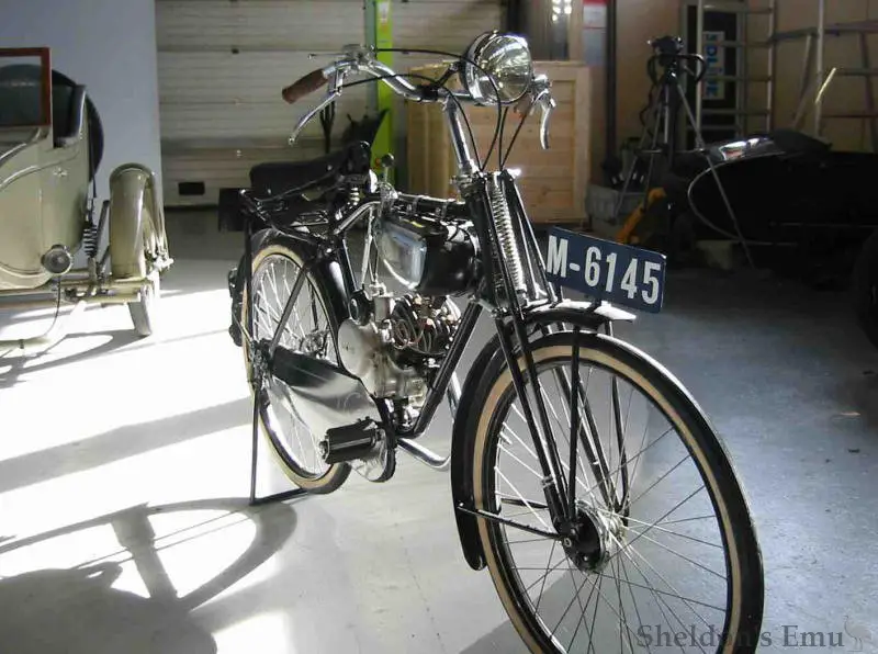

As always thanks for the positive feedback. Those are great examples of what I have in mind Ludwig. A 1923 Sun was listed for sale a couple years ago just a few hours drive from home. All original too. Broke my heart that I couldn't grab it! Lately it's been work getting in the way of garage time but there's a break in my near future and good weather too. I'll see what I can get done.
