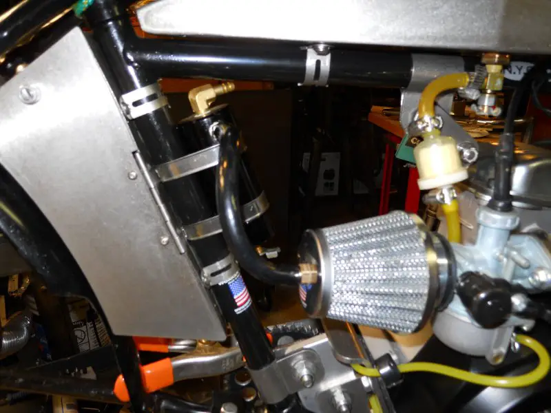

But I have had an epiphany of sorts. One thing I did before I gave the bike any run was route the catch can vent to the air cleaner. Post #357. Every thing begins to change the running characteristics when the engine comes to running temp.
Are the crank gasses effecting air/fuel to such a degree?
Before the hot rod engine was installed. #1 engine was pumping oil from the crank case vent. first to the ground and later to last years catch can. That minimized dumped oil. I have seen enough examples of crankcase vents directed to the intake to give it a go. I have also seen enough Kart engines at the stock angle with just a tiny sort of air cleaner to vent an engine.

Removed the PCV system from the catch can to the carb. Installed an unaltered air cleaner. Easy to reconnect.

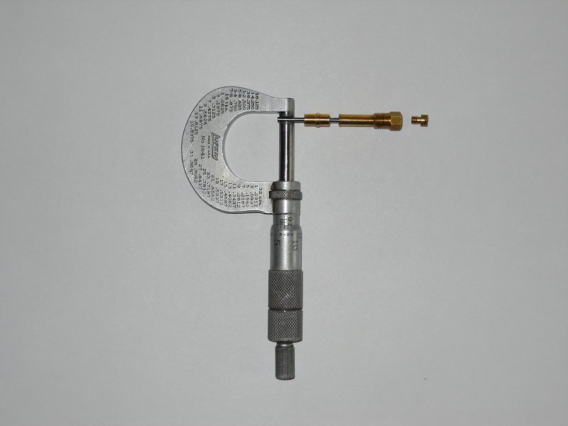

A photo is provided. The Pilot jet body is used to retain the Main jet securing the Main jet face flush to the slide pocket.
As the photo illustrates a .082" gage pin passes smoothly thru the Pilot and Main bores. So in fact both bores/ID's are .083"ID.
On the right side of the parts is the orfice through which all fuel can flow and it has a ID of .028" ID.
Slightly bigger than a gnat orfice. The gate keeper is a #70, after that the needle is flow control.
I have a #68 drill bit which = .031. Give it a go to open the gate keeper? I got another set of parts, and I can peen a gate closed if needed. I think the gnat orfice, is not only being a restriction it is causing flow turbulence. I am and never will be a carb guy. Help a Brother if you can.
