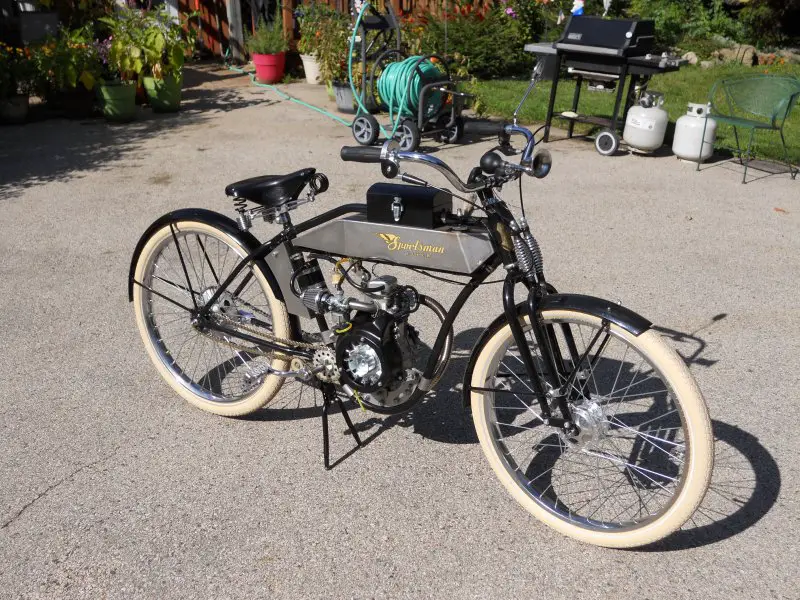

79cc Sportsman Flyer build
Another thing I did not do, with this high toned AGK fly wheel. Eschew the stock ignition 28 degree TDC timing key for an additional + four un keyed timing advance. I don't think that is it, power wise.
Stock Predator spec's 3hp. I went with a PZ19 which is huge breathing improvement compared to stock.
I am beginning to think these little engines cannot reach optimum torque to accelerate under load, or could it be that green foam filter I but in the high flow filter. Too many variables. I know. One at a time. But at 70. I ain't 50 anymore, nor do I have the strength of a fifty five year old.

New PZ19 carb. arrived. Plan was to just modify the main jet and install it in the bike mounted carb.
Into the shop and unmounted the float bowl and it sure didn't look like the Vids. Should have taken a photo.
Vid has one unscrew the Pilot Jet and then unscrew the Main Jet underneath which is numbered. Not this carb.
Big change!
Designed for ease of robot manufacture and assembly has arrived. In this carburetor, the Main Jet is turned straight on two ends with a symmetrically centered seating flange. It slip fits into the carburetor body and is retained by the Pilot Jet. Brilliant!
Only just dissected the new carb. today to get in my mind the scope of my next move. Pin gages to find out the existing
Jet orfice, and go from there. I really like this carb jetting design.
New Mains shouldn't cost more than a buck retail, and I can make my own in my shop. More tomorrow with pitchers.]

Before I reassembled the new PZ19 carb with just a dial caliper, I measured the ID of the main jet .084".
No need to bring out the pin gages, and no. I have not checked plug color.
Just for sh!ts and giggles I dropped the float bowl from carb #1 and the two carbs are twins. Same pilot/main assy..
Same main bore ID.. #2 needle in middle clip slot for a base line. I am hoping carb #2 behaves differently.

This model PZ19 main is a slip fit bushing and not stamped retained by the pilot jet. I did not give the pilot jet a hard look.
Just a reminder Norm, this is a 79cc Predy. Both mains I measured were .086" ID. Don't make sense, I know.
Pat replied to my email and said go counterintuitive and drop the needle to lean it out. Nothing to lose and much to gain.

Didn't catch this thread early on. I had two similar 79cc bikes in the shop, one hot rodded and one stock. The difference was so minor it was was hard to tell but the stock internal motor may have had an edge. The horse power is so low (how low is it?) that I felt the heavy valve springs I was running actually used up more horse power than it added. Extra drag.
I only run 12 ounces of oil in the 79cc and never had a problem. 12 is what the engine manual recommends. At 16 ounces you may be causing drag on the crank.
If you want more bottom end and are not worried about top end change the gearing. I had a 100cc race bike and the bigger rear sprocket I ran the faster the bike would go. This seems backwards but the little engine simply could not push through the gearing to reach higher rpm. Finally did some gearing changes and got that little motor to spin over 9000 rpm.
You mentioned running an aluminum flywheel. A quick test would be interesting. Throw on the cast iron flywheel and see if it makes a difference.
I have tuned so many carbs over the years but do not consider myself an expert. When a motor bogs at higher rpm I can convince myself it needs more fuel. I always find the opposite. Bigger jet makes the problem worse. Going to a smaller jet always improved the situation. This is of course assuming the carb is correct for the application and not to big or too small. Check plug color.
Finally, I will say that tuning a small engine to do big things can be very challenging. Even for a simple single cylinder push rod four stroke.

Gearing. Take your bike and point it down hill. See if it will push through your problem rpm zone and even reach full rpm. If it does, but can't push up a small hill you are geared too tall. My guess is your gearing is fine if you haven't changed it from before the carb swap. Have you tried your old carb with the new engine mods? If the problems go away its the new carb. If the problems remain, its something else.
Hey Tom, I did a lot of jet and pilot swapping in the past. It is very time consuming and can give great results. I didn’t enjoy this part of the build it peed me off. So my new mission was to find the best out of the box carb.I found what has worked for me and a few others with built Up Or non built up motor.………….https://www.vmcchineseparts.com/products/chinese-pz25-carburetor-hand-choke-version-11 They ship super fast too.
Thanks for the reply Pat,
My gearing is stock from the Bully clutch to the 44T drive sprocket mounted to the sprocket adapter. I have enough speed on the flat and moderate down slope.
“You mentioned running an aluminum flywheel. A quick test would be interesting. Throw on the cast iron flywheel and see if it makes a difference. I weighed the billet ACR flywheel and the stock iron one. Three pounds even for both. If there is any difference it is the strength of billet magneto magnets which are much stronger.
“I have tuned so many carbs over the years but do not consider myself an expert. When a motor bogs at higher rpm I can convince myself it needs more fuel. I always find the opposite. Bigger jet makes the problem worse. Going to a smaller jet always improved the situation. This is of course assuming the carb is correct for the application and not to big or too small. Check plug color.”
Wednesday I pulled the spark plug and it was sooted up. Stock spark plug gap was .020! Now opened to .032. I am sure the short spark is part of my problem. I also set the C clip in the leanest needle slot.
“Have you tried your old carb with the new engine mods? If the problems go away its the new carb. If the problems remain, its something else.” The old carb is what I started with, clip in middle notch and the would not take a load, which is when I set the needle to it’s richest setting and performance was slightly better. I’m thinking the root cause of lack of power was the short spark. I’ll find out today.
